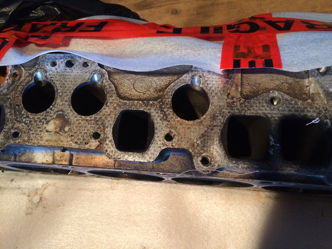

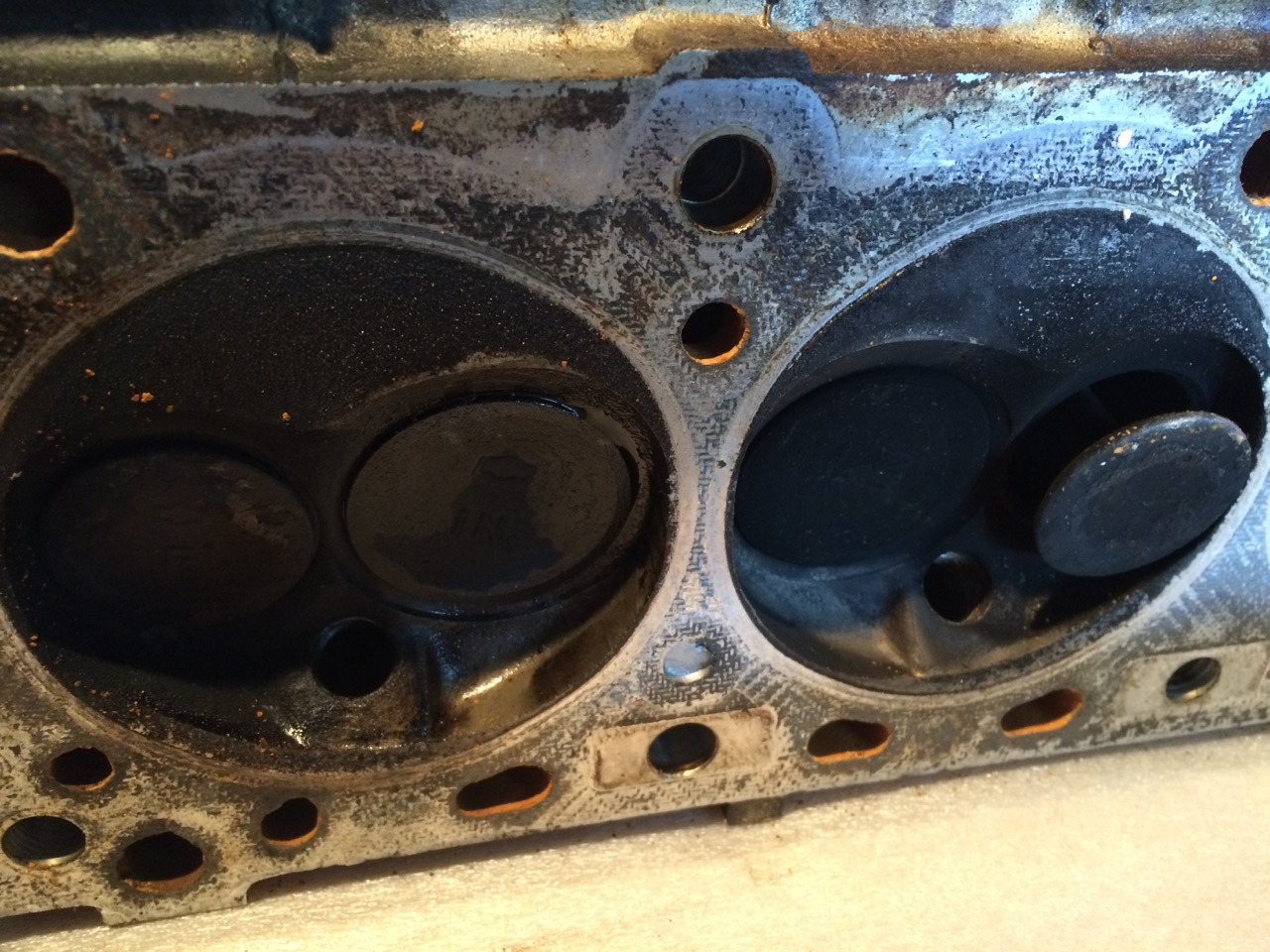

Bonkers Posted January 22, 2015 Posted January 22, 2015 I believe it came of a 2L series 6. I had a 79 fairlady with a 2000cc 6. But it had a Y70 head on it and it looks very close to that. So my guess it is from a 2 litre engine and someone removed the runners from the exhaust .Started some porting but compared to a N42 you will be there for a while with the die grinder. Quote
