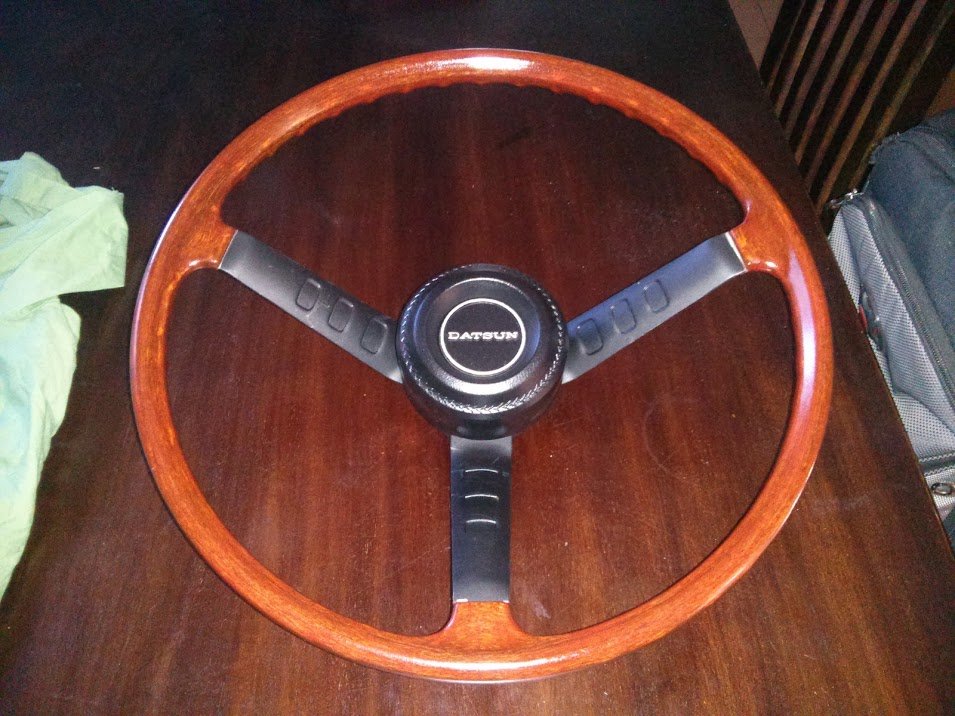

After second coating of minwax stain, you can see it has a nice gloss. When I got home last night I rubbed it down lightly with 000 grade steel wool. Which took a bit of the sheen off it, but then as you can see it has got that gloss back (even nicer) after the second coating.
This photo was taken in the morning after it's been drying over night.
Next step is to do the Polyurethane, but I'm wondering should I hit it with 000 steel wool again before spraying it? Or should I hit it with the Polyurethane then use steel wool before the second coat of Polyurethane spray?
I plan to do about 3 coats of the Poly.
So far really happy with the way the wood grain is looking and the wheel is turning out. I'll be doing the gear knob next.

Hey George, I did 2 coats of the polyurethane and now instructions say wait minimum of 72 hours before another coat. So I'm gonna so light steel wool then final spray tomorrow night.
Just doing the gear knob now also.
As for the stain I saw a couple of wheels in those threads where they didn't use it and it looked too dull to me. I like the cherry red colour. I guess it is personal preference and depends if you like the colour of the wheel as it is.
Looks great Gav. IIRC cabinet makers sand after each coat of clear varnish, sanding between every coat of stain or varnish can't do any harm I wouldn't think.
Yeah that's what I'm doing mate, a light sand between each coat of stain and clear polyurethane.

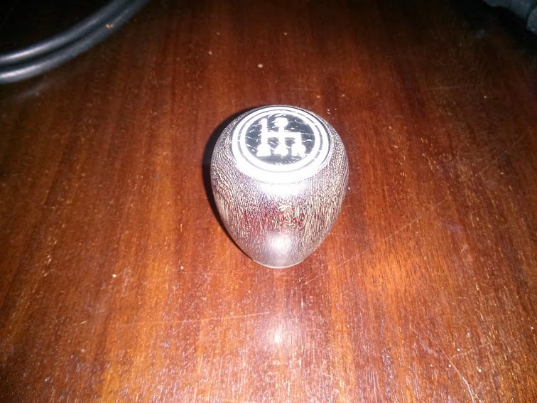

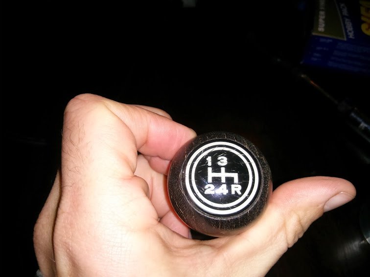

Gear knob before.

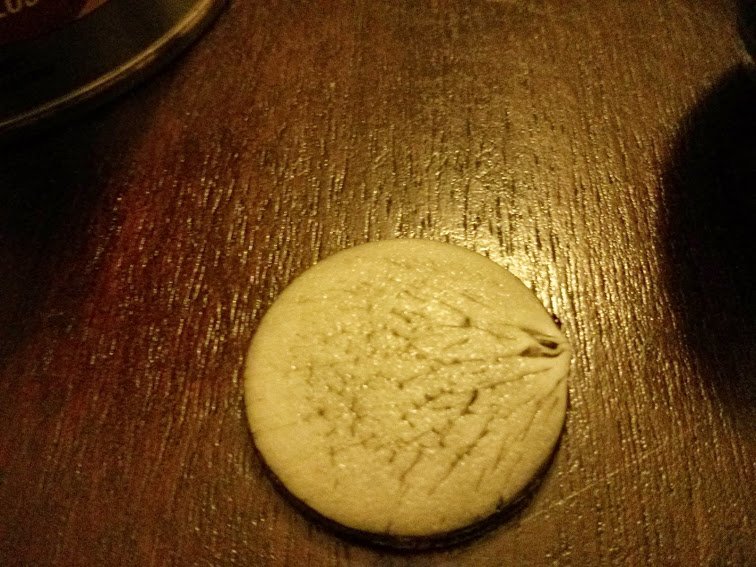

Step 1. Remove the old button.
There is probably a better way, but I used a heat gun and it actually ruined the button, which although it was in bad shape anyway I kinda wanted to save.
This is what heat does to the button.
Compare the colour of the knob with the steering wheel.
First coat of stain
Will sand when dry and apply the second stain coat, then it's onto the polyurethane like the wheel. Should make a nice matching pair, and I have a 5 speed button to go on it.

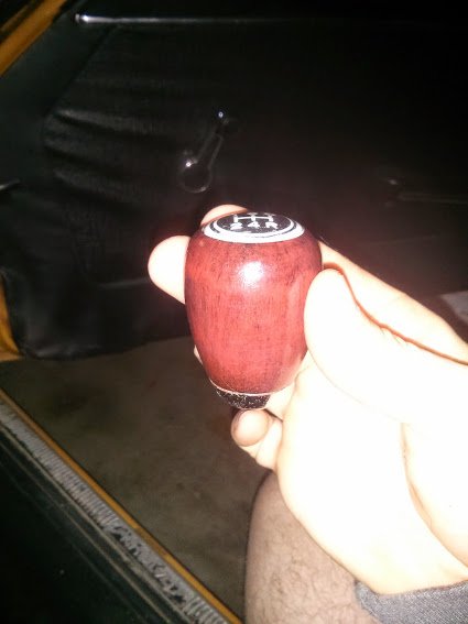

So I finished the gear knob finally.
The good angle showing the good bit of Chrome at the bottom :)
I found that I couldn't get the polyurethane not to leave a splotchy look, after many tries I found the best method for the best finish is to use fine 000 steel wool between coats then lightly spray a mist (very light), wait 2 hours and spray another thin mist and let it dry. Then steel wool (repeat). This seems to have given it the best glossy look.
Next to attach the 5 speed button. I bought a glue gun from Office Works for like $10 or so.
When attaching the button make sure the gear knob is done up tight on the shifter. Then glue the button down facing the right direction.
If the thread on the gear knob is worn out, you can simply use an epoxy type glue in the thread, then drill a slightly smaller diameter hole and then thread it onto the gear shift lever which will thread it again for you. Thankfully mine wasn't clapped out and still has good internal thread.
Thanks Peter, last photo I'll post in here :)
Funny how even though I stained both with the same colour both the wheel and gear knob look different. I guess the gear knob was a bit darker looking underneath to start with. The difference in the car is less obvious (flash makes it look like that!).
