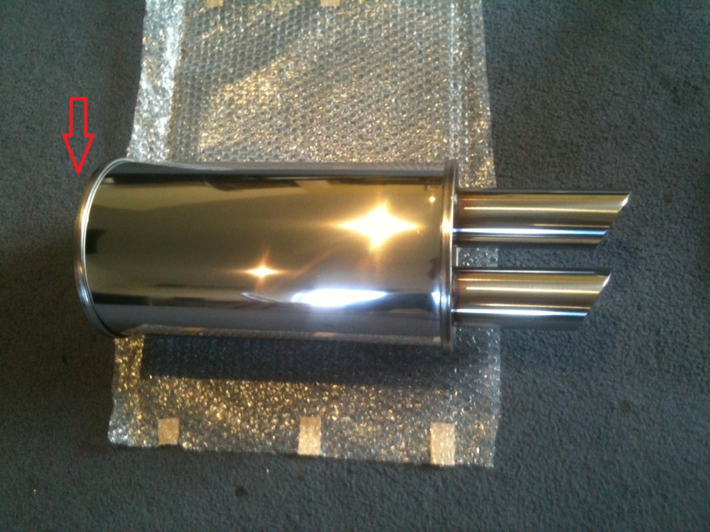

Riceburner Posted February 2, 2014 Posted February 2, 2014 I'd like to try and change the sound of my exhaust a little, some more 'rasp n crackle' would be nice but nothing too silly. I have 6-2 headers with twin 60mm secondaries, then into a 3" full mandrel system with a 14'' resonator that is 3" straight through with a 5"body (pic1) under the gearbox, I then have the Reinhard twin 60mm stainless muffler in the rear (pic2). The centre resonator is straight through and has a double chamber with an open section in the middle. I was thinking maybe a long hot dog in the centre in the centre might be the way to go, something around 20-24" long? Obviously it needs to be legal and not too loud for the track, currently I feel mine is pretty quiet compared to some, but it's hard to tell with a helmet on Here's a rough video with the current system, it was done with my old 74degree cam in. Quote

Riceburner Posted February 3, 2014 Author Posted February 3, 2014 Here's that RS Start/Power craft video. Crazy sounds, but obviously not allowed on the road here! Lol. Dimitri, Regarding hotdogs, i follow what you mean. I've never had one fitted to any of my vehicles so I'm not sure of the sound attenuation they provide. Here's my thinking, the current resonator is 3" straight through and has a 5" body O.D. So that's 2" of sound deadening. The hot dog is 3" straight through and 4" body O.D. Giving a 1" of sound deadening. So if I got a long hot dog at double the current resonator length I should get a very similar sound to the current setup as the amount of sound deadening should be the same. A shorter one at say 18-20" long should give a slightly more sporty note? Quote
