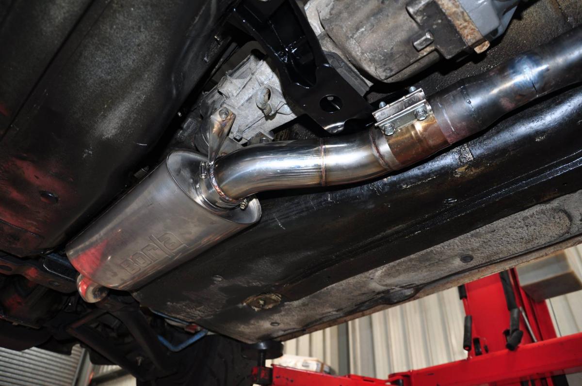

I run stainless headers 6-2 42.7mm primaries twin 60mm secondaries, full 3" mandrel system, magnaflow 5" round 14" long stainless centre resonator and a reinhard twin 60mm stainless rear muffler. All mufflers are full stainless with stainless steel wool fill and perforated stainless steel cores.
It was good on the old engine, not to loud at all. Could the bump in compression from 9.3:1 up to 10.5:1 and displacement increase from almost 2.9 to 3.1 mean a lot more noise?
I was really happy with the way the 5" round magnaflow centre muffler made the old engine sound. Is it possible to fit an oval muffler in the centre, say 14Lx9Wx4D under the rear gearbox area and will that solve the noise issue?
What Length was the old 5" OD Magnaflow in the centre? A 12" or 14" Magnaflow in the centre may reduce it somewhat more, but I suspect that rear muffler of your's is the culprit.
I build the 3" LCR systems with 14" long rear muffler & a 12" long, 5" centre round. They have a nice burble without being loud.
Just think about your noise requirements at P.I....
Lurchos, I just took some measurements. The centre magnaflow is 14" long, 5" round, straight 3" in/out. The JDM style rear is 14" long, 7.8"(200mm) long, twin 60mm straight in/out, 5" long angled tips.
