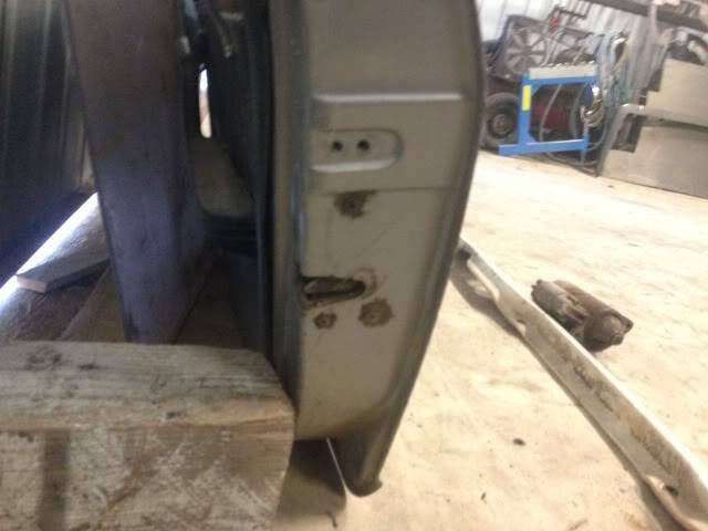

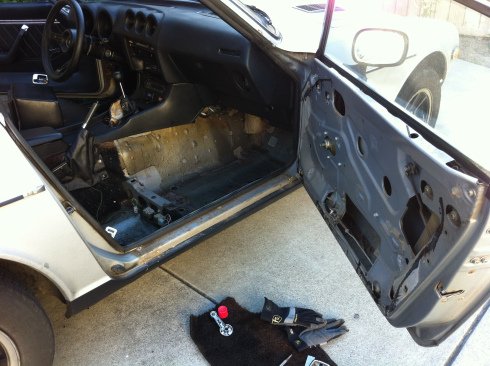

Six_Shooter Posted December 25, 2013 Posted December 25, 2013 Why wouldn't you just put the old door on once you realized there was a difference, instead of cutting the door jam? :confused: Also there is definitely a difference between early and late S30s, when it comes to the latch/striker mechanism. 240Z/early 280/60Z: Late 280/60Z, if you look closely at the latch area of the door you can see that it uses a different latch type than the earlier S30: Quote
zzzzed Posted December 25, 2013 Posted December 25, 2013 The doors I have are like the lbottom pic. I need the ones in the top pic Quote
