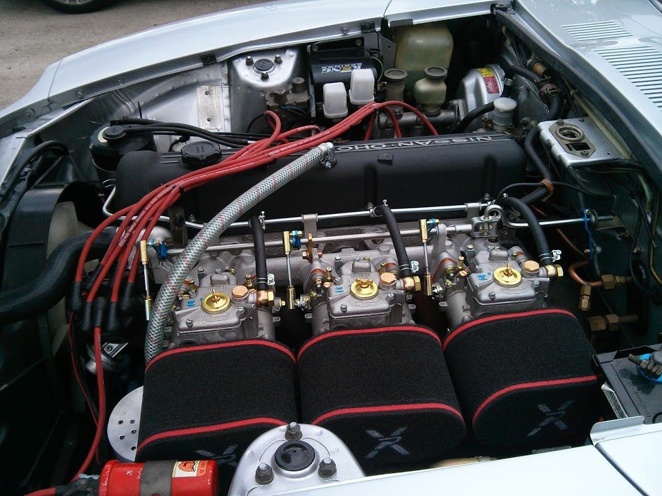

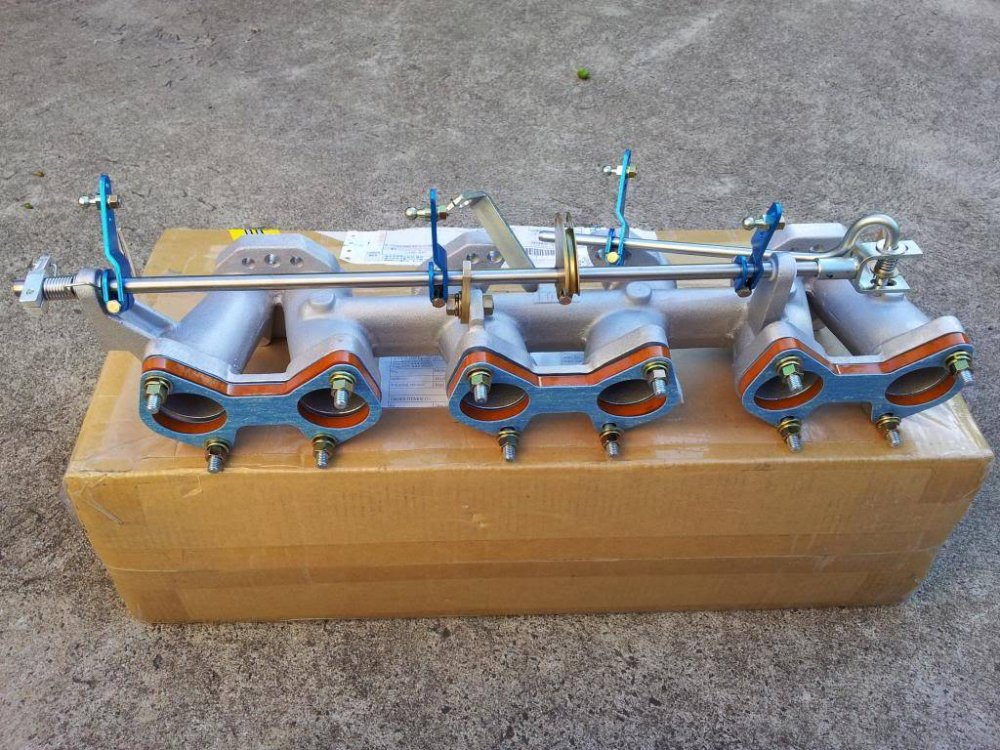

sydney mike Posted July 31, 2014 Posted July 31, 2014 I went for the Kameari intake kit: http://www.rhdjapan.com/kameari-intake-manifold-kit-l-type-l6-42mm.html and the three new 45 dcoe webers from weber performance melbourne: http://www.weberperformance.com.au/product_info.php?cPath=1_9&products_id=1 The kameari kit contains the bakelite spacers that alot of people recommend over soft mounts. I was wary of reading alot of people having problems (even for years!) of trying to get the 2nd hand set of triples they picked up for a bargain, then ended up spending more than what it would cost new to get them sorted and tuned. I did want to go Japanese with mikuni/OER but chose the webers for local technical support/parts availability. And they sound just as good , could not be happier. PS if you want OER: http://www.rhdjapan.com/oer-racing-carburetor-kit-45mm-wire-type-l-series.html Quote
Cozza Posted July 31, 2014 Posted July 31, 2014 I was wary of reading alot of people having problems (even for years!) of trying to get the 2nd hand set of triples they picked up for a bargain, then ended up spending more than what it would cost new to get them sorted and tuned. Yep unfortunately I agree with Mikes comment, got a cheap and spent more in the long run sorting out the issues. Another option you might look at is the pierce manifolds. http://www.piercemanifolds.com/ProductDetails.asp?ProductCode=K659 Good luck Mick Quote

sydney mike Posted August 1, 2014 Posted August 1, 2014 I've never purchases from RHDjapan before but what would something like that cost to ship to Aus? & @ Gav, RHD are very easy to deal with and the prices seem ok but I must warn you that their displayed exchange rate and paypal's exchange rate are planets apart. The shipping for the intake kit and fuel rail IIRC was around $110 and less than a week. Here's another pic: Quote
