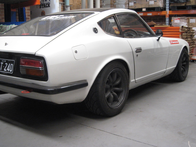

Administrators gav240z Posted May 31, 2010 Administrators Posted May 31, 2010 I just came across these images and for me, I think I'm happy not to Flare my Z yet if I can get it to look like this: Anyone care to guess what size they are? Quote
NZeder Posted June 1, 2010 Posted June 1, 2010 Given they are the R type they are only available in the following sizing (given tyres are 16" - will only post 16" sizing) 16 x 8 0 Offset 16 x 8.5 -6 Offset 16 x 9 -13 Offset 16 x 9.5 -19 Offset Now given I have 16 x 8.5 -6 and have test fitted these to the front of a stock S31 (here is a pic) rubber is 225/50/16 on my rim. Look at this pic and the pics posted above to see if you can work out the rim sizing. FYI that blue zed has the same RIM front and rear but different tyre sizing [Click to see larger pic] Here is pics of the wheel when I got the rubber installed - the one is the back is the front setup ie 16 x 8.5 -6 with 225/50/16 you can see the size of the second lip just before the spokes - compare this to the lip size in the blue car above - this leads me to believe they are 16x8.5 on that blue car - you will see the front and rear lips on the blue car has also been rolled. So does that help? Quote

zedevan Posted June 1, 2010 Posted June 1, 2010 Awesome find Gav, looks awesome. I'm not sure if I'd still flare my car if I hadn't already - the stock lines really are nice. My thoughts were if I wanted to go back I'd be happy enough with guards like the awesome 20b featured car has Quote
