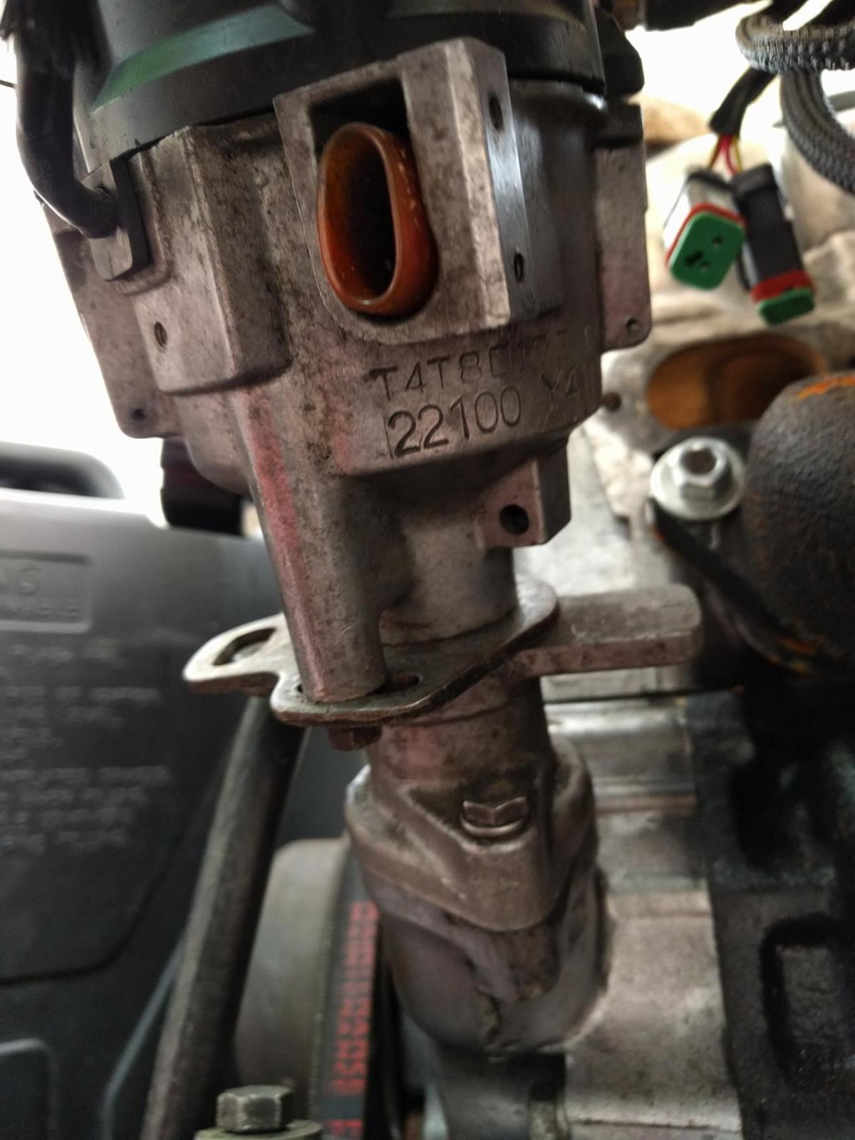

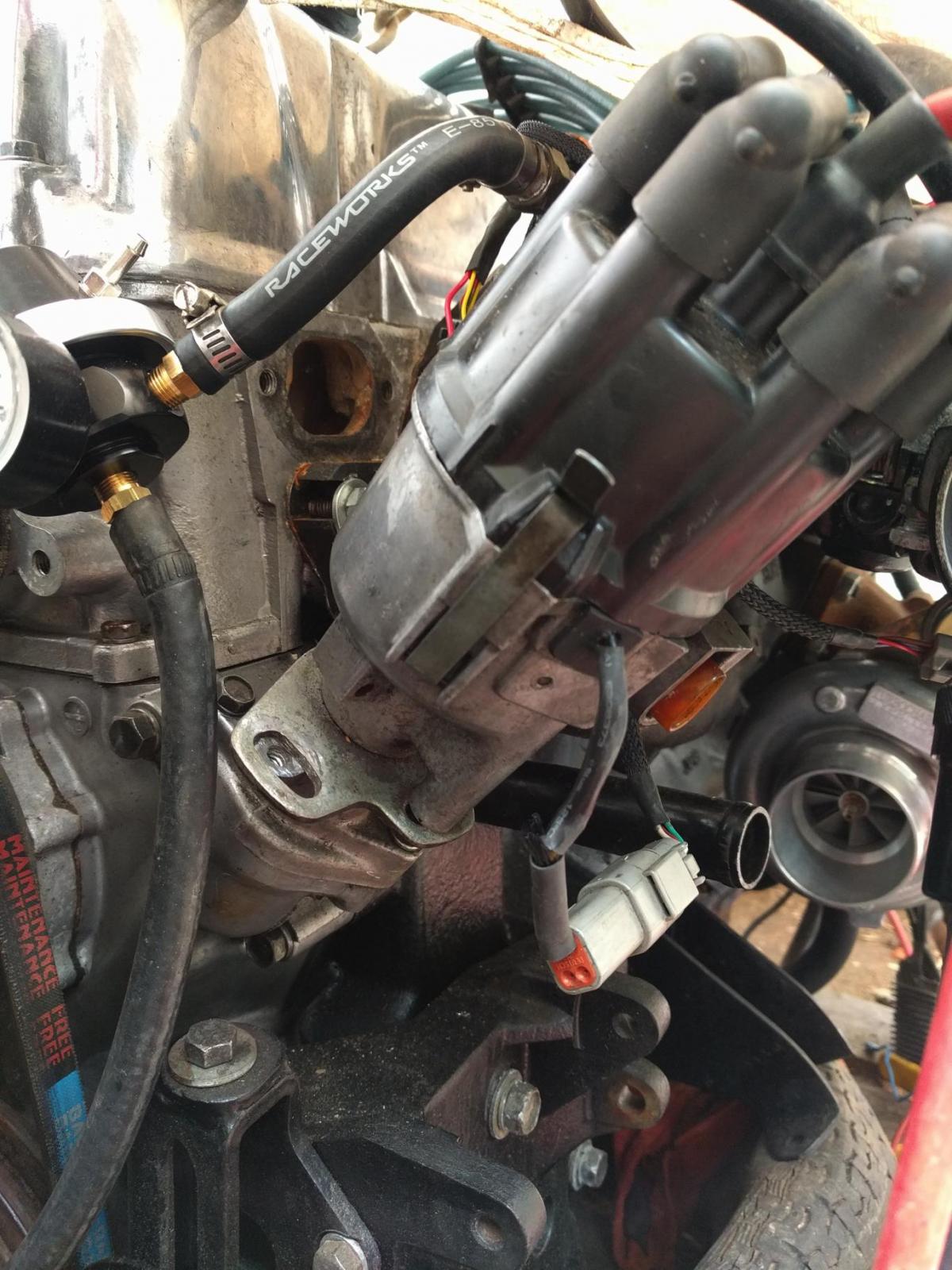

Hi Roady, I'm fitting it for the first time and I haven't been able to find where 0 degrees is as the base plate has been re-drilled to enable this distributor to mount. (I have ordered a timing light but it hasn't arrived) The mechanical advance has been disabled on it and the timing is controlled through the custom ECU. I'm also unsure if the positioning of the hall effect sensor inside the unit is correct as it is able to be moved around since the mechanical advance was removed. The model of this one is: T4T80172 C4 22100 Y4111 Here is a photo of the Mitsubishi distributor with the adjustment plate and base that it came with (the hole on the right has been re-drilled to allow it to mount to the base. This is the base and adjustment plate that was fitted to the motor originally with a d609-56a distributor As you can see the two bases are the same whereas the adjustment plates are different. I reckon that the person originally using this distributor didn't get the base with it so they used a standard l26 base. I also believe that to get it to mount correctly and have the timing set properly they would have had the oil pump shaft turned in a different orientation than normal. Not sure though? Andrew -

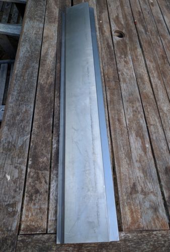

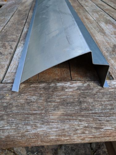

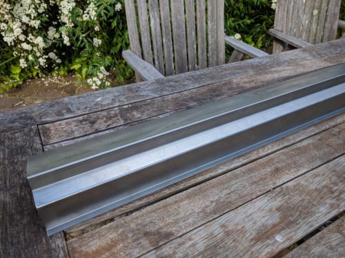

Hi all, I'm now also selling sill sections for both the 2+2's and 2 seaters. The fitment on these sections is far far closer than the rare spares sections and they can be customised to suit your length requirement. Price is $170 each + a $2.50 donation to the forum + P&H (pickup is available form Silvan, Victoria) As with any rust repair section, minor adjustments may be required to fit your car. NOTE: These repair sections are made to order and may have a waiting period of up to two weeks. eBay listing: https://www.ebay.com.au/itm/263274720441?ssPageName=STRK:MESELX:IT&_trksid=p3984.m1558.l2649 Andrew
