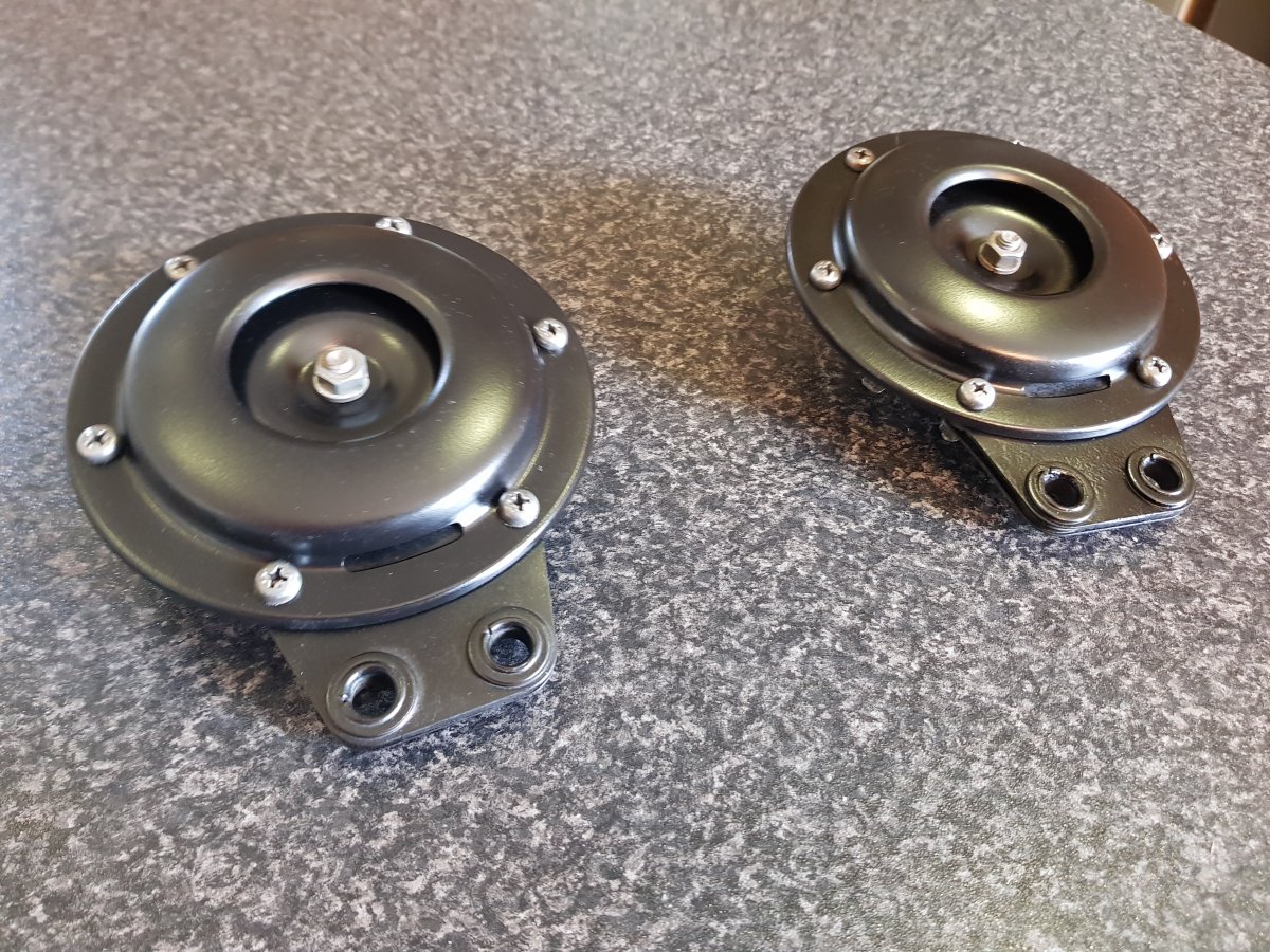

  1. Fitted and tested! They sound good as new ones! Couldn't upload a video here so posted on Facebook.. See here.... https://m.facebook.com/groups/740335446098903?view=permalink&id=1472531162879324

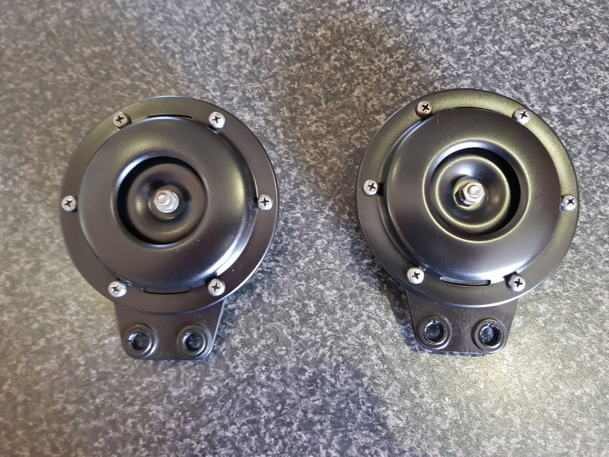

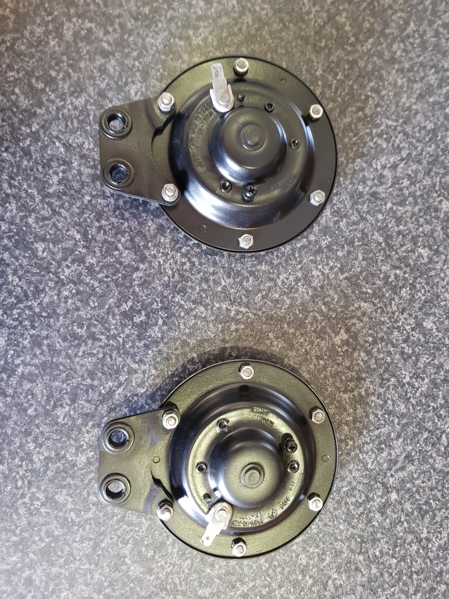

  2. Haven't mounted both of them on the car yet for a test run, only bench test individually, hopefully this weekend I'll fit them.

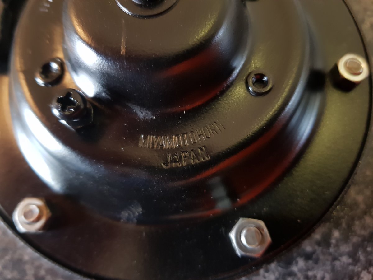

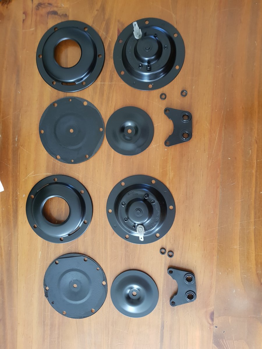

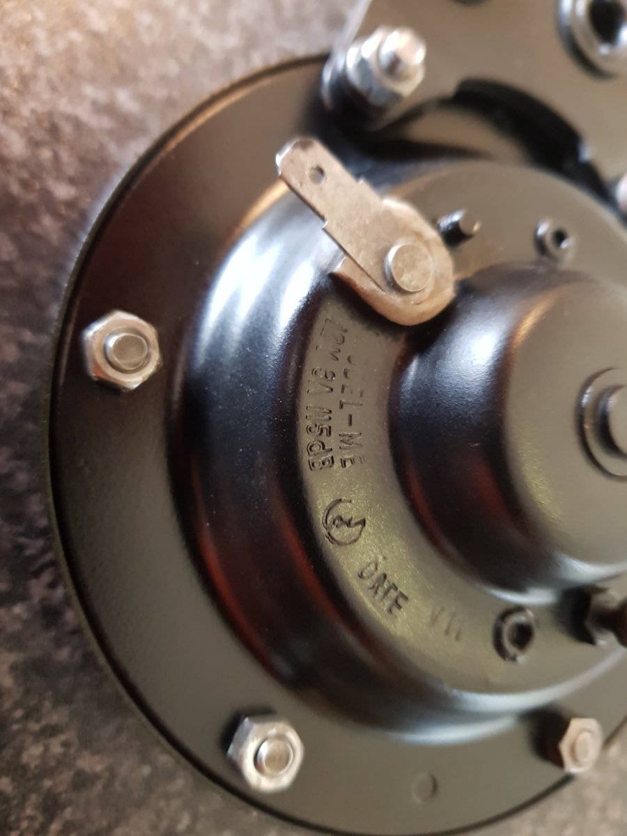

  3. And now painted and reassembled.. I'll probably get the screws / nuts replated as some stage but for now just clear coated. I paid US$5 for these buy it now on ebay! Freight was a bit expensive probably US$35.. Bit of a gamble but has paid off.

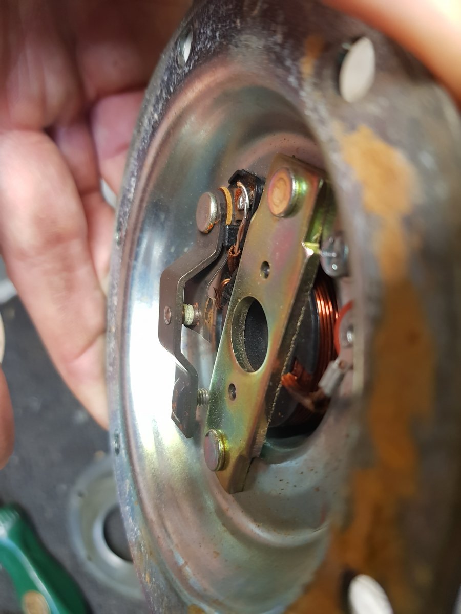

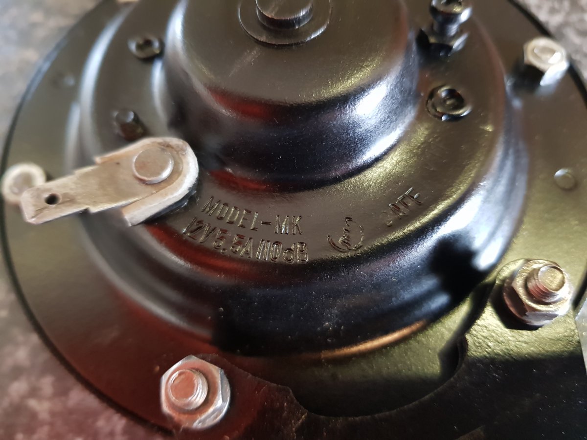

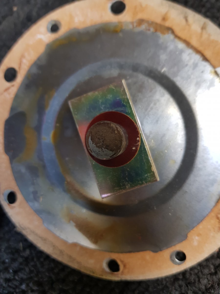

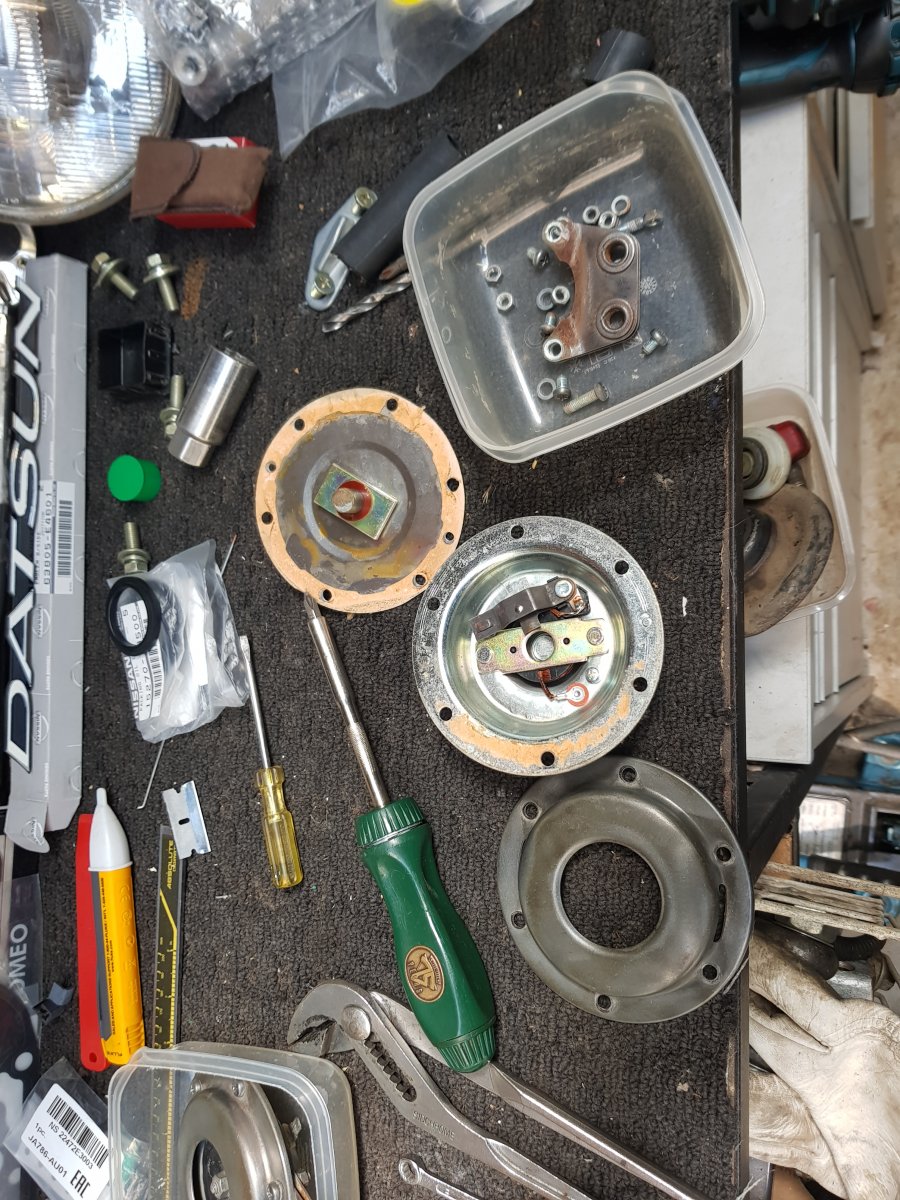

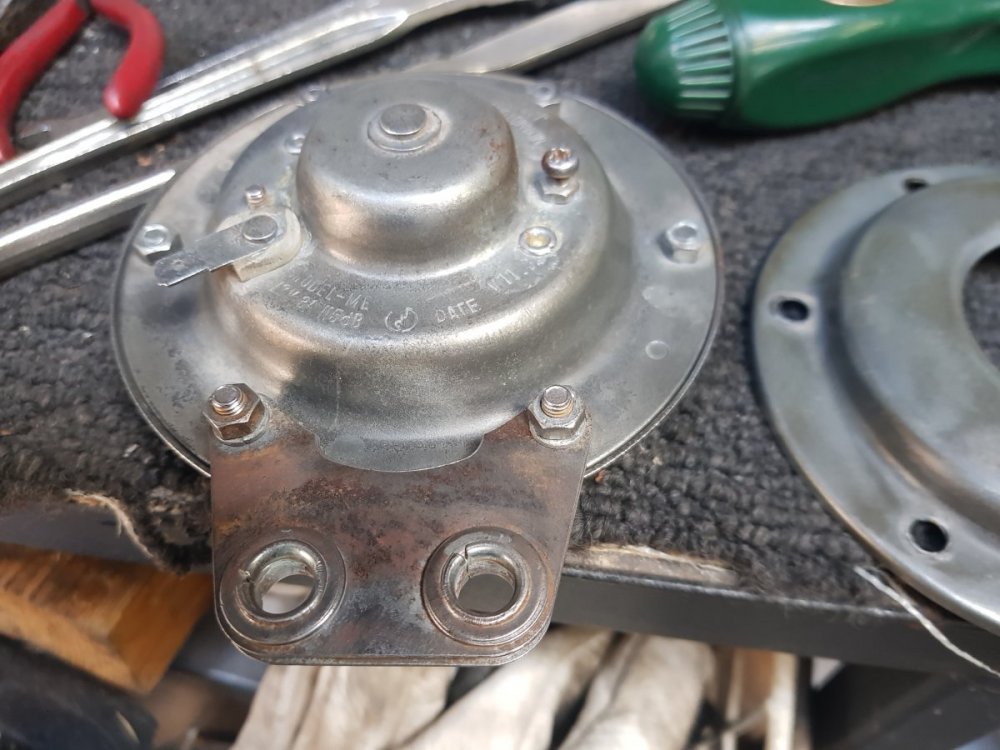

  4. And here is a couple of pics. I've cleaned the points gap with emery and the centre cylinder that sits inside the coil, and the base inside the coil. Hooked up a steady 5 amp power supply and adjusted the adjustment screw on the back to get everything moving again
  5. Hah! Just got the first one working! Hot tip.... Use a good power source, not a couple of wires held to a car battery!

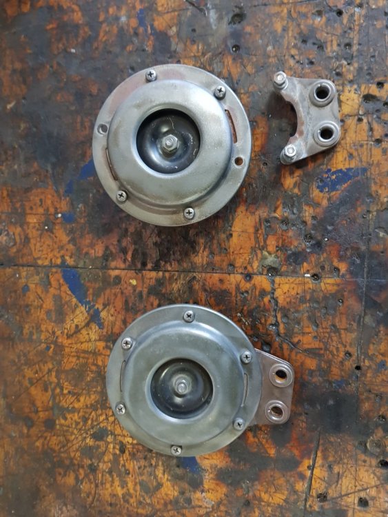

  6. Hi all, Just wondering if anyone has repaired a 240z horn before? I have a pair that appeared dead.. I have cleaned up some contacts inside one and now getting some good solid clunky movement but not the oscillating vibration that will produce the sound. I have run out of time today to keep going but wondering if anyone has been here before and has any tips? Thanks
