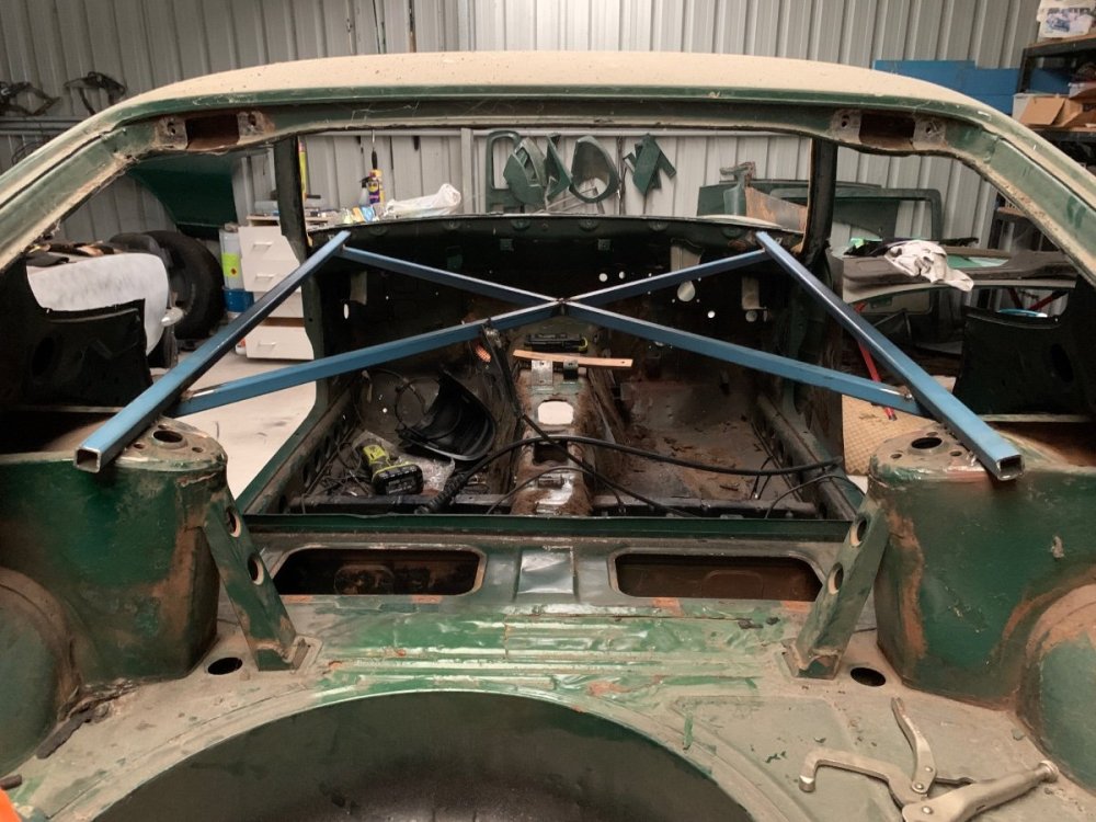

Meeting with the blaster went well, he can take care of the undercoating for me. I just have to remove the sound proofing from the trans tunnel and rear cargo space. he only blasts cars and is a huge car enthusiast himself so this pleases me. He’s booked out till march which is a bummer…. But has mentioned if I get the car ready to go if someone else isn’t ready he can slot me in early. So now I have to get the car ready to go. She’s waited long enough….if I wait any longer there won’t be a car left to restore…. I want to remove the rear quarter panels, remaining rear valance and roof skin and a portion of the outer rockers so the internals can be blasted. So first I’m going to add some bracing so that A) movement is restricted as I remove body panels and B) when the car is lifted up for the underbody to be blasted there’s a bit more structural rigidity to prevent any bending of the chassis. This thing is rusty AF and I just don’t trust it. I’m probably being over cautious. First I decided to ditch the gasless wire and start learning with gas. I wanted to practice on 1mm first and then practice welding my 25x25x3mm shs bracing onto 1mm sheet. Was very happy with the results for my first time. Turns out watching all those YouTube videos may have helped… first tacks My unimig for some reason has no setting guide for 0.6mm solid wire so I had to guess the settings. I ended up finding 14 volts and 4.5 m/min worked well. Does this seem about right? And can anyone tell me what the brown discoloration is? all stitched up rear of the join, seem to be getting penetration, does this look right? and after some dressing. I got warpage as I wasn’t trying to manage heat, but not too bad for a first go me thinks… Next welding 25x25x 3mm thick shs to 1mm sheet. no blow throughs, great success… I felt ready to weld in some bracing. Decided to go from the rear strut towers to the dash. the welds weren’t pretty, they were awkward spots though, didn’t want to do full welds as I wasn’t confident I could remove the bracing later without damaging something so I went with decent sized tacks. Seems to be enough strength in the tacks as the bracing feels solid. any feed back and thoughts on what I’ve done are welcomed. I really have no clue what I’m doing lol I’m planning to tie in the roof to the bracing and I think that should be enough? -
