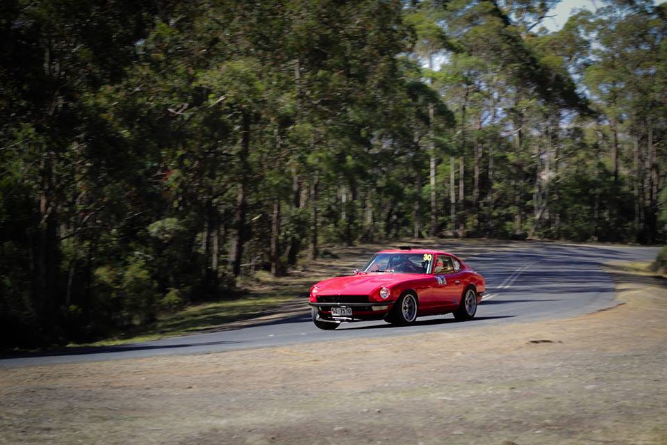

  7. A few 'Pro shot's' from the Poatina mountain hillclimb a couple of weekends ago. Gotta say it is a magic road! 7.4 km, from wide open in 5th to 7 tight hairpins and everything in between. I'm still grinning like an idiot!!! The Bride sat in the silly seat and loved it...can't talk her into selling a horse yet.

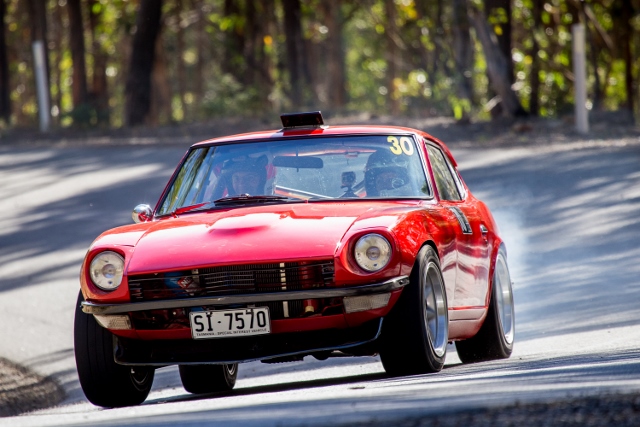

  8. Hey Guy's a bit of in car from yesterdays first round of our 'Black tack' series, I blew the gearbox next run...so it's a mad rush to get another box in before next weekend's Poatina Hillclimb. We did a few front end changes over the break and it steers a lot better, adjustable rear arms and an alignment are next on the list. Still no Dyno time yet, but Leeroy is doing another tune with the logged Lambda data. It's still a very safe tune, a bit rich and we haven't cranked any timing into it yet, rev limiter is still on 7000. Plenty more to come! Cheers Hodgo LOL I really should of edited that last bit out....

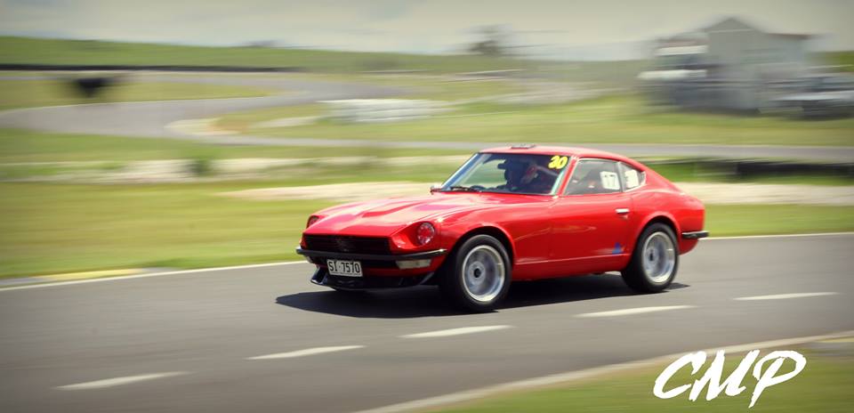

  19. Some photos from yday's Kart track sprint.
