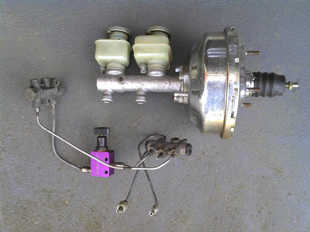

  11. Some more bits for sale, all are in good condition. Everything in picture for $75. P.M. me if interested. cheers, Sinisha

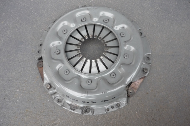

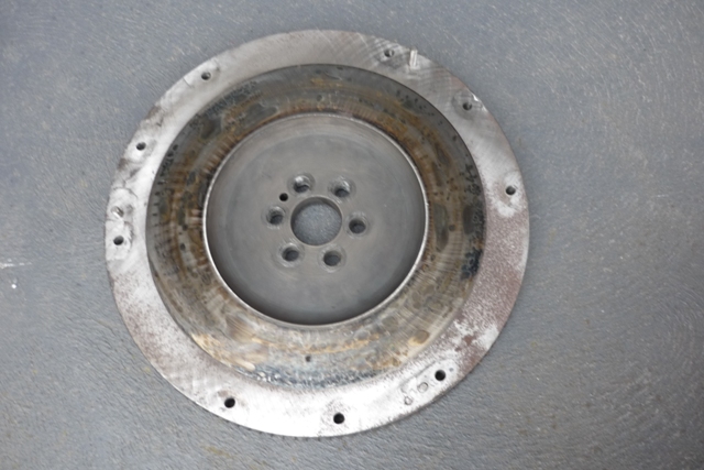

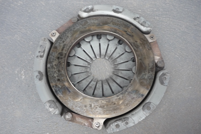

  12. The clutch suits a R32 GTR (push type), 2800 pound clamping force, was not slippping when I took it out, at the time engine had 320rwkW, the flywheel was supplied by Nizpro it is steel standard weight. $100 the lot.

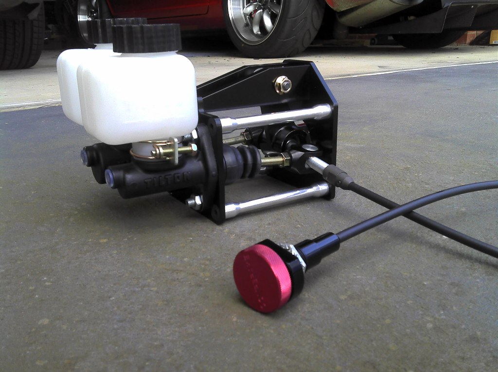

  13. I'm in, will be trying out my new in cabin adjustable dual master cylinder brake setup.

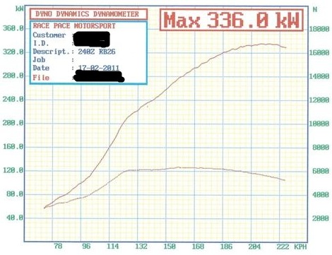

  15. Here's my RB26 built by the guys at Racepace Motorsport, Garrett -7 turbos, standard cams with adjustable cam gears, Autronic ECU and CDI running 18psi boost on 98 octane fuel with more to come if I choose to chase it. Gearing on chart is 30Kph/1000rpm so run stopped at 7500rpm. Engine built for circuit racing, super response broad flat torque curve. cheers, Sinisha

  18. OK, some info, quality of parts is very good, normally the kit is supplied with Girling master cylinders but I did some preliminary measurements and thought that things would be a bit tight. I chose the Tilton 75 series master cylinders because the are a compact design, this combination will fit easily. This is the company that makes them. http://www.compbrake.co.uk/Bias-Pedal-Boxes/Servo-replacement/UNIVERSAL-ADJ-BIAS-PEDAL-BOX/prod_996.html I didn't buy the parts directly from them as I wasn't happy with their customer service, parts were purchased from these guys. http://www.pro-tecmotorsport.com/ The bits I purchased from Pro-tec are, adjustable bias pedal box with no master cylinders, in car adjuster and an adjustable rod with a clevis at both ends, cost including postage 204 pound sterling. Master cylinders were purchased from Jegs US @ $89 ea. shared freight with a mate who was buying some parts for his XW resto project. Local price is $209 ea.!!! Plan is to get the brakes done before Feb next year, so I will be starting soon. I can post some pictures as I progress if your interested. Hope that is of some help. Sinisha
  19. Hi all, Thought some of you might be interested in this setup I will be installing on my zed. Reason for going down this road is I am finding my brakes lacking some consistency the faster I go. The adjustable bias setup is from an English company called Compbrake, using dual Tilton master cylinders. It bolts up to the firewall in the engine bay using the standard brake pedal. cheers, Sinisha
