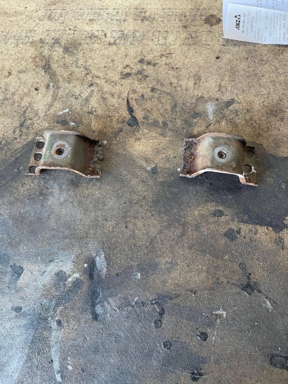

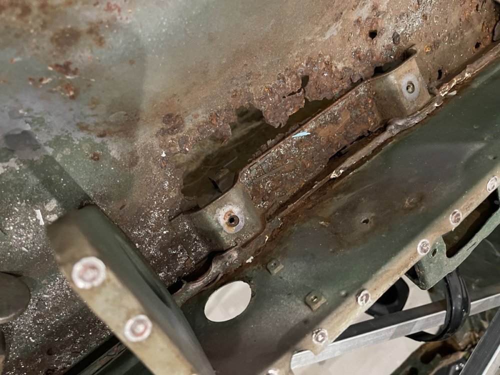

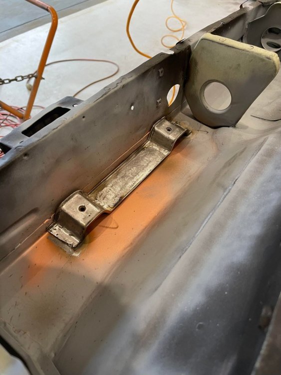

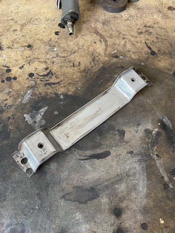

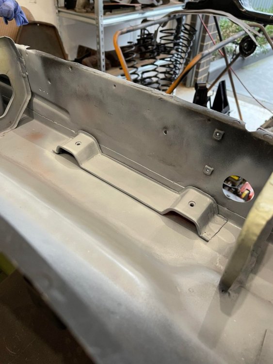

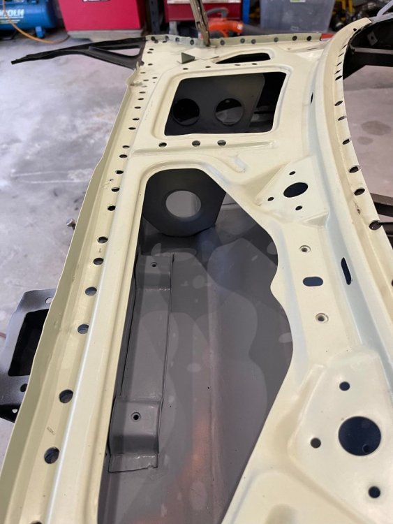

  2. Wiper motor bracket - had to remake the inner section between the two mounting holes. This concludes the wiper area now, the top cover can technically be welded back into place, but i will leave it off for now, i plan to paint and seal the area first before it gets covered back up. Overall very happy with how this area turned out. and some compulsory before shots. I have no idea why these are being uploaded in the wrong orientation. But you get the point. Next up - firewall repair patch. After that is done then the car will be ready for the front clip to be put back on and then it can finally be put on the rotisserie. I have sourced another front end which is much, much better than my current one, so this will save many hours and the finish of the job will be better.
