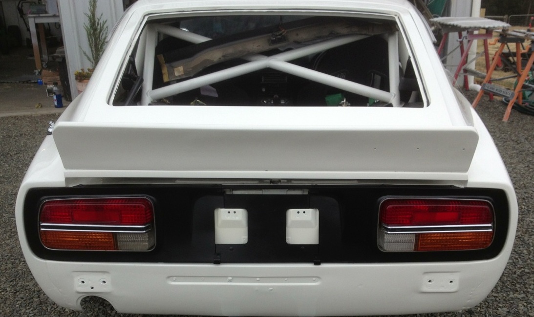

Riceburner Posted January 14, 2013 Author Posted January 14, 2013 I got mine from Scotts and I'm having the same issues as everyone else because it's just a generic seal. I cut my losses and have an MSA kit here for when I get off my ass and fit it Here's a pic of the inner hatch seal fitted, you can see how high the hatch sits. Hopefully it compresses with a bit of time. Quote
Agno Posted January 14, 2013 Posted January 14, 2013 That's pretty much exactly what mine has done... even after 6 months worth of compression. Like I said I'm getting a new seal and starting again it's annoying me so badly. Quote
Riceburner Posted January 15, 2013 Author Posted January 15, 2013 There's a seal softener product available(not sure of the name), you basically apply it and close the door/hatch. The seal is supposed to stay softer and more squashed. I might try this if it gets on my t$ts after a while. Rare spares issued a full refund and were really good to deal with. They checked stock in store and the wharehouse. All rear window seals were the same, so they have defected them and will do a recall. Store man said it looks like a tooling issue, which means a few months for everything to be checked and new seals supplied to stores. I bought one from Warren at All Z Parts. Quote
