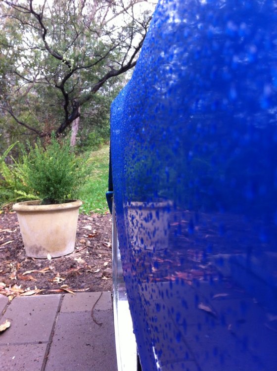

brains Posted November 8, 2012 Posted November 8, 2012 Hi there, Wasnt sure which subforum to post this in but basicly my front right wheel (17x9 -13) is almost flush with the guard and then my front left wheel (same specs) is inset by a very noticable amount. Im concerned there is something seriously wrong with the car, Ive measured the guard space and they are even so its not that, Ive also measured the mounting points for the guards in the engine bay on diagonals to see if that measured up the same, and it was fine. Any insight? Maybe this is common? The car is a 79 280zx 2+2, only owned it for about a month now. Here are a couple pics, Right Left Thank you in advance! Quote
bullzed Posted November 8, 2012 Posted November 8, 2012 That is a massive amount of difference, definitely not 'normal'. Have you measured the distance from the mounting face on the disc to the edge of the guard? Is the front end geometry all out? Does the car pull to one side? And have you tried swapping the wheels to confirm that they ARE the same? One of my front guards sits further back than the other, I can't confirm how but my front end isn't completely square, it's had a bit of a knock previous to my owning of it. Quote
Scoota G Posted November 8, 2012 Posted November 8, 2012 Wizz off both rims and measure distances of the struts that may affect it, make sure the struts are identical. Quote
sco_aus Posted November 8, 2012 Posted November 8, 2012 You sure they are the same wheels? Check that when you take them off Quote
Moderators Zedman240® Posted November 8, 2012 Moderators Posted November 8, 2012 Pays to check hubs also...in case someone fitted another hub from something similar? Quote
brains Posted November 8, 2012 Author Posted November 8, 2012 Wheels and tyres are brand new and have been measured they are deffinately the same, I just put in new shocks and springs and studs so Ive pulled it all apart and put it back together, its all the same 280z hubs non scalloped. Going to take it to a shop on the weekend and get them to check out all the alignment of both wheels and chasis etc so we will have to wait and see I guess. Also the struts are of the same distance aswell. I just noticed also the right rear is also pertruding slightly more than the rear left but not as noticable as the front.. Quote
1600dave Posted November 8, 2012 Posted November 8, 2012 Someone's made a mess of flaring the guards, so that they aren't even ? Quote
Mr Camouflage Posted November 8, 2012 Posted November 8, 2012 Different offset wheels front and back, and you have one of the back ones on the front, and vice versa? or hubs/struts on one side from a later 280zx with different hubs? (Not sure how/if they changed over the years) Quote
bullzed Posted November 8, 2012 Posted November 8, 2012 OH! that's actually a good point made by Mr Camouflage. I know of a dropped 280ZX over in Texas, it's a series 1 and can fit 16x12 -20s with less poke than I can fit my 15x9.5 -57s. I think the track of the earlier 280ZX's was shorter than that of the series 2 (or later models). It could be a case of someone replacing one side due to damage but taking the parts from an earlier ZX. Quote

nat0_240_chevZ Posted November 21, 2012 Posted November 21, 2012 my first thoughts was also a dodgy flare job, but more common than not is a bent strut shaft and or strut tube, would need to checl camber of each side to ascertain if it is this and or remove shockers and spin them to see if there is a sufficient amount of runout. nat0 Quote
gilltech Posted November 22, 2012 Posted November 22, 2012 I agree, check the camber each side - it's not uncommon for the front struts/stub axle to get bent, such as if the car has gone sideways into a kerb at some stage in it's life. So even for starters have a look at the clearance between strut & tyre on each side so see if the pair match. Quote
