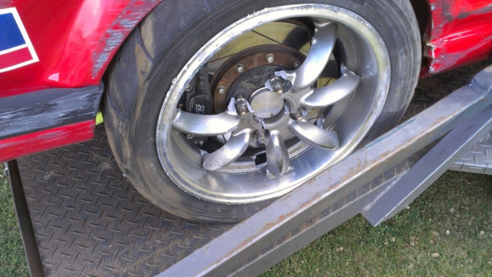

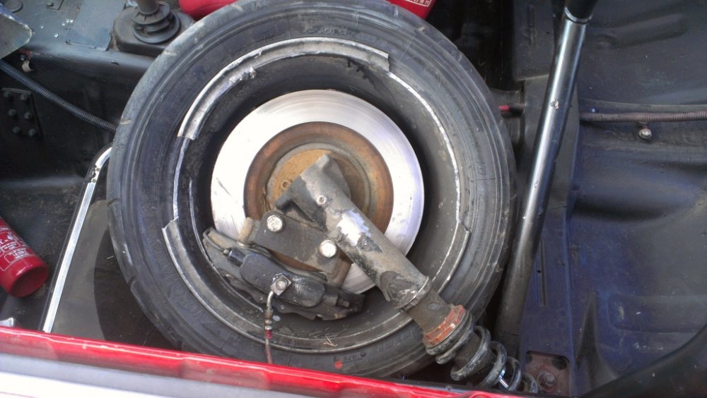

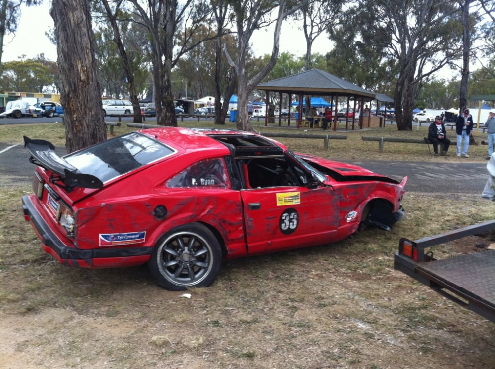

tir33d Posted November 4, 2012 Author Posted November 4, 2012 I'm fine, 4 stitches on forehead where my sunglasses were pushed by my helmet. Car is screwed. No front right suspension left, right rear has bent the hub, both right wheels broken, I can prob get about $8k worth of gear back out of it. I didn't get my plastic, think I still managed 3rd in sport sedans. Funny I did a 48.78 yesterday, but still managed a 49.1 with that big wall scrub. Will load some pics Quote
PZG302 Posted November 4, 2012 Posted November 4, 2012 As long as the rail isn't too badly bent on the front right the chassis may be Ok, will be well worth having a good look when you pull it apart. One good thing about being a 280ZX is a replacement shell or front corner isn't too bad. Also, get someone around to have a look at the car once you pull it apart to check the shell and to see if it can be straightened, the dollars will be less than building a new one. Take your time deciding what you're going to do before making the final decision. Been there and done that, but because of the cage, floor, A pillar and rails where bent and what the car was to be used for I decided to write it off. If you go down the reshelling route, re shelling doesn't take long, I have helped reshell an RX3 overnight to racce on a Sunday after a saturday afternoon multiple roll over. And for yourself, take a couple of days off, you will be sore tomorrow and tuesday once the adrenalin goes away, again I know from experience from a couple of occaisions now.... Matt Quote

PZG302 Posted November 4, 2012 Posted November 4, 2012 Doesn't look to bad, strip the guard off and check the inner guard and the rail, the rest is pretty easy. But you will have to strip it all down to make sure. You should be back on the track in not too long. Good luck with it. Quote
tir33d Posted November 4, 2012 Author Posted November 4, 2012 Right inner is creased up, pushed into my expensive headers, dry sump pump nearby, but intact. I think your right, it may be a bit of work, but may be like the phoenix and rise from the dead. Quote
260DET Posted November 4, 2012 Posted November 4, 2012 Tough luck mate, it looked like it just kept pushing If you do have to get a new shell an early tin top shell would be better for racing. Lighter without the targa tops and stiffer. Quote
PZG302 Posted November 4, 2012 Posted November 4, 2012 Right inner is creased up, pushed into my expensive headers, dry sump pump nearby, but intact. I think your right, it may be a bit of work, but may be like the phoenix and rise from the dead. If the rail is reasonably straight and the floor isn't kinked, there is a good chance it will pull out pretty good. This will save you a lot of time and dollars. I hope you do have a pheonix on your hands... Quote

dat2kman Posted November 4, 2012 Posted November 4, 2012 Having raced full circuit a bit, the run up mountain straight is fun, when the rear get airborne over the hillclimb start line. The vid shows pretty clearly that the car was about 3 metres off line, going into corner before, marbles, dust, no rubber on road, annoying thing, you have visual going into that corner when racing, you come into it, look over top of wall on LHS, and can see the cars in front. Coming off of skyline, (blind crest) after the finish line is the undies moment, when someone in front has pirrouetted. In Toyota parlance, BUGGER! Quote
260DET Posted November 5, 2012 Posted November 5, 2012 You may want to look at the aero because a front/rear downforce inbalance could have caused the big push which led to the crash. Rear wing may have unloaded the front which for balance would need a good air dam, splitter and undertray. With effective rear wings available it's pretty easy to buy rear downforce, not so easy to buy matching front. Quote
dat2kman Posted November 5, 2012 Posted November 5, 2012 Richo, not enough speed in that section for aero to have unloaded the back end. It was too wide through that corner, marbles, dust, whatever, it just got loose. More power and a bit of oppo lock could have held it, but at that point it is very much like canyon racing between walls. Quote

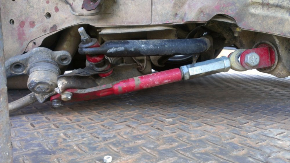

Riceburner Posted November 5, 2012 Posted November 5, 2012 Castor rods look like they were built tough, techno toy tuning? Quote
dat2kman Posted November 5, 2012 Posted November 5, 2012 Interesting that the two bolts from ball joint to bottom of strut snapped clean? No indication of fretting to holes in ball joint, clean double snap means a fairly hard hit. Quote
Moderators Zedman240® Posted November 5, 2012 Moderators Posted November 5, 2012 Interesting that the two bolts from ball joint to bottom of strut snapped clean? No indication of fretting to holes in ball joint, clean double snap means a fairly hard hit. I'd like to see if there is any bolt left in the threads? Thought the heads would've been snapped off and just the rest of it left there.. Quote
