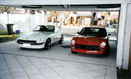

To provide some background on the car, I purchased it in 2002 of Andrew Dunne from the NDSOC as somewhat of an unfinished project car but running. I had already started to modify my 260Z 2 seater and was about to commence turning it into a targa car when Andrew put his car came up for sale along with a list of parts. Essentially what he hadn’t done to it mechanically I had done to my 260Z so I swapped the better parts from the 260 onto the 240 and then sold the 260 and unwanted parts to Peter Mac which is now his awesome track car (refer attached photo). I first came across the 240 when I joined the NDSOC back in 1987 so I was aware of its long history. In fact the rear bumper of my 260 was sold on put on it back in 1990! Prior to the 260 I started my Z addiction in 1984 with a 2+2, modified it and then moved to the 2 seater 2 years later. So I’ve been a Zed owner continuosly now for almost 30 years, which is about how long I know Gordo (I've only seen pictures of the porka and besides, we all make mistakes in life, right Gordo!)
