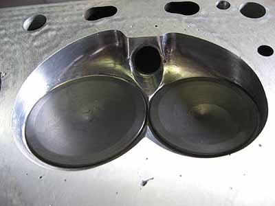

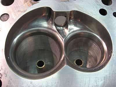

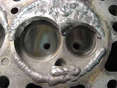

peter mc Posted August 23, 2012 Posted August 23, 2012 i have lots of pics of the head it is a N42 on the outside lol the chamber is fully welded and shaped and flows 320hp jap dyno read very high Quote
peter mc Posted August 23, 2012 Posted August 23, 2012 the N42 is a good head if you spend 7000 to make it work like this one Quote

NZeder Posted August 23, 2012 Posted August 23, 2012 I agree with Peter on this - that Jap Dyno must be reading high - no question that is a lot of engine with some big $$ parts (a custom billet 86mm stroke crank from AS-Watanabe - lots of head work going on there) but 369PS that head would have to flow 230cfm at the choke and more at the head so that is a big big ask - yes those flow numbers can be had at the head but to get 230cfm at the choke even with 50mm Mikuni's that is a lot of air required to get those numbers. So I am with Peter more like a 320hp setup. Quote

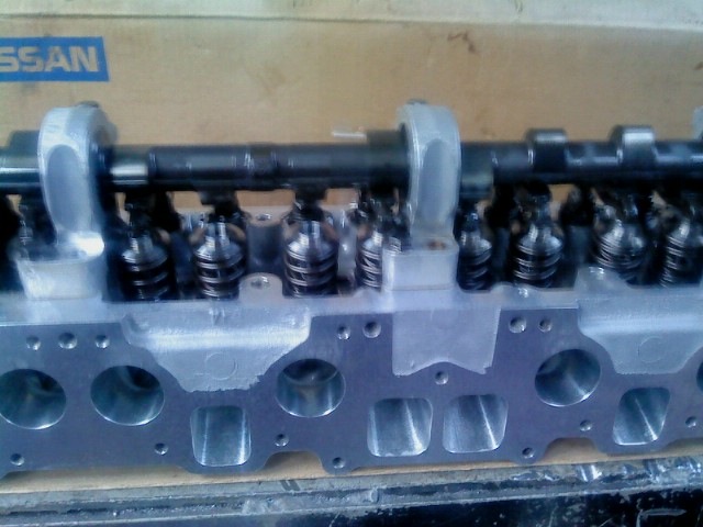

peter mc Posted August 23, 2012 Posted August 23, 2012 some pics of the head and the work to the N42 to get it to work , the head flows 320hp cost in aus 7500 Quote
SS30RR Posted August 23, 2012 Author Posted August 23, 2012 What are they doing here Pete? So world wide no ones exceeded 320hp? on a L-series pump gas? Quote
benny Posted August 23, 2012 Posted August 23, 2012 What are they doing here Pete? So world wide no ones exceeded 320hp? on a L-series pump gas? just looks like CNC porting to me Quote
luvemfast Posted August 23, 2012 Posted August 23, 2012 just looks like CNC porting to me Whats interesting about this is though, is that its only 3 axis milling. I would have thought for an engine like this, 5 axis would be used. they are also using a straight cutting oils, rather than a soluble type. Makes me wonder about about the possabilities......... Quote
benny Posted August 24, 2012 Posted August 24, 2012 Whats interesting about this is though, is that its only 3 axis milling. I would have thought for an engine like this, 5 axis would be used. they are also using a straight cutting oils, rather than a soluble type. Makes me wonder about about the possabilities......... Perhaps they are just correcting the inlet/exhaust face shapes?? Quote
peter mc Posted August 24, 2012 Posted August 24, 2012 that's a very crude cnc head the CNC heads we have hear are 5 ax type and the Finnish is incredable , but the question can you make more than 320 hp on pump yes on a 3.2 about 330 , just over the 105hp per L mark that why we built the 3.4 lol Jake's motor make 360hp on pump fuel and we have a full spl head at work from japan 12.7 comp race fuel only made 310hp on a 2.9 on the same dyno as gordos engine made same power on 10.5 comp pump fuel Quote
peter mc Posted August 24, 2012 Posted August 24, 2012 cnc head made hear in oz out flow the spl head by 6 cfm and the hand port heades we do now out flow the old cnc port by 20cfm just more time , les and i have been working hard to move the port so we can make it better the new port is being sent of soon to be setup for copying so it can be cnc ported , 374hp off air intake should be a cracker Quote
