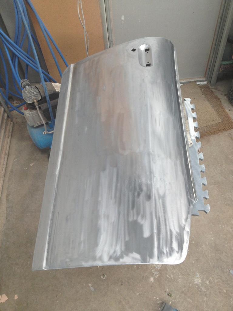

Riceburner Posted July 20, 2012 Posted July 20, 2012 I used 'strip it discs' on the parts of my car I've done. I haven't had much rust to deal with, but plenty of paint layers and bog. I used the discs on my doors recently, going slowly it took about 30mins per door skin, which was 1 and 1/4 discs. Depends on how much need to be done and the condition of the car but these discs worked great for me. Quote
zzzzed Posted July 20, 2012 Posted July 20, 2012 Yeh those strip disks work great. I use a combination of stripper and the strip disk, Otherwise known as seaweed disks Quote
