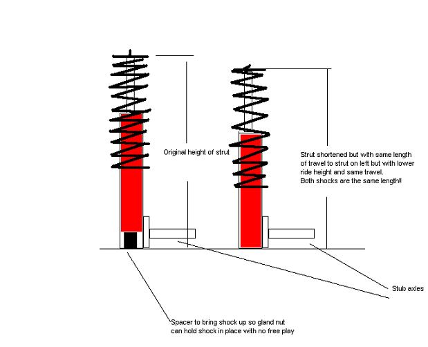

Moderators Zedman240® Posted April 1, 2012 Moderators Posted April 1, 2012 If you section the strut the same amount as the spacer that lifts the shock up, you will lower the car but retain the same amount of shock travel. I've drawn up a quick crude drawing to show what I mean. Even with a coilover setup, if you lower it even further, you will lose travel in the shock. Be very careful with Koni shocks.. one event of bottoming out, and its rebuild time with your shocks! Quote
DAZDA Posted April 1, 2012 Posted April 1, 2012 I think the ‘complete strut’ type you have in the second picture are similar to having an ‘adjustable spacer’ as well as an adjustable spring seat. The lower threaded section controls the shock and spring position relative to the stub axle and the second threaded section controls the spring height. In theory this can mean you don’t lose any shock travel but the ‘total’ shock travel may be less to begin with for this type of coilover for a Zed, I don’t know... Quote
d3c0y Posted April 1, 2012 Posted April 1, 2012 Yeah what Dazda said is right. The whole point of the threaded coilover is so you dont loose travel and change your spring preload with height. On hybridz there are heaps of topics about how much travel a zed requires with this setup. Dont forget you still have to cut the strut tube off and weld on a threaded tube for the coilover to wind into. Quote
