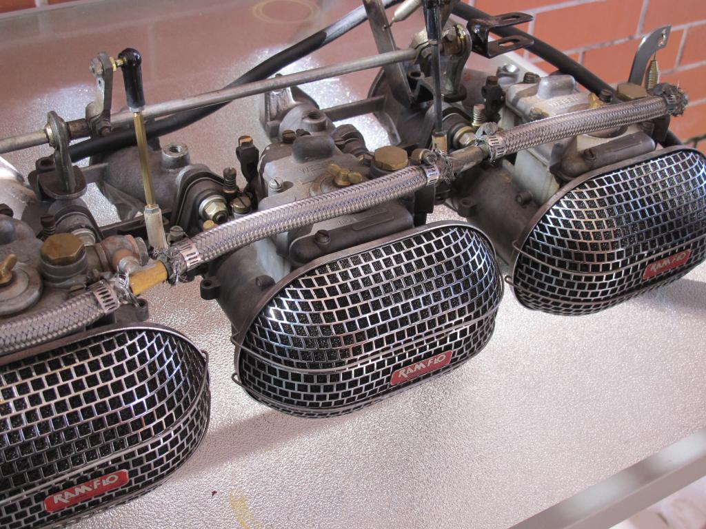

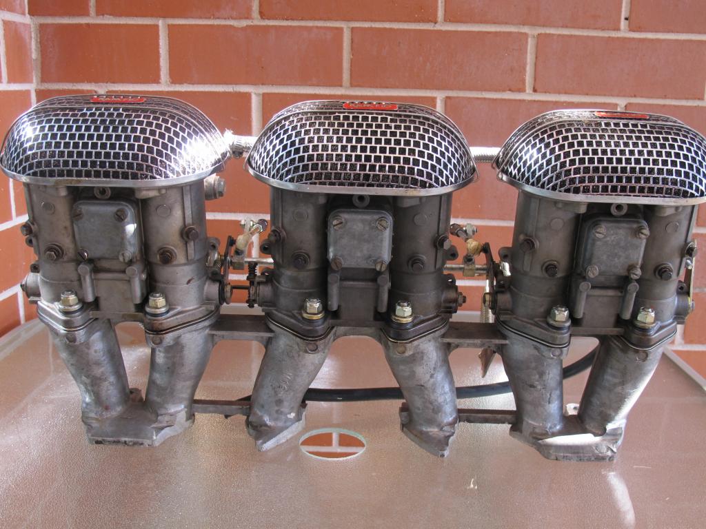

Kent Posted March 11, 2012 Posted March 11, 2012 Hi Guys, I have a set of triple Webers with lynx manifold, triple ramflow filters and all the linkages (installed by SWR)to suit an L28. These came of a mates 260z with L28 and they were tuned by Stewart Wilkins. Unfortunately they don't suit my stock L24 and as much as i would love to believe they would and hold on to them, deep down i know they just won't work for me. The webers are currently spec'd as follows: Choke = 36 venturi = 4.5 Main Jet = 145 Air corrector = 180 Emulsion Tube = F15 Idle jet = 60 F6 Pump jet = 35 Now, i am not 100% sure how much these are worth, i am guessing $1200 or so (i believe my mate paid around $1450 for them 4-5 years ago) so i am open to offers and hugely open to suggestions on what they are worth Pickup in Sydney, otherwise i can probably get them couriered if i can find a decent way to pack them. Kent Quote
Scoota G Posted March 11, 2012 Posted March 11, 2012 Stewart Wilkins tuned 45 DCOE Webers at $1200 is a good price for sure. Quote
Kent Posted March 11, 2012 Author Posted March 11, 2012 really? what is the market value for them? should i be asking $1400ish? i certainly don't want to give them away unnecessarily (but don't want to ebay them either) Quote
