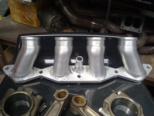

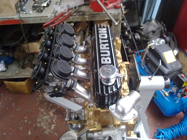

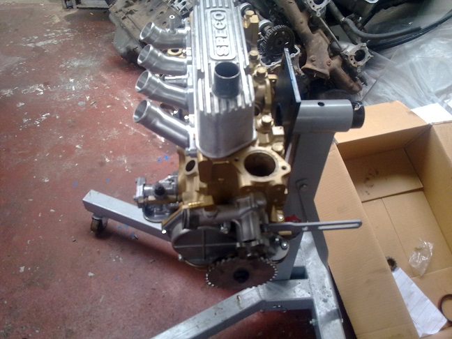

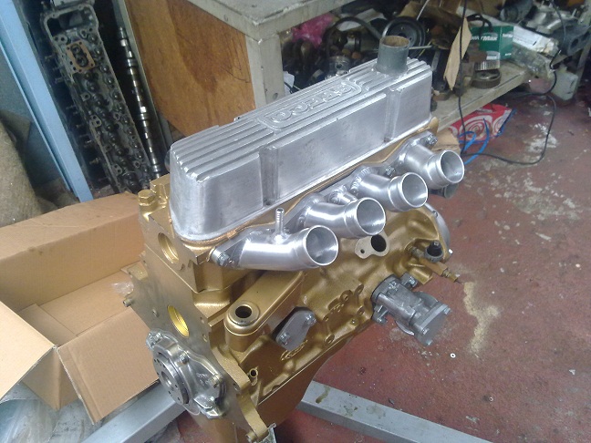

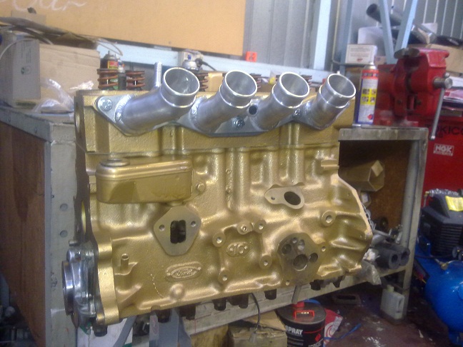

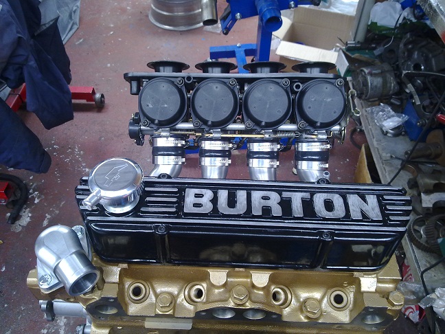

Yes this is getting a set of 38mm CV motorcycle carbs on it, with a custom manifold.

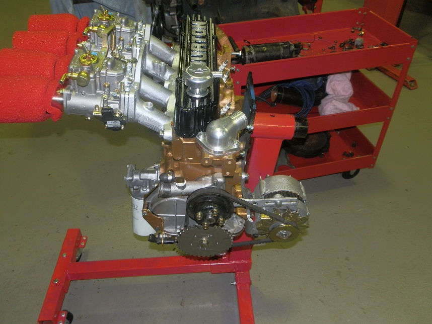

Pete,
I'm confused  :o
Why do you paint our Datsun motors 'Ford Blue' and a little Ford beastie 'Nissan Gold' ?????

Progress has been steady with the Escort with Alex buying lots of new replacement/upgraded parts:
Custom Ordered 13x7 Minilites.

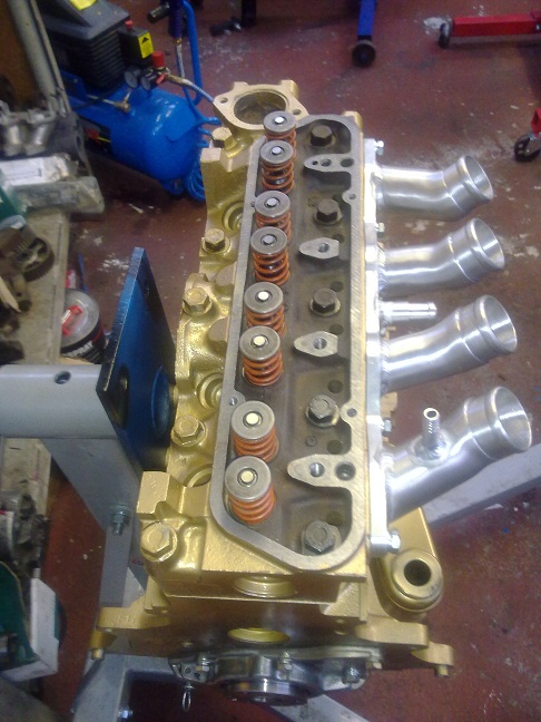

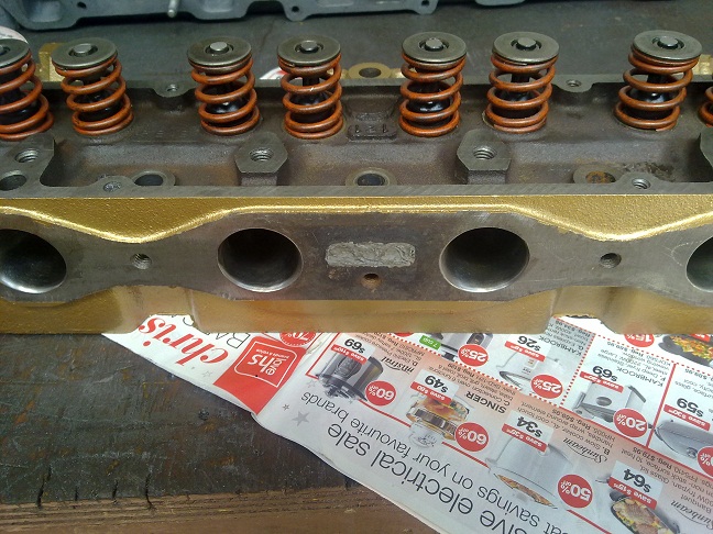

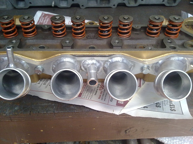

The Engine has gone back to Peter Mc for further modifications - more head porting & an increase in compression.

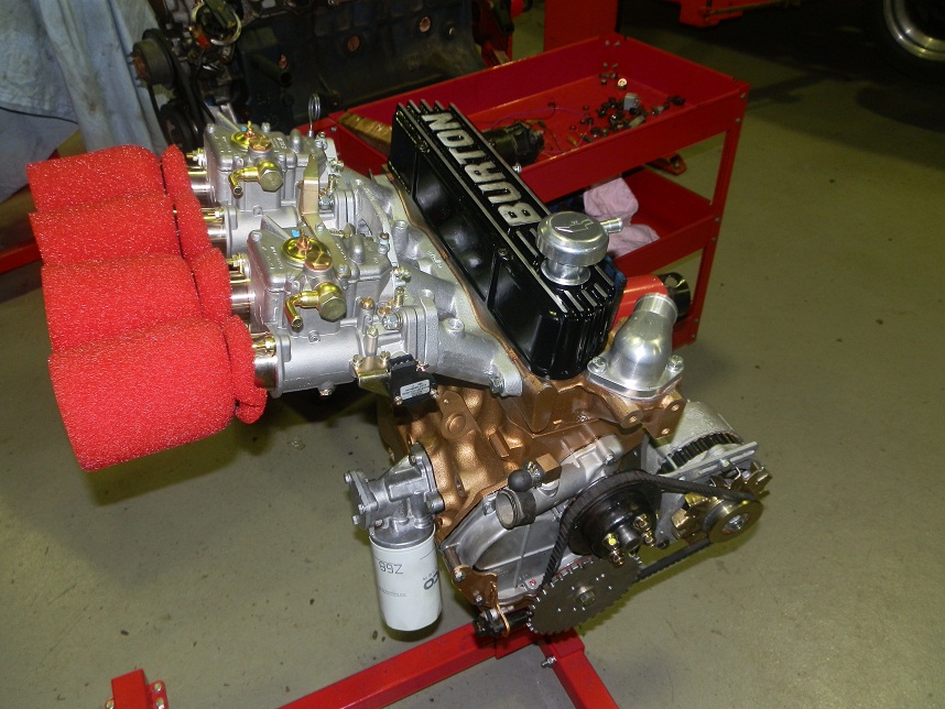

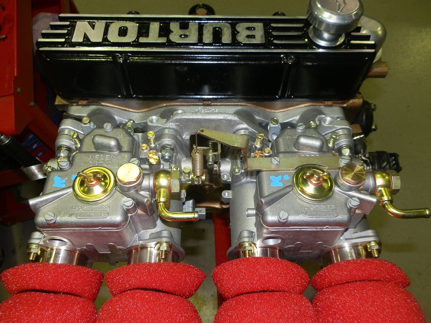

The Bike carbs really didn't work - only making a bit over 120hp, so some 45mm Weber's have been ordered from 'Weber Performance' in Mordialloc.

Oh no bike carbs, whats he doing with them? Body is coming along nicely, will be better than new when Finished.

He's looking for a buyer for the bike carbs - they just done flow enough air.

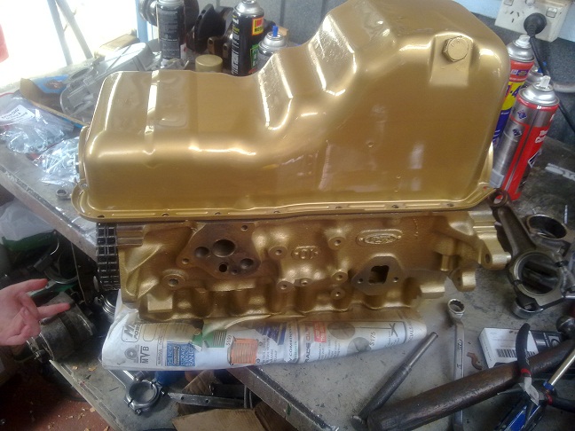

finnished pics
FWIW the oil pressure T piece in this pic is a weak point due to the vibrations of a Kent motor.  Best bet is to move the T piece off the block and onto the inner guard with some braided line.
Roger
What size are the carbs Lurchos, did they fiddle with the jetting and the slide vacuum holes?
I second the oil 't' piece, my brother had his crack on a road going 1600

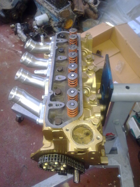

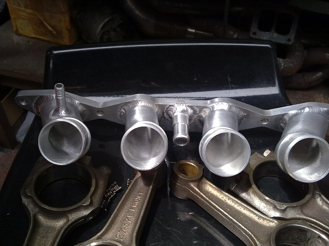

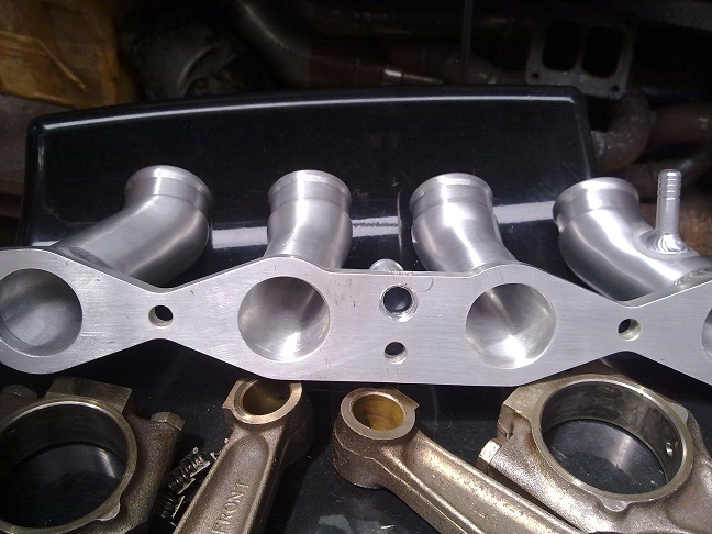

Yes we got the carbs perfect , very easy to tune but at 125 hp there past there best so we went to 45mm Weber's the 600 carbs were very smooth but rejected lots of fuel at 5000+ rpm  , the length of the manifold was to short for the job , and as we are after 150+hp we needed more air and Les deemed the head and carbs needed more work so i have ported the head again and had the head stud do the guides and seats , and i fitted new springs so we could rev it to 8k and Alax has got new 45 carbs and manifold
