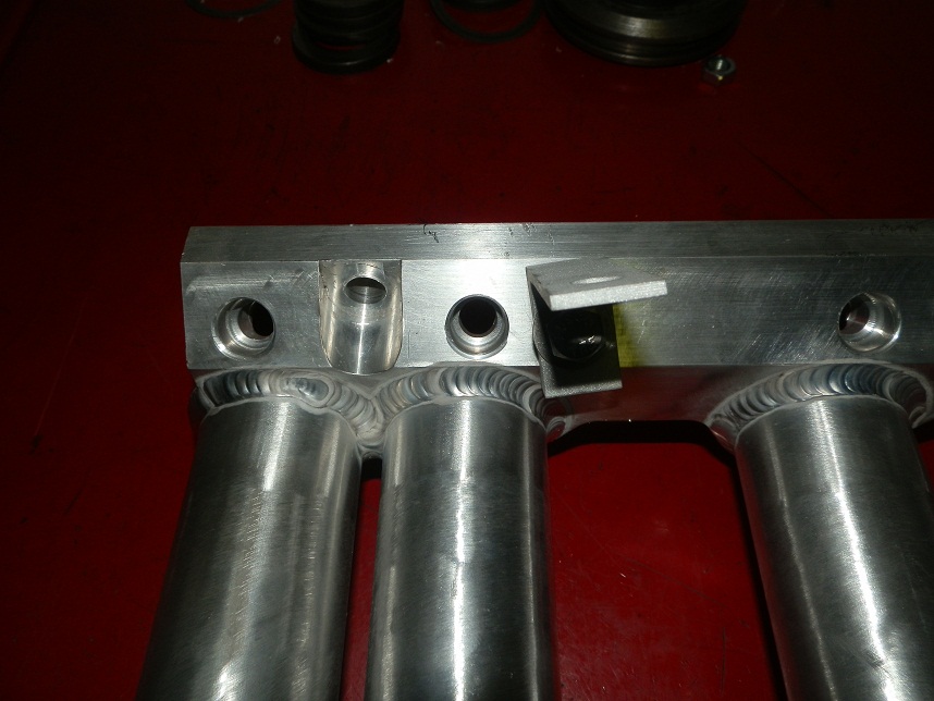

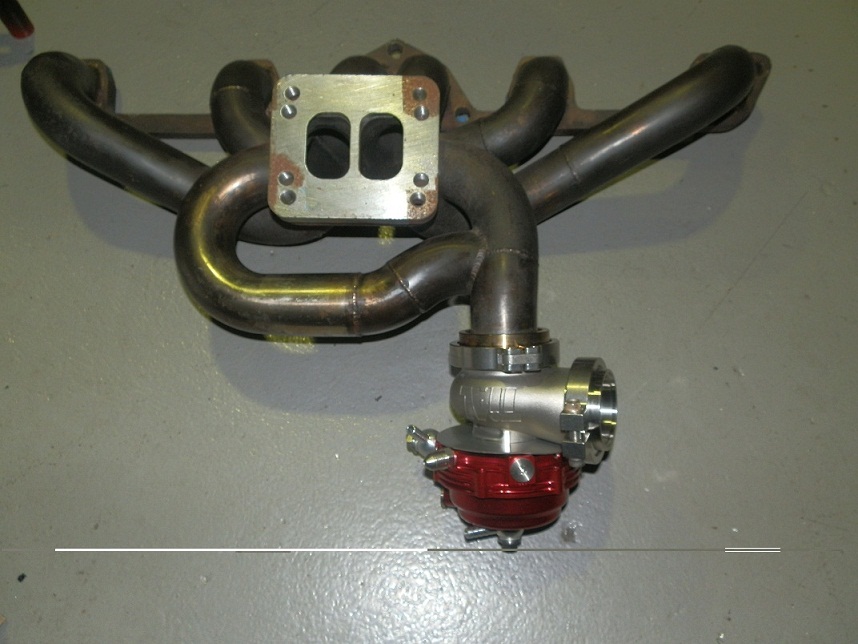

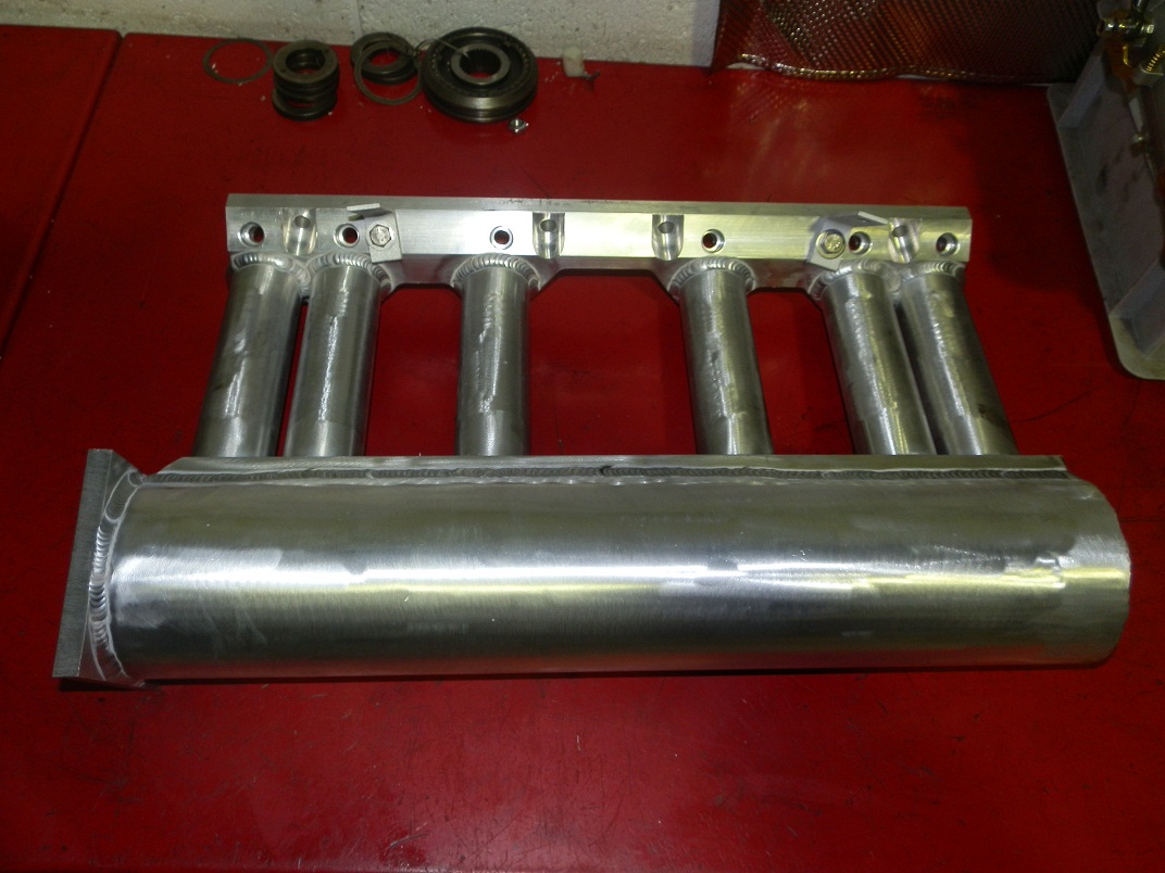

peter mc Posted April 19, 2012 Author Posted April 19, 2012 some pics of the new inlet from the US and the exhaust manifold now with the wgate on . more pics tomorrow off the head with the new water mods , iv striped the hole thing as it been sitting not finished so i wonted to make shore its all as good as it should be Quote
handsandwhich Posted April 19, 2012 Posted April 19, 2012 Pete, you know I love shiny polished things and that manifold needs the bling factor added. Owner should seriously consider polishing it up before installation. Quote
peter mc Posted April 19, 2012 Author Posted April 19, 2012 your not wrong mate the finish is not as good as it should be ,,, like most things that come from the US now there crap , i was thinking id send it over to hpc . after i finish it so it works , ,, it needs about 4 hours of time to weld up and fix all the crap welds and weld a peace of ally to the bottom and tap some holes in it for the vacuum pickups . just a peace of crap the way it came from the US Quote
