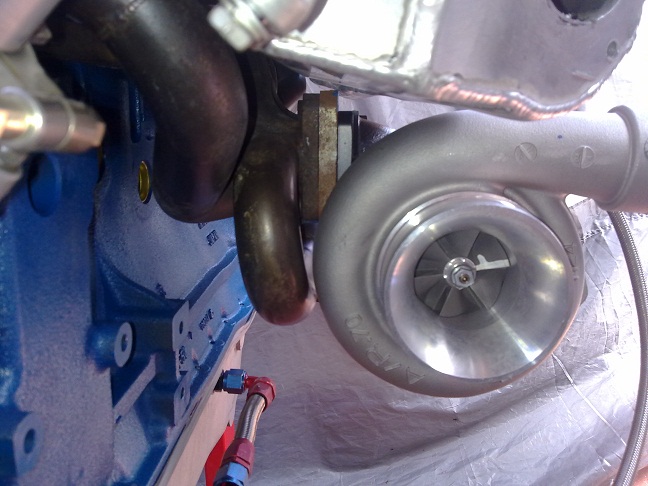

peter mc Posted September 29, 2011 Posted September 29, 2011 OK so i will do a build page for each motor this one is for Aaron in WA SO it a L28ET spec piston 87mm Ross forged flat top con rods are spool L28 rods H beem style the crank is standard .25 main and .25 big ends has been drilled bunged all parts have been balanced and new spigot bush fitted it runs a NC girdle and ARPstuds in the mains and head the sump is from Arizona z car oil pump is a turbo type it has new timing Chane and guides with new crank sprocket and SW adj timing gear cam is a PMC turbo spec 280deg 550 lift new rockers springs are HSD retainers are high side billet steal, valves are 44mm in 36ex and the head is a P90 ported PMC turbo spec inlet is a custom ported unit ex manifold is a jap made unit and is very well made the turbo is a 35.40r with a .64 rear for mad responce Quote
Z Posted September 29, 2011 Posted September 29, 2011 Really interested to see how this build goes Pete, what will the specs on the injection be (injectors, ITB size etc)? Quote
peter mc Posted September 29, 2011 Author Posted September 29, 2011 YES all specs will be posted Quote

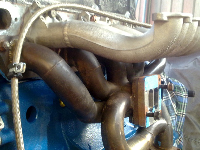

Scando Posted September 30, 2011 Posted September 30, 2011 That exhaust manifold looks like a brilliant design for the limited space on a l28t. This should make one quick z Aaron I found mine tapered off quickly up in the revs with the .63 but it may have been something else restricting it on my setup. Quote
peter mc Posted September 30, 2011 Author Posted September 30, 2011 i think you may have had some other problem as i have made 530 hp at the wheels with a 3540 .63 and 7500rpm Quote

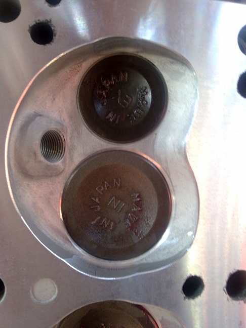

luvemfast Posted September 30, 2011 Posted September 30, 2011 Why the flattop pistons for a turbo build Peter? P90 head with flat tops is somewhere around 8-9:1 comp My N/A P90 runs domed pistons to get comp up to 10.5:1 Peter will be able to verify/correct me Quote
peter mc Posted September 30, 2011 Author Posted September 30, 2011 yer p90 head with chamber mods will have a 55cc camber so comp wont be to high it will end up with a comp off 8.5 -1 flat piston is nice as there are no sharp edges =no hot spots Quote

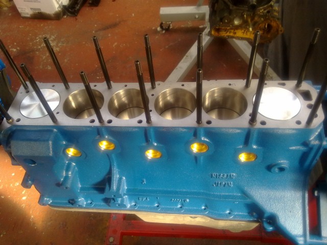

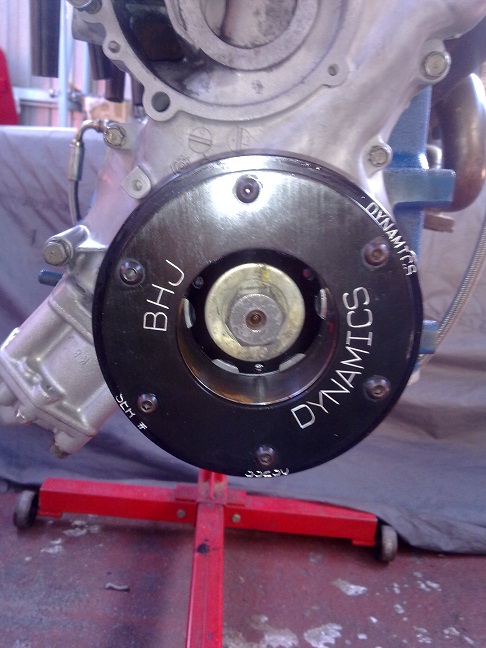

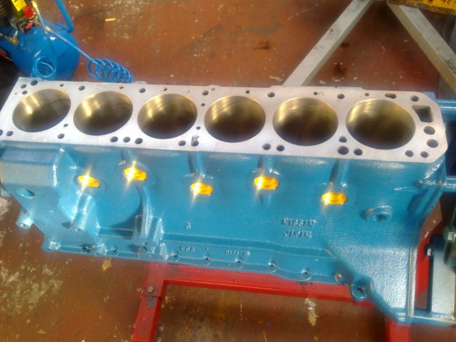

peter mc Posted October 14, 2011 Author Posted October 14, 2011 sorry i have not keeped you up to date iv not been so well but iv got all the bottem end put together so hears a pic or two; off the girdle and the spacers that you need to make it all work Quote
Z Posted October 14, 2011 Posted October 14, 2011 Couple of questions here, first one will probably answer itself, the little oil filter thingo is a good move?... Yes! But if it is worth having on a high performance engine, with most likely a super fussy owner who would change the oil every 50k? I guess I'm just asking how much theses original filters are worth it, would appreciate what you reckon. Secondly with the girdle, is it necessary if you are going with the Arizona Z aluminium oil pan, which is saif to give more strength? The more the better I suppose? Pretty excited to see how this build comes out as I'm getting ready for a 28ET as well. Z Quote
RB30X Posted October 14, 2011 Posted October 14, 2011 I assume your talking about the oil pump pick up filter. Its not so much to filter dirty oil, that's what your oil filter does, it's to stop foreign objects getting into the oil system. Imagine at high rpm a valve spring breaks and bits of it fall into the sump. That screen stops the bits getting sucked up and doing more damage. Quote
luvemfast Posted October 14, 2011 Posted October 14, 2011 Yes, the AZC cast aluminium sump will add to rigidity of your block. But the girdle adds rigidity to your crank, reducing crank flex. So even though they do the same thing, it's in different areas. The girdle also acts as a bit of a windage tray and crank scraper, reducing the amount of oil mist in the bottom end. Quote
peter mc Posted October 15, 2011 Author Posted October 15, 2011 this morning i made the turbo Drain and feed lines and did some portwork hope to have the head finished next week Quote

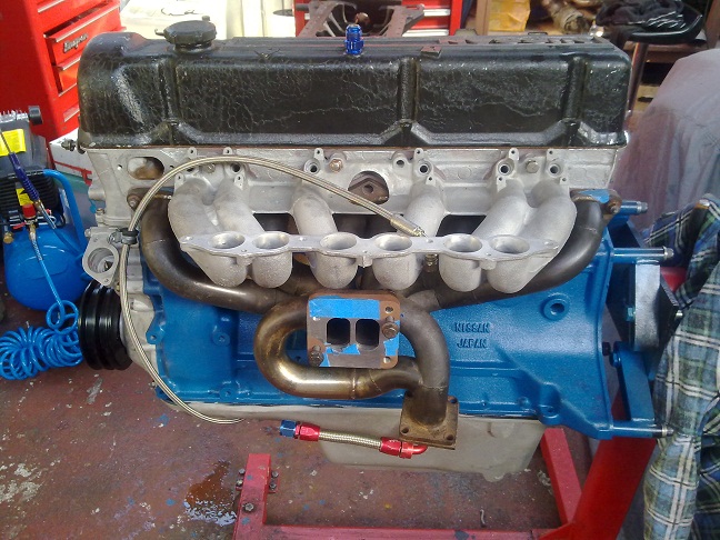

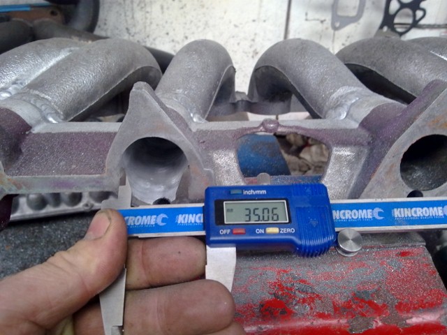

DatPilot Posted October 17, 2011 Posted October 17, 2011 Very interesting intake manifold too! Looks similar to a chopped up RB intake?? Quote

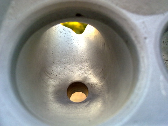

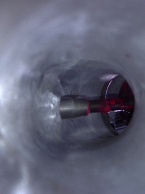

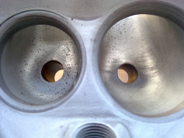

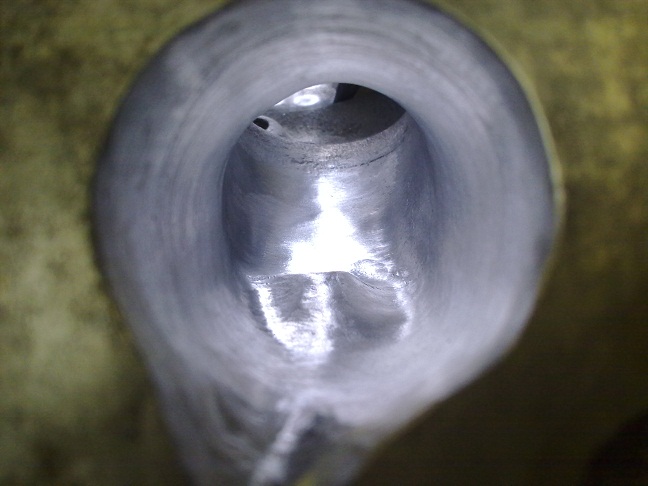

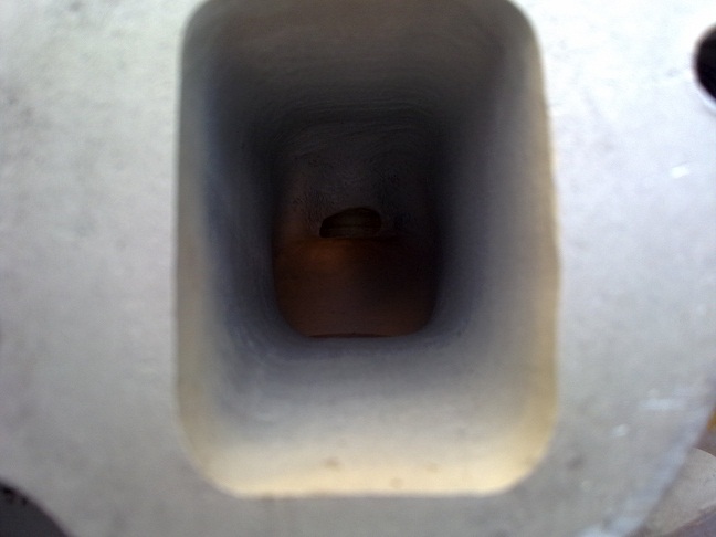

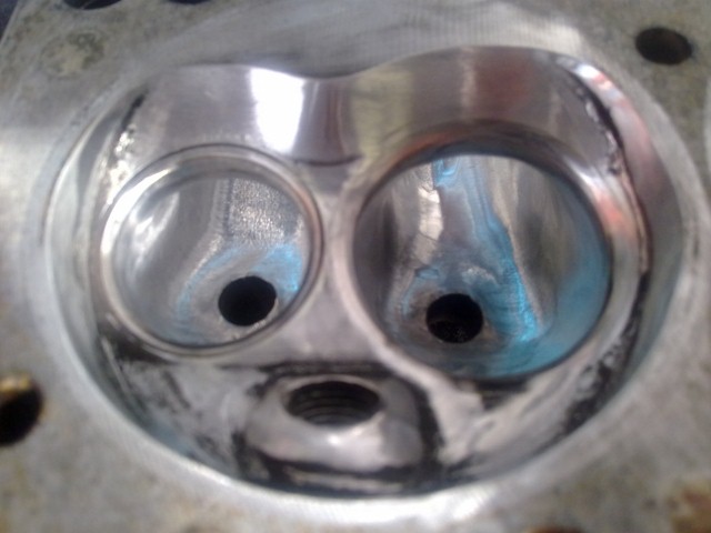

peter mc Posted October 17, 2011 Author Posted October 17, 2011 well iv finished the porting and now it off for new guides and seats and some work in the chamber Quote

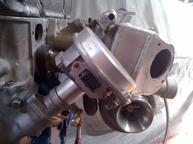

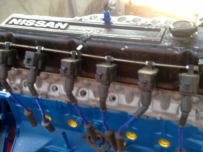

peter mc Posted October 23, 2011 Author Posted October 23, 2011 well big weekend in the shed some pics for the l28t people out there Quote
peter mc Posted November 11, 2011 Author Posted November 11, 2011 have just started to make a custom intake manifold for the L28t, and i will try to make it so the heat from the exhaust does not kill hp ,i hope to have about 12in long runners and a plenum of about 6L with a throttle of 70mm will post lots of pics of the manifold as i build Quote
