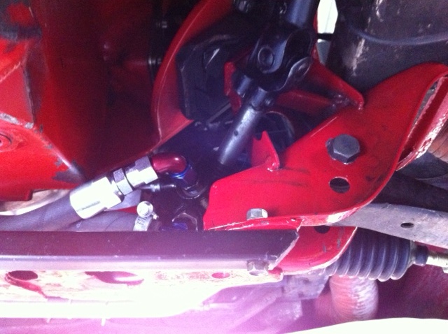

620Z Posted September 10, 2011 Author Posted September 10, 2011 Quick update. Spent 5 hours on it today. Ground about 2mm of the chassis rail. Didn't have to take much off or break through it. So fitted up the steering arm and fits perfect with about 5mm clearance. Re routed the fuel line. All done. So Sunday I have to re fit the header fill radiator & power steering fluid etc. Then start her up and check for leaks. Been a big job for a hack like me. Will report back with results and some pictures tomorrow. Cheers Quote

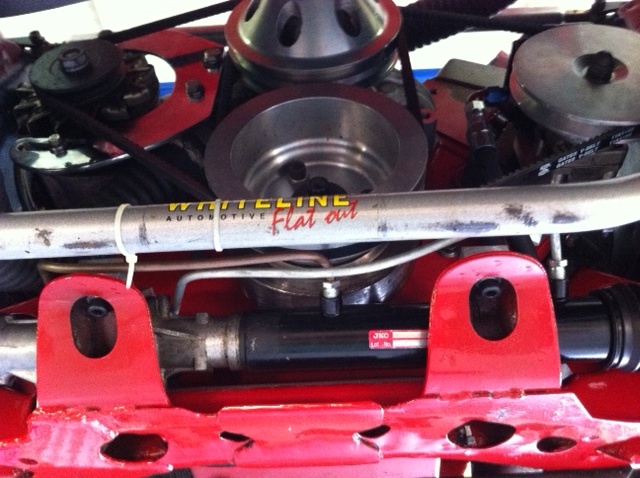

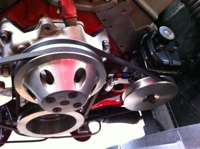

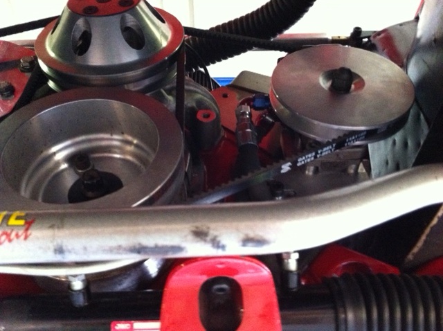

620Z Posted September 12, 2011 Author Posted September 12, 2011 OK all finished and started her up on Sunday. Damn we made the alloy pulley for a 13mm wide belt not an 11mm belt. So the belt started slipping even though I got a bit of pressure but not total. So the pulley is being modified today to accommodate the 11mm belt. Will try again this Tuesday night. Fingers crossed again. Since it's getting a bit boring I have thrown up a few more shots. Quote

620Z Posted September 13, 2011 Author Posted September 13, 2011 Hi Gents, Well we started the car last night and have a problem. The steering pulls massively to one side. I can't pull it back the other way when the motor is going. Almost like no oil on one side. But we checked we have oil in both lines when we took the two off. Our thoughts are that maybe we put the lines around the wrong way? We are confident the pressure and non pressure feed hoses are OK. What do you think guys. Could this be the cause? Any other ideas. Are we 100% sure turning the mechanism 180 degrees is OK on the Subi rack? I will go on line later today and look up some sights and try and work it out for my self. However the USA cars are of course left hand drive etc. I will try and find some pics that might help me. Either way I might pull the lines off tonight and get some new ones made up to swap them around? Open to suggestions from people who might know more on this than me. Cheers Quote
KatoKid Posted September 13, 2011 Posted September 13, 2011 I looked at Craig's photos and his lines from the power head to the rack are correct and then I started fairly shivering myself that the whole concept of turning the power head on the rack 180 degrees was an issue. Just spoke with Craig and it turns out he has his high pressure and low pressure lines from the pump the wrong way around. I took a shot of my rack when I first got it and you can see the high pressure is the smaller diameter line that goes in the lower port and the low pressure (no flare nut on the end that goes to the reservoir) is the larger line that goes in the top port. Phew! Quote
620Z Posted September 13, 2011 Author Posted September 13, 2011 Wow thanks Dave you saved me some time and hassle with your great advise. When I got my rack there were no pressure lines on it. So all we did was assume the same thread from the pump was the same thread size on the rack. But amazingly or inexplicably they are different. So off to Gordon's tonight to remove the lines and get a new pressure hose made up with different fittings either end and bob should be my uncle! The saga continues but not a bad thread for others who plan on doing the same I guess. Moral to the story. Never give up, never run out of time or funds and you will succeed in the end. Fingers crossed the end is near. Cheers Quote
