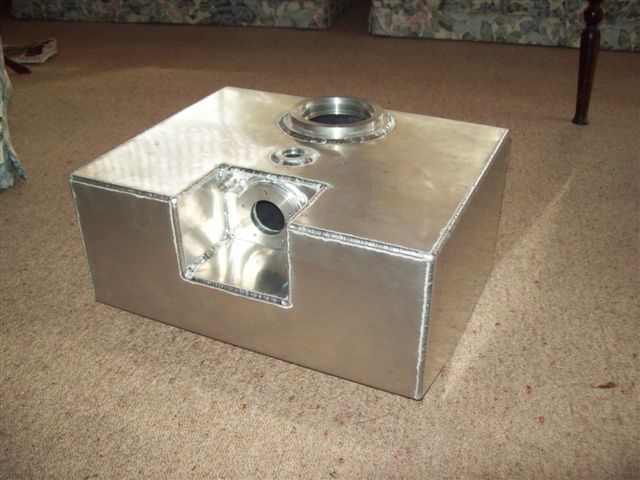

PeterAllen Posted June 21, 2011 Posted June 21, 2011 Got the finished tank today. I might be bias but I think it's worthy of a place in the Guggenheim. I don't know when I'll fit it as I still like just looking at it. Quote

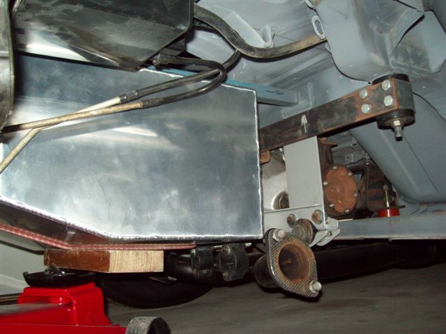

NZeder Posted June 21, 2011 Posted June 21, 2011 Nice work Peter - so this goes in the stock location under the zed? Just not a large/long = makes room for an exhaust system without sharp restrictive bend to clear the stock tank Quote
chris240 Posted June 21, 2011 Posted June 21, 2011 2 remarkable things here.... 1st - great workmanship 2nd - she let you bring the tank into the living room Quote
PeterAllen Posted June 21, 2011 Author Posted June 21, 2011 2 remarkable things here.... 1st - great workmanship I haven't used this fabricator before but he came highly recommended - the price was very very reasonable 2nd - she let you bring the tank into the living room She had no choice really, the study was full. NZeder - I've removed the spare tyre well. The photos are from last week before the straps were made. Quote
NZeder Posted June 21, 2011 Posted June 21, 2011 That explains it Peter - I see the holden diff in there - looks good Quote

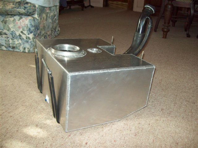

PeterAllen Posted June 22, 2011 Author Posted June 22, 2011 Good memory Tim - I actually had to measure it again today to confirm 47 litres. The LS1 in a 1700kg Ute gets around 13.5 lts/100km on a road test and that would give me around 350km/ tank. I'm hopeful that the same LS1 in an 1100kg S30 could give around 10-11 lts/100km and that equates to around 450 km/tank. It will not be a daily drivers so I think it will work out okay. Blessed are the Pacemakers... No offence intended, Rev et. al. Quote
