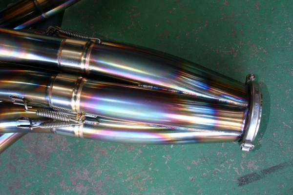

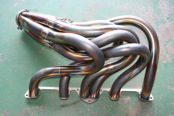

Riceburner Posted August 26, 2010 Posted August 26, 2010 What about these.......... Yahoo Japan, bid is at 185,00 yen or buy now 295,000 yen!
NZeder Posted August 26, 2010 Posted August 26, 2010 My last 240z (larger than stock engine) I purchase a set of these from Japan http://www.nengun.com/kakimoto-racing/exhaust-manifold but at 48.5mm primaries they might be a little large for a 2400ish cc engine - they worked well on my larger L6 power car

Riceburner Posted August 26, 2010 Posted August 26, 2010 those 6into1 nos 10000 rpm =10sec 1/4 mile :)mmmm Hehe! You would need a perspex front end.... It would be a tradgedy to hide those away! NZeders look the sensible choice
