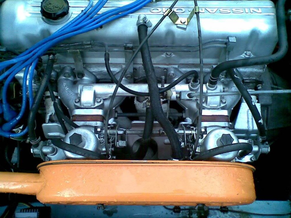

From the pics it looks like internally its in good conditions. Just needs a clean externally, but careful getting any water near that electronic module. (remove it first).
Also found this:
http://cgi.ebay.com.au/DATSUN-NISSAN-L24-240Z-Engine-Motor-Dual-SUs-Carbys-/260654181584?pt=AU_Car_Parts_Accessories
Looks like they are proper "Hitachi 240z Style SU's" minus the airbox (airbox is hard to find - but worth finding if you can get 1). Also they look like the 3 screw version. I'd ask him if he could separate the carbs and manifold for you? You never know he might just do it. Offer him something like $200-$300 for them as is, or he may even still have the original airbox which is worth paying a little extra for.
