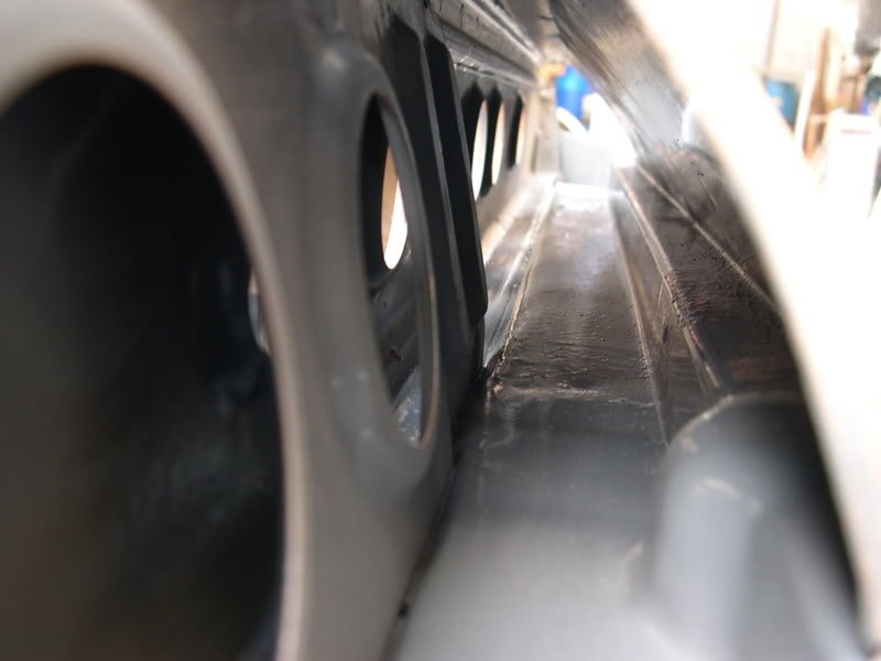

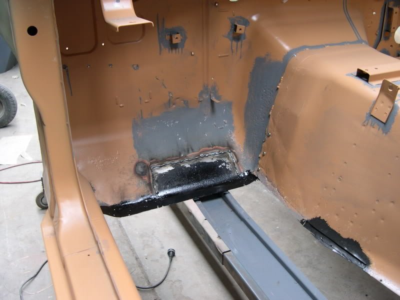

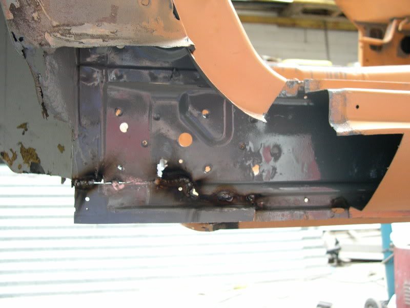

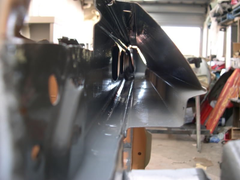

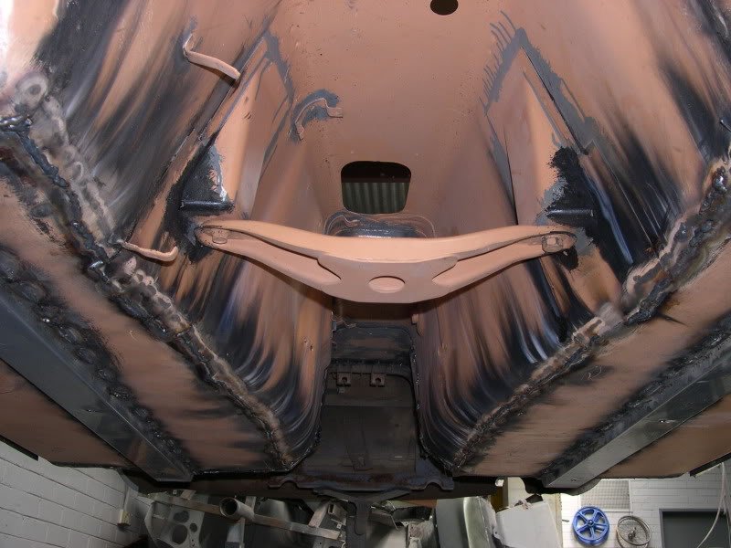

V8Datto Posted August 2, 2010 Author Posted August 2, 2010 PM sent regarding gearbox cross-member mounting points design Both sill areas were sandblasted and painted with POR-15 I also painted in all the hard to reach places in the cabin where the spray gun didn't reach, but have now decided to re-sandblast the entire interior and pant with Black POR-15 at a later date Quote

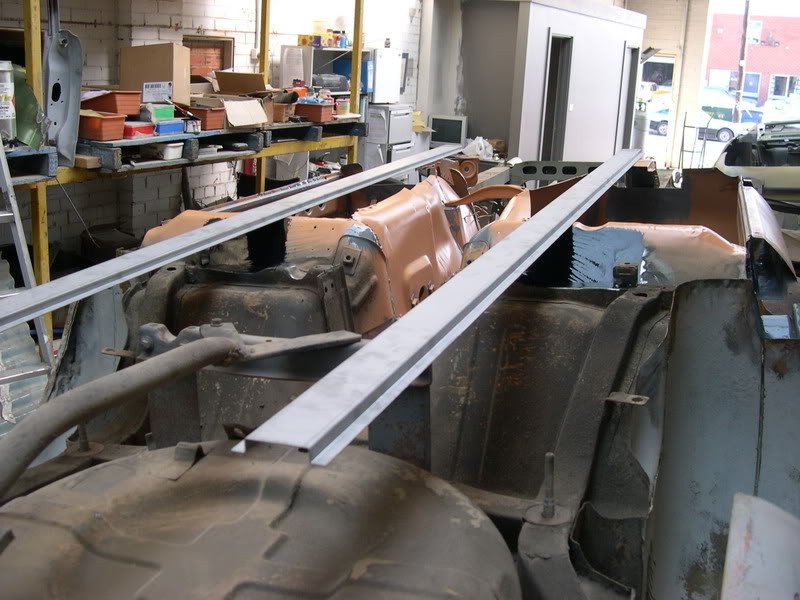

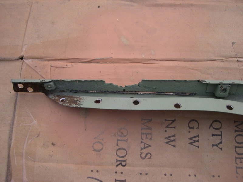

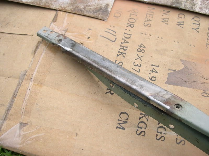

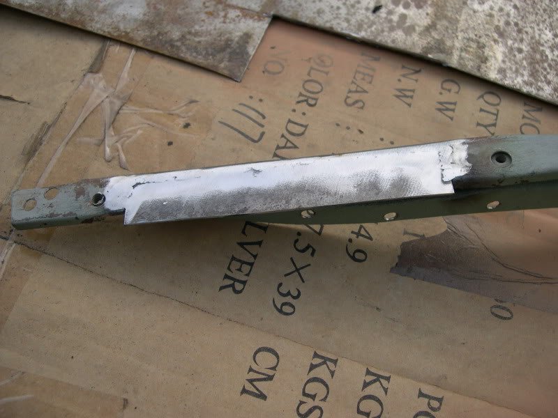

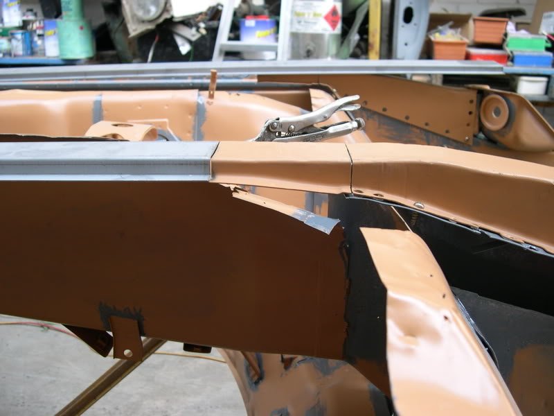

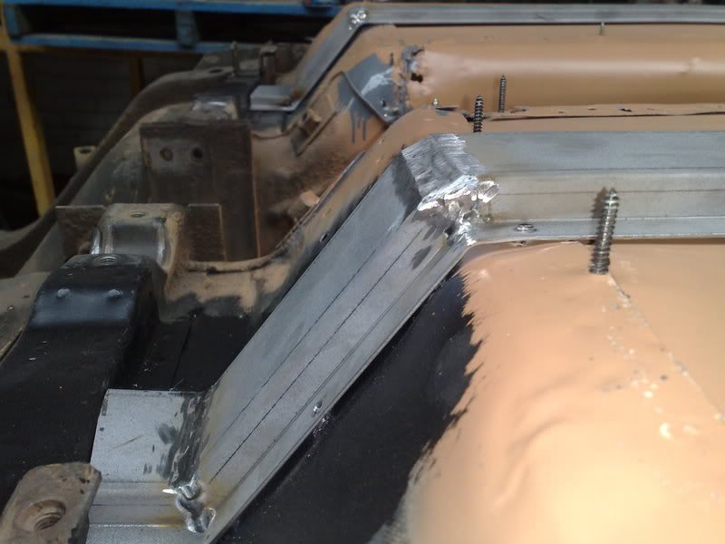

V8Datto Posted August 9, 2010 Author Posted August 9, 2010 New rails were bent up copying the original size and shape but in thicker steel Also extended to the rear chassis Everything screwed first to make sure it all fits together Fix up foot wells Quote

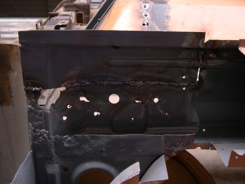

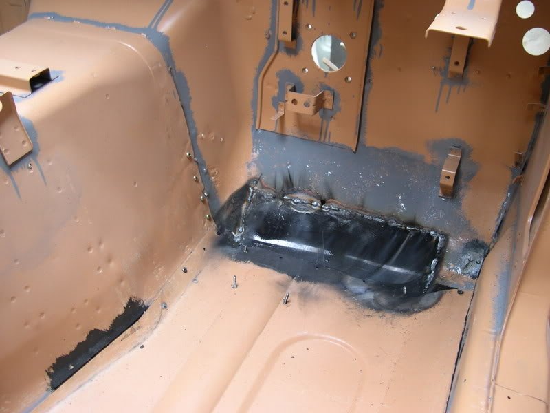

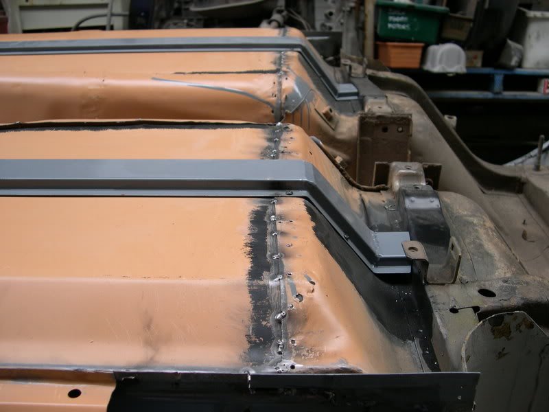

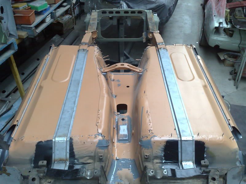

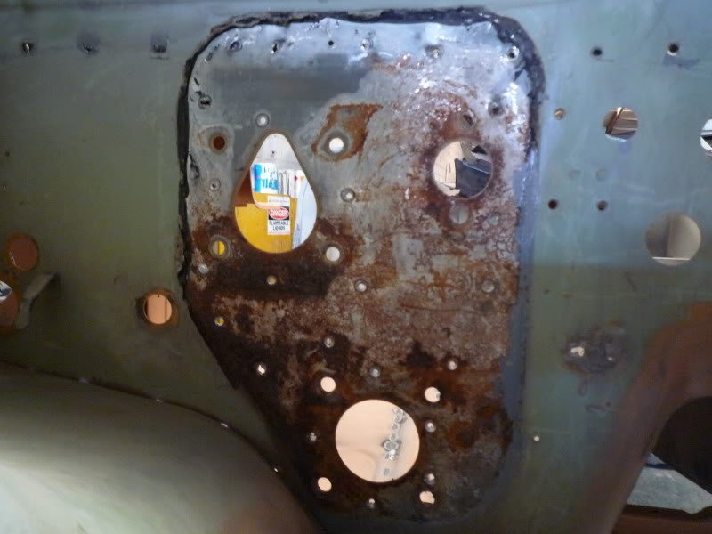

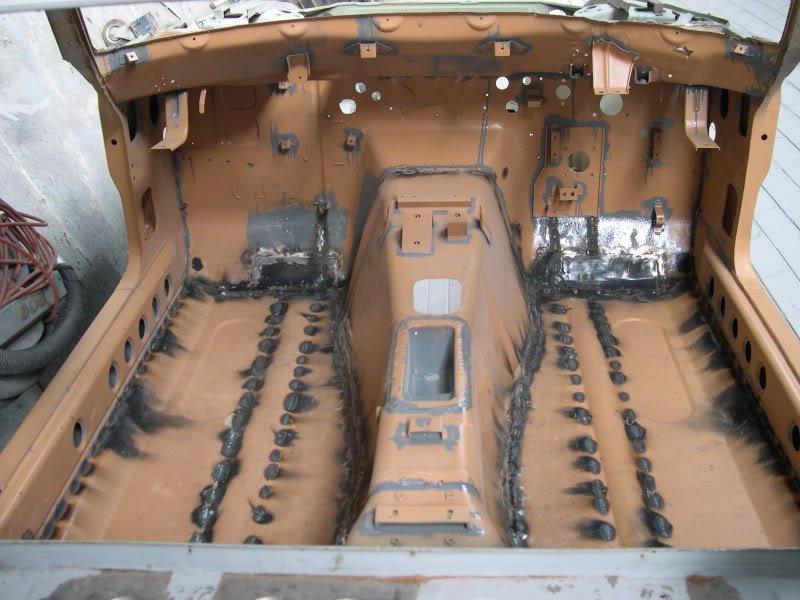

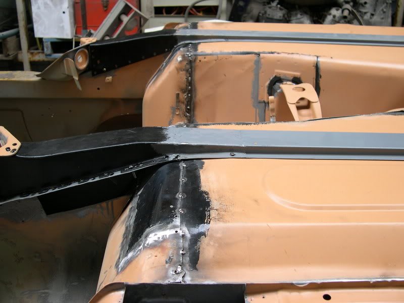

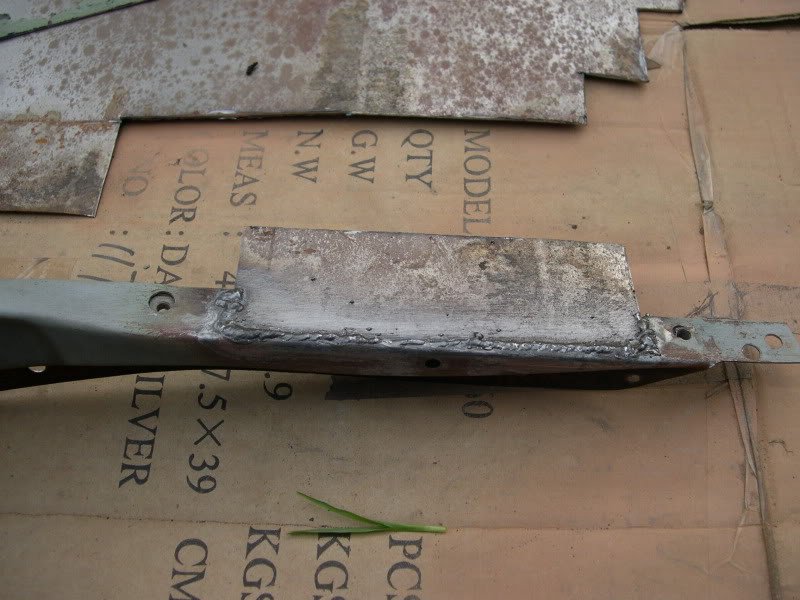

V8Datto Posted August 20, 2010 Author Posted August 20, 2010 I removed both seatbelt plates before the trip to the sandblaster which left some holes so I made up some replacement parts from flat steel, I welded up the completed chassis rail and painted, floor tacked in place Seam welded leaving the tunnel edge for final adjustment and trim Quote
Scoota G Posted August 20, 2010 Posted August 20, 2010 That's the ticket, great work with the Chassis Rails. Quote

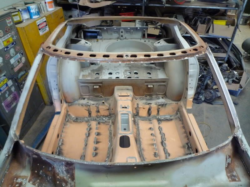

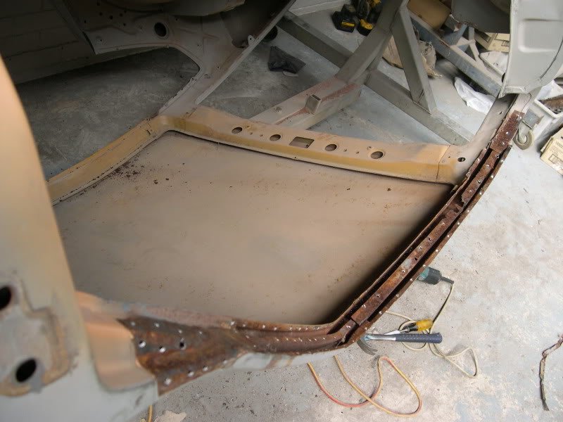

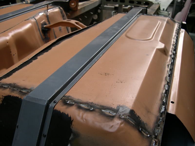

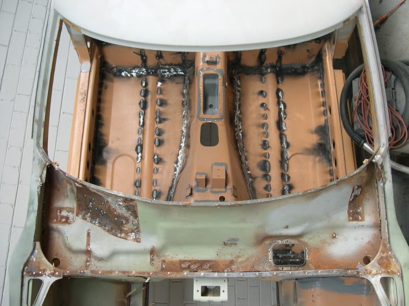

V8Datto Posted January 28, 2011 Author Posted January 28, 2011 Update floor to tunnel welded rails welded Quote

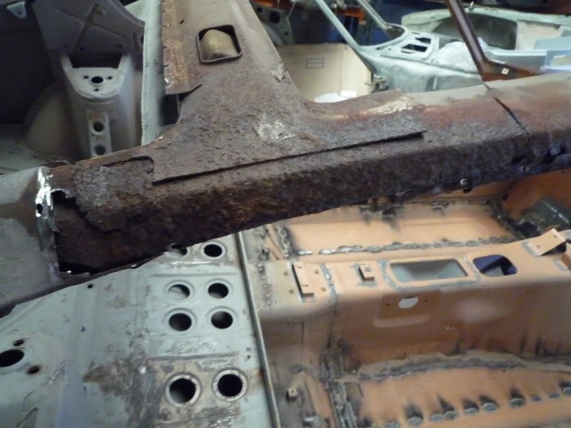

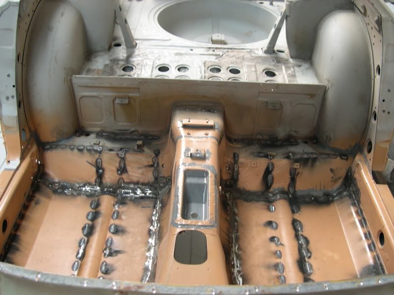

V8Datto Posted January 28, 2011 Author Posted January 28, 2011 Now that the floors were completely welded and the shell had some strength back it was time to start removing more rust affected areas, Quote

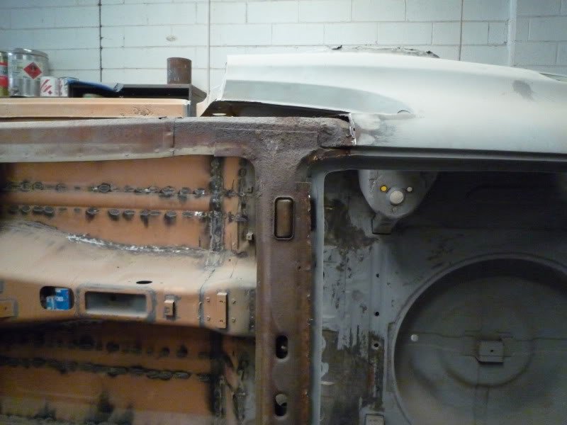

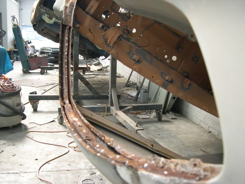

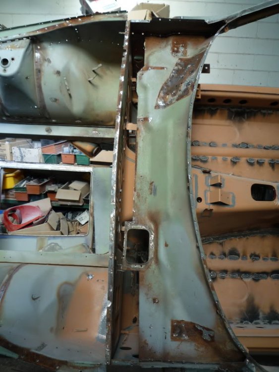

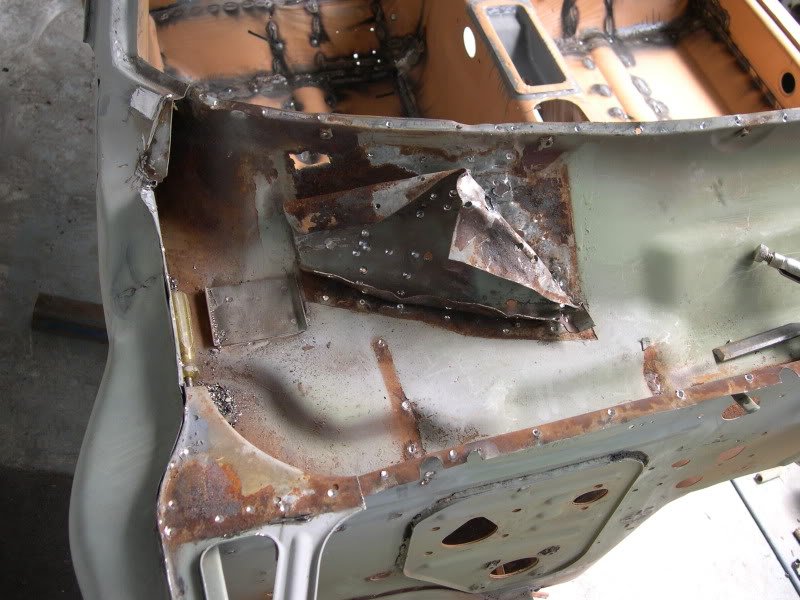

V8Datto Posted January 29, 2011 Author Posted January 29, 2011 Drip rails were removed to find more rust Quote

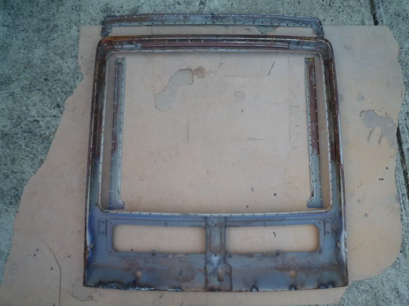

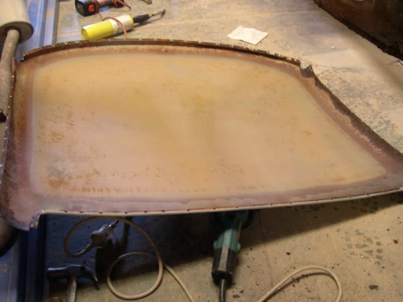

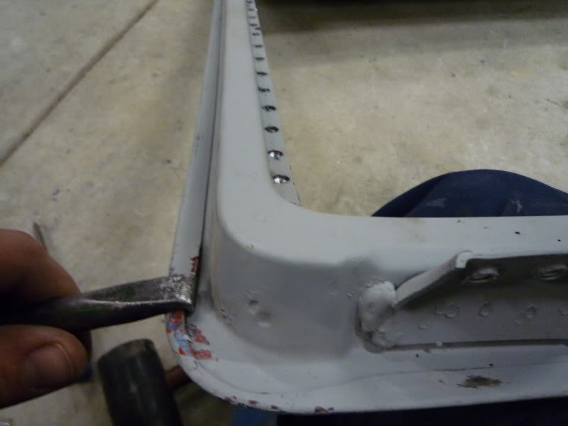

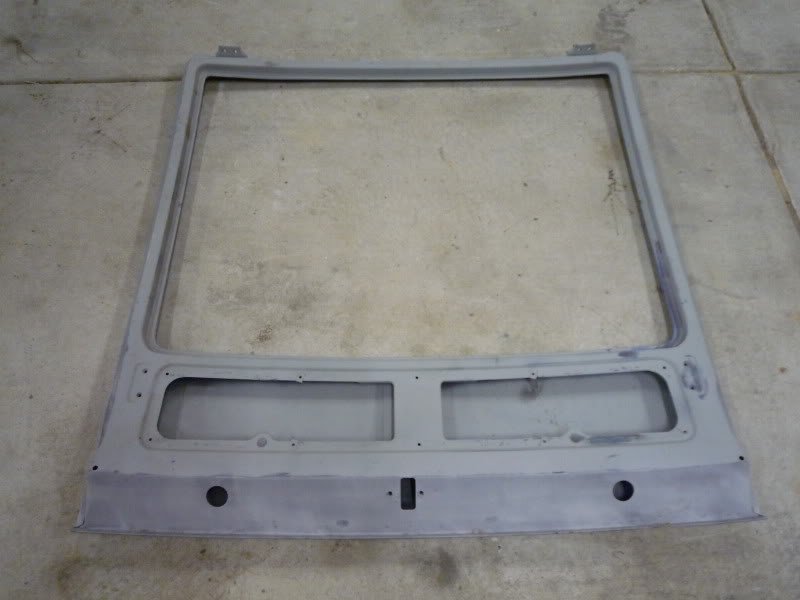

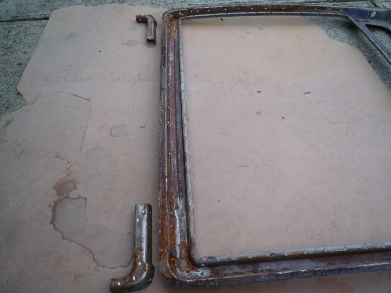

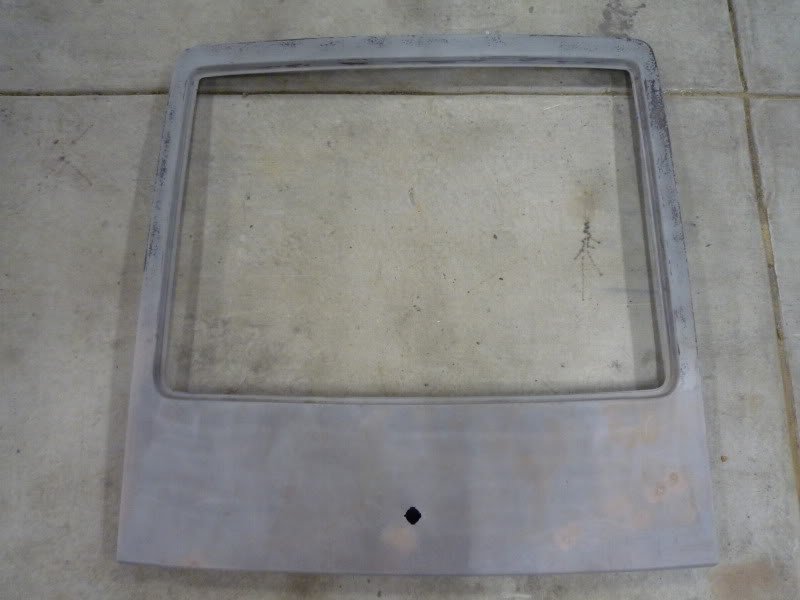

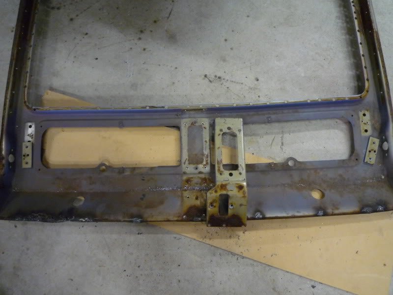

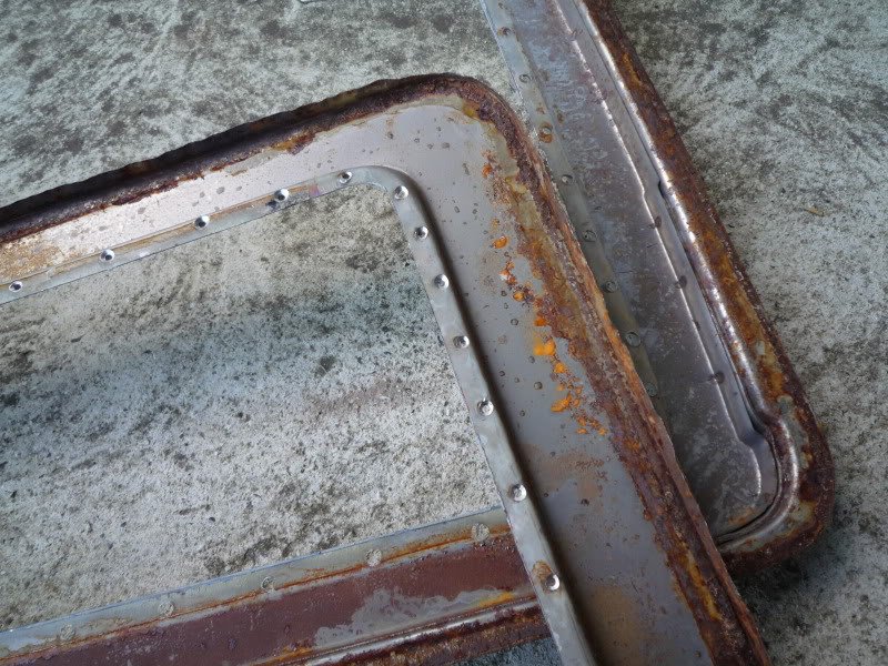

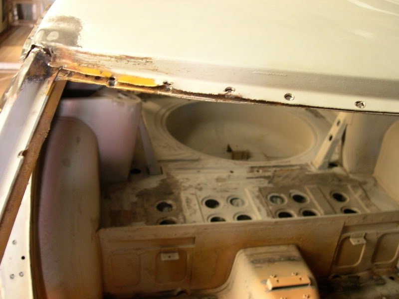

V8Datto Posted January 29, 2011 Author Posted January 29, 2011 Rear hatch looked ok with no rust showing but I decided to pull it apart and do it aswell worth it, most of the inside of the hatch looked like bare steel Quote

V8Datto Posted February 5, 2011 Author Posted February 5, 2011 Yeah drilling out spot welds is relativity easy but you only get one chance of fixing the problem (of rust), because once re-welded it is incredibility difficult to get apart again, the rear of my car had been repaired before and dam was it hard getting the welds apart. almost destroyed the panels And Simon the plan was to turbo the Toyota V8 but Victoria's rules are a bit grey atm I think 2.8L is the largest turboed conversion that is allowed in a 240z Problem is I'm going for club reg so I'm not sure if I have to follow Vicroad's rules or not, I'd rather a nissan turbo six in there anyways, keep it in the family Quote

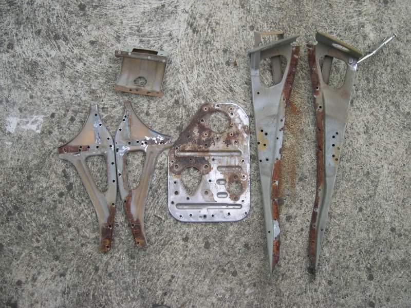

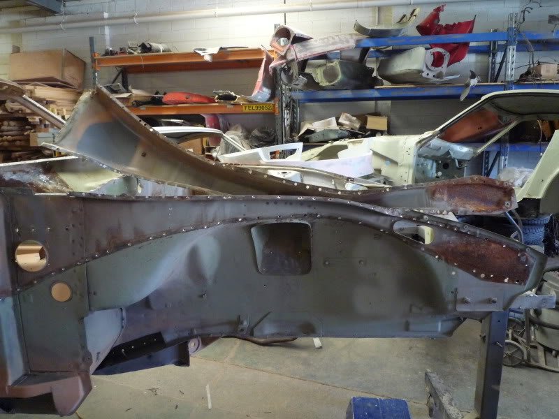

V8Datto Posted February 5, 2011 Author Posted February 5, 2011 Removed more parts from engine bay brake booster/clutch support randoms rebuilding p/s front guard support (on the very right in above picture) Quote

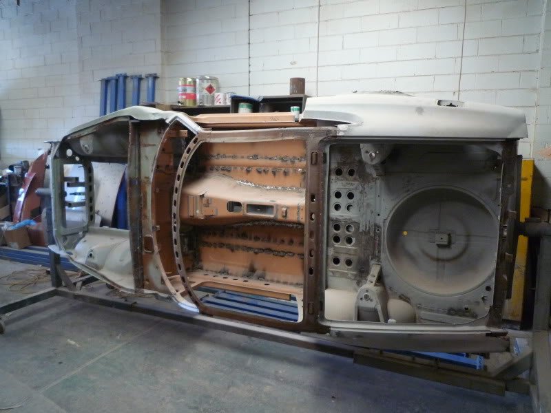

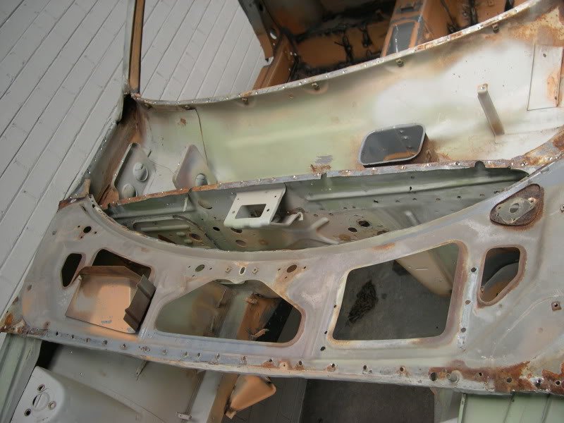

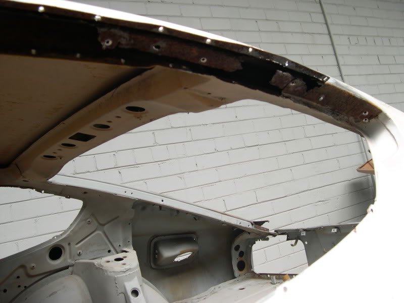

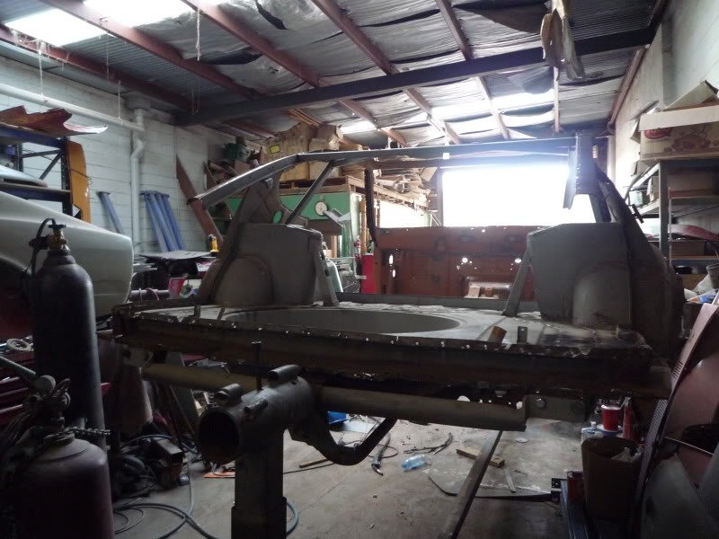

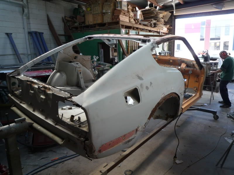

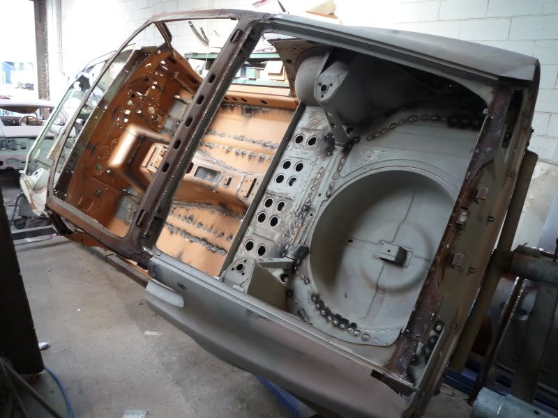

V8Datto Posted February 8, 2011 Author Posted February 8, 2011 So after seeing up behind the drip rails it was decided that the roof skin had to come off... dam Apart from the roof skin coming off so easy I was very surprised at how heavy it was once removed Quote

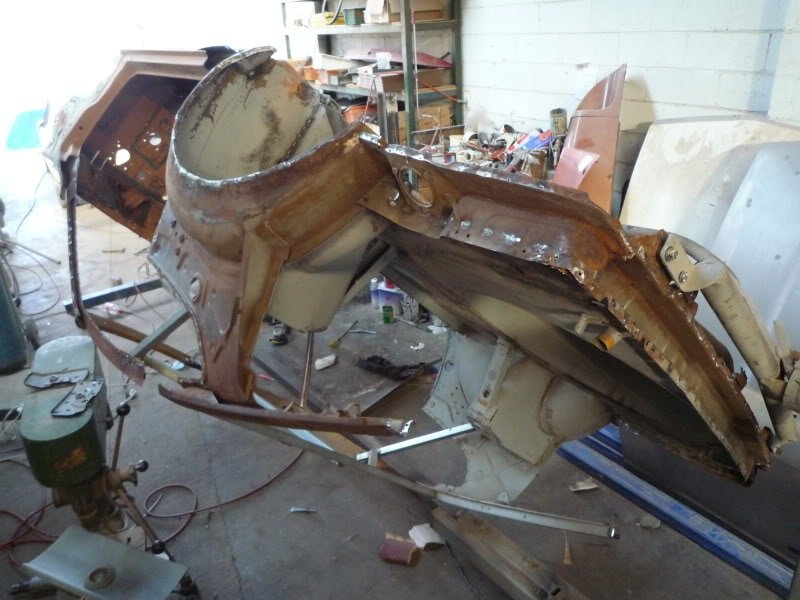

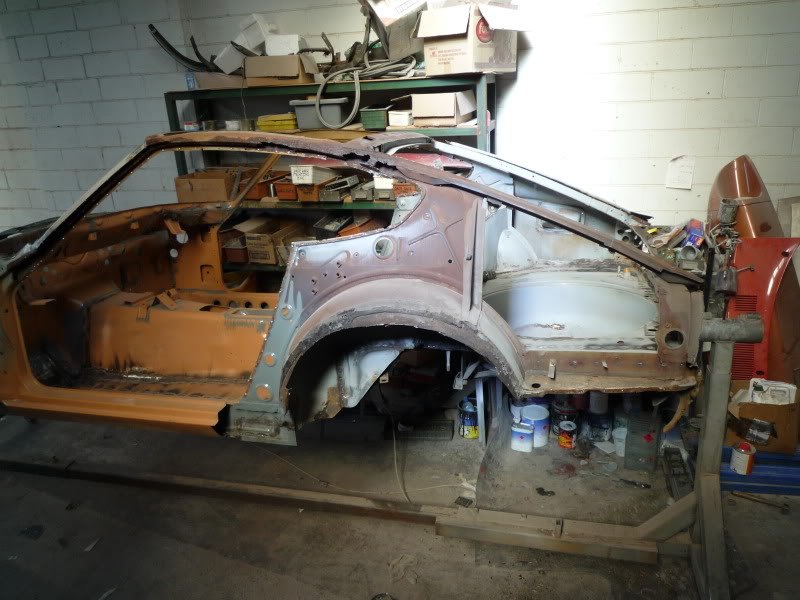

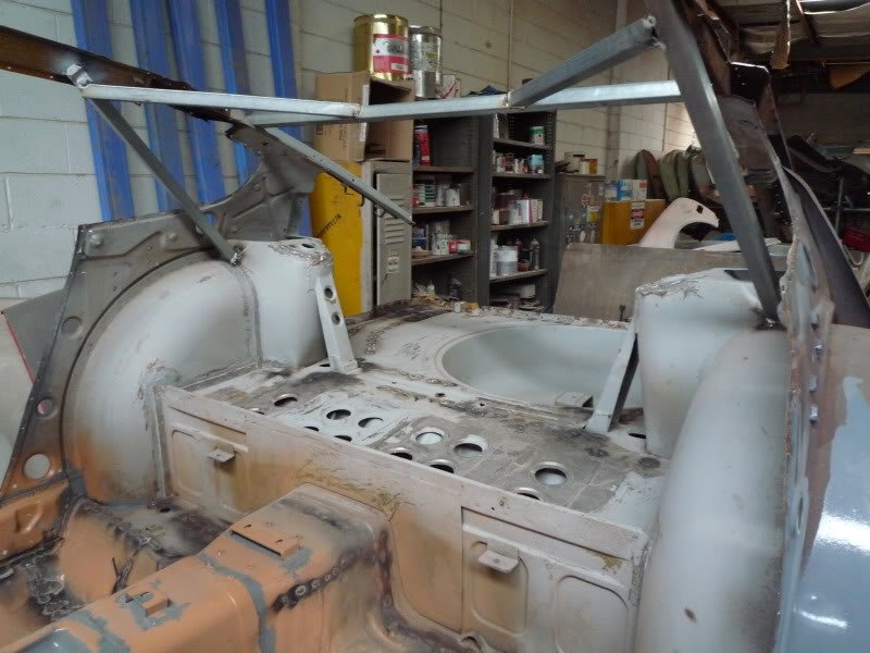

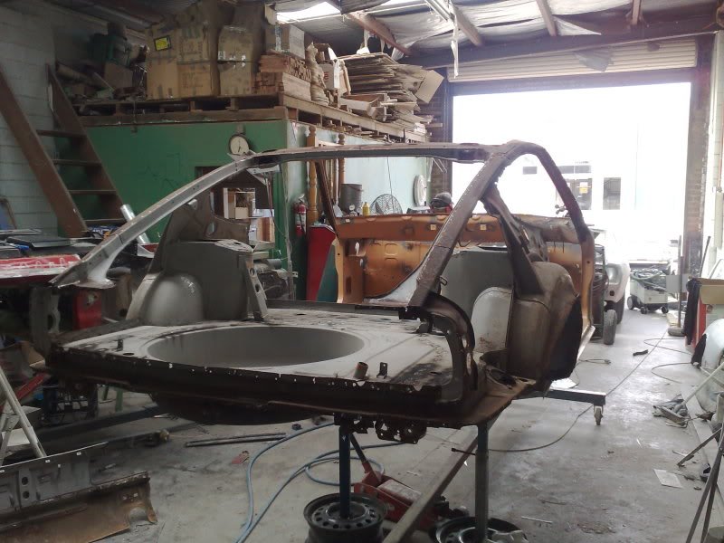

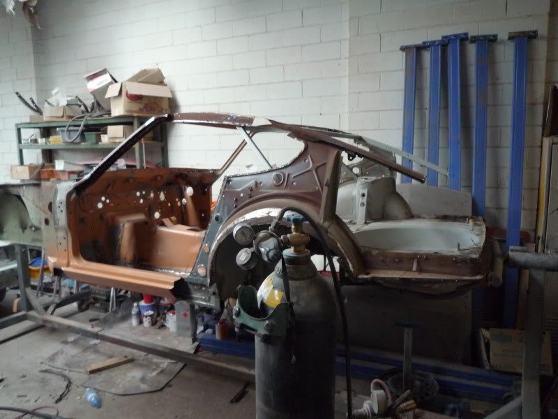

V8Datto Posted February 17, 2011 Author Posted February 17, 2011 Front sections removed Rusty areas of wiper area removed It was finally decided that the rear guards would need to come off as well, No point going this far and leaving them on The rear tail light panel was also removed Just when you thought you couldn't remove anything else the support for the rear hatch was removed and replaced with steel to keep everything in the same place Definitely a low point in the build. Looking more like a few pieces of steel than a car, but on the plus side it can only get better Quote

peter mc Posted February 17, 2011 Posted February 17, 2011 wow you need a medal for bravery that incredible good to see Quote
Brabham Posted February 17, 2011 Posted February 17, 2011 Holy Moly!!! Full points for thoroughness. I have heard of lightweighting cars but this time you have gone too far... Perhaps the rust free zed is akin to finding the holy grail, I think you might be on your way to finding it. Make sure you keep the chassis well supported, it is looking pretty flimsy on that rotisserie! Good work, keep it up. Quote
