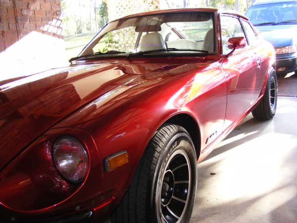

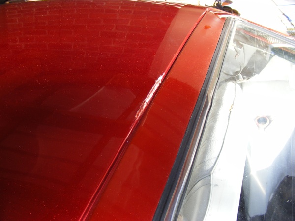

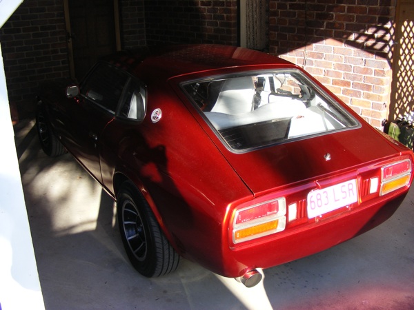

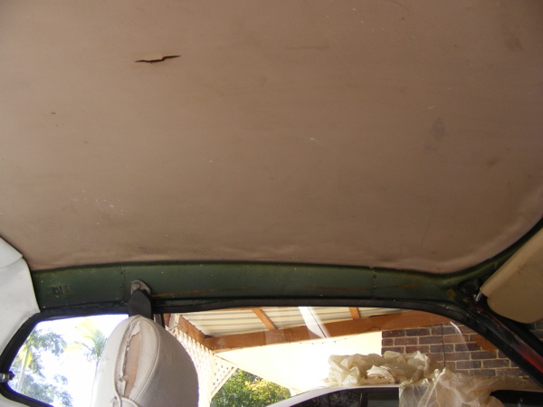

BobsYourUncle Posted June 18, 2010 Posted June 18, 2010 Well, I've been hanging around here for a while, so I figure it's time to post some details of my car and plans. I've had it for about a year now, but haven't done much do it yet - I've been busy getting married and trying to finish my PhD - maybe starting a journal thread will get me moving. Like the thread title, the car's a 1974 2+2, auto (soon to change), L28 with N42 head and flat-tops (also soon to change ). The body seems pretty straight, although the rear hatch doesn't sit right and rubs against the roof when opened (see pics), and the doors don't seem to be quite right (the windows at the top front seem to be a bit to square, if that makes sense). There's a scratch in the windshield from the wipers (which i think is too deep to patch up). It also has no front bumper or mounting for the front number plate (does this usually screw onto the bottom of the grill?). Mechanically it runs pretty well. The interior needs work - the dash is capped, the tacho doesn't work, and while the door cards and seats are ok (just need re-covering), it's missing roof and support sections. Parts of an aftermarket aircon system are there, but not working (compressor, some piping, condenser? at the passenger's feet, not sure what's behind the dash). The interior will probably be the last thing i do. Plans are: - manual conversion - I have most of the parts, just a few left. - electronic ignition - new tacho (i think that's the problem) - new headlights - headers and new exhaust - triple dellortos (I'm currently getting in trouble for leaving them sitting around on the dining room table) - brakes - hilux front discs, and probably rear discs too - front bumper and spoiler - interior work - ... I'm sure it'll never stop... Anyway, I'll probably start posting some more now, asking some newbie questions (I really don't know what I'm doing, but I want to learn). Quote
Quandary Posted June 18, 2010 Posted June 18, 2010 Love the colour. Are you going to stick with it? It's too bad the hatch wasn't put back on in perfect position. Quote
stevo_gj Posted June 18, 2010 Posted June 18, 2010 Photos of triples IMO! Looks like a great start, you got it registered? Quote
maddos Posted June 18, 2010 Posted June 18, 2010 Looks like a good start has been made on it already. Hope the PO did a good job of it. Your number plate hangs from the front bumper. What chassis number is it? Quote

Zedsabbath Posted June 20, 2010 Posted June 20, 2010 Looks like the original shims are missing from behind your hatch door hinges Bobs, if they were in place the door would sit back and avoid scraping the paint...Have fun restoring the car, looks ok Pete Quote
BobsYourUncle Posted June 20, 2010 Author Posted June 20, 2010 Looks like the original shims are missing from behind your hatch door hinges Bobs, if they were in place the door would sit back and avoid scraping the paint...Have fun restoring the car, looks ok Pete You're right, checked my manuals this morning. I'll have to find some replacements. Thanks. Quote
Stivva Posted June 20, 2010 Posted June 20, 2010 The paint looks fantastic! Also like the white interior, but I bet its hard to clean. Quote
