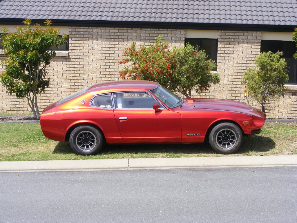

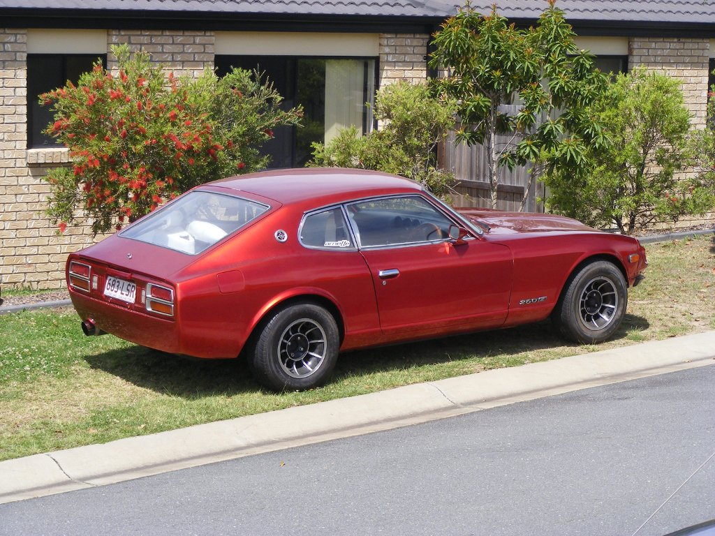

BobsYourUncle Posted September 26, 2010 Author Posted September 26, 2010 Cleaned out the garage today, and took the change for a couple of photos. With the sun out (and from a distance), you can hardly see the (many) imperfections (or the fact that it desperately needs a clean ) Speaking of the cleanout, is there any market for auto transmissions, or should I just dump it? Quote
