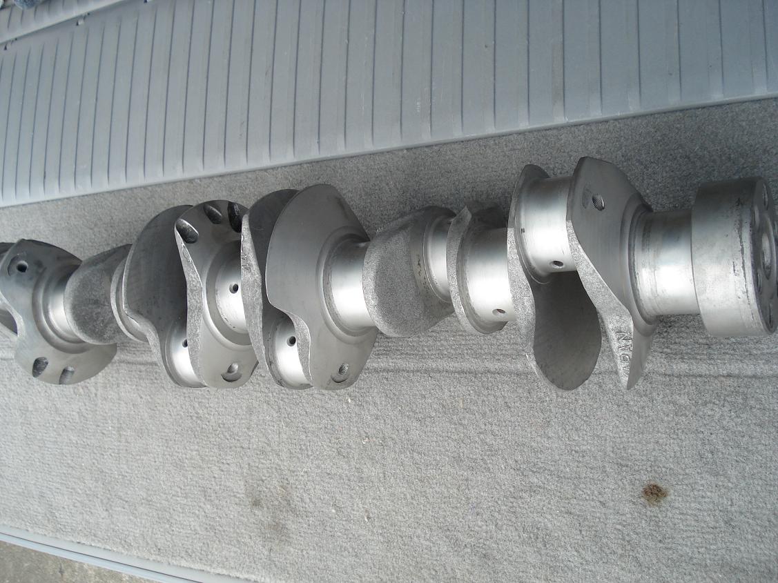

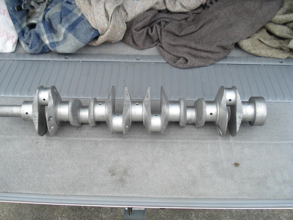

dat2kman Posted June 12, 2010 Share Posted June 12, 2010 here's an "after" shot Quote Link to comment Share on other sites More sharing options...
dat2kman Posted June 12, 2010 Share Posted June 12, 2010 took approx 3kgs off then add the kgs that came off slugs/rods/flywheel/balancer total reciprocate/rotate weight reduction approx 14kgs. Quote Link to comment Share on other sites More sharing options...
Aaron Neubauer Posted June 13, 2010 Share Posted June 13, 2010 I have no idea how much the machinist took off my reciprocating mass but it won't be as much as Jason's, shit, I'm still using a steel flywheel! Knife-edged, balanced and nitrided (talk about an increase to surface hardness!!)... Quote Link to comment Share on other sites More sharing options...
