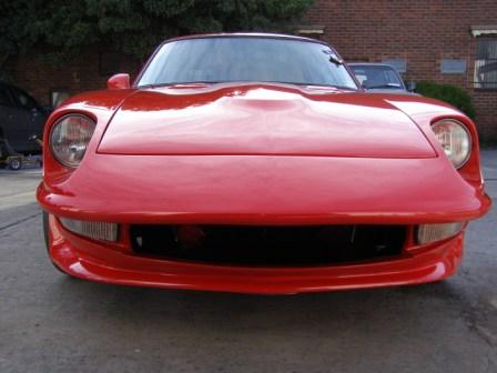

stevo_gj Posted May 27, 2010 Author Posted May 27, 2010 I don't think so Alan, pretty sure if the wind tunnel shows its not an improvement then its not. With unscientific testing I think sometimes it might be a case of people see what they want to see, not trying to offend anyone with that just saying it's inconclusive unless you take a scientific approach. However that is a good point that the Gnose wouldn't exist if there were no benefits. Therefore I would say that either the benefits of the Gnose are not Cd related, OR.. they only had a Gnose car at stock ride height in the wind tunnel testing - maybe the Gnose doesn't make a noticeable difference until you lower the car. Quote
HS30-H Posted May 27, 2010 Posted May 27, 2010 I don't think so Alan, pretty sure if the wind tunnel shows its not an improvement then its not. With unscientific testing I think sometimes it might be a case of people see what they want to see, not trying to offend anyone with that just saying it's inconclusive unless you take a scientific approach. Sorry, but the HybridZ wind tunnel testing was full of holes. In the case of the 'G-nose' tested, it wasn't anything like the proper OEM parts and therefore doesn't say anything about the proper OEM parts. The details inside the radiator duct are quite important, and many of the parts you can't see have an effect. Many so-called 'replica' kits don't actually replicate the details of the original factory parts...... One of the other things that people seem to overlook is that the Fairlady 240ZG production model was simply used to homologate some of the parts that were used in racing, and that the factory always intended the 'Grande Nose' to be used with an air dam / front spoiler when actually raced. There are mounting holes on the OEM parts for this very purpose, and there were several different evolutions of air dams and spoilers used - with the later evolutions getting lower and wider, and matching with the extra wide Overfenders. And what was going on inside the rad ducts of the works circuit race cars is a salutary lesson in effective air management, too. If anyone doubts that such measures were effective then I'd like to hear their reasons. Sorry, but for me the HybridZ wind tunnel testing seems to have revealed nothing that wasn't already being addressed with these cars 40 years ago. Quote

620Z Posted May 28, 2010 Posted May 28, 2010 Yeah I read Stevo's comments and didn't want to buy into an argument but given the comments and support of the G-Nose I will. And this might be the first time Alan (260Coupe) and I would agree. But I think the G-nose combined with a good air dam make a big difference to a Zeds handling, down force and aerodynamics. Disregarding the wind tunnel reports logic would tell you that if you extended the bonnet down nearly 8inches to the level of the front bumper bar. Then you are obviously narrowing the wind in take under the bonnet and into the radiator area. I can tell you that at 250klm my car hugs the road far better than if it didn't have one. Refer pics. Steve compare the pictures of the front of my car to your avatar picture. There is a massive difference in air dam clearance which must translate to improved performance. Quote
