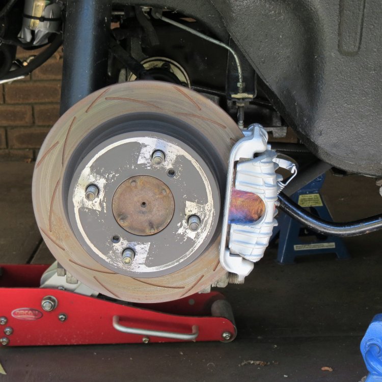

Grandad Posted April 24, 2017 Posted April 24, 2017 Hi All When I looked at the inlet manifold next to the head recently I realized just how crap it looks compared to the head and that's before looking at the rusty carby linkages that are welded in place. In putting this car back together I can honestly say there has only been one cheat and that is a bolt I couldn't remove to have plated so I painted it, here comes cheat no two. I asked Headtorque how they achieved the bright finish on the repaired head and to my surprise it is a cheat so I've copied it, first was a thorough solvent wash. Then the cheat or rather cheats. I'm not unhappy for a moment with the result. Cheers Dad Quote

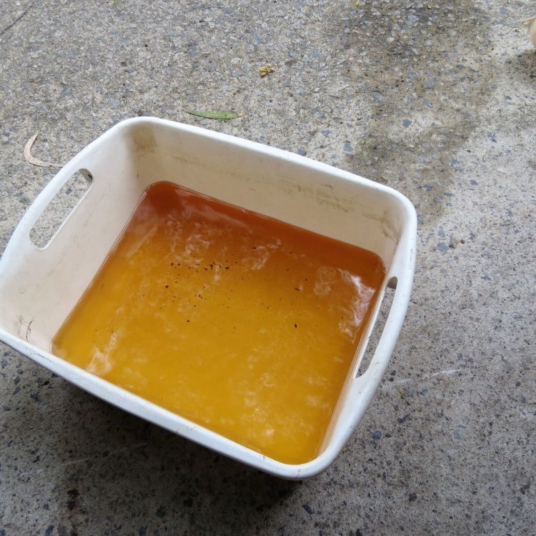

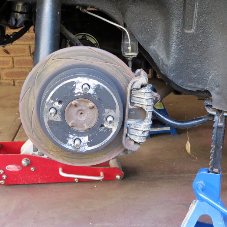

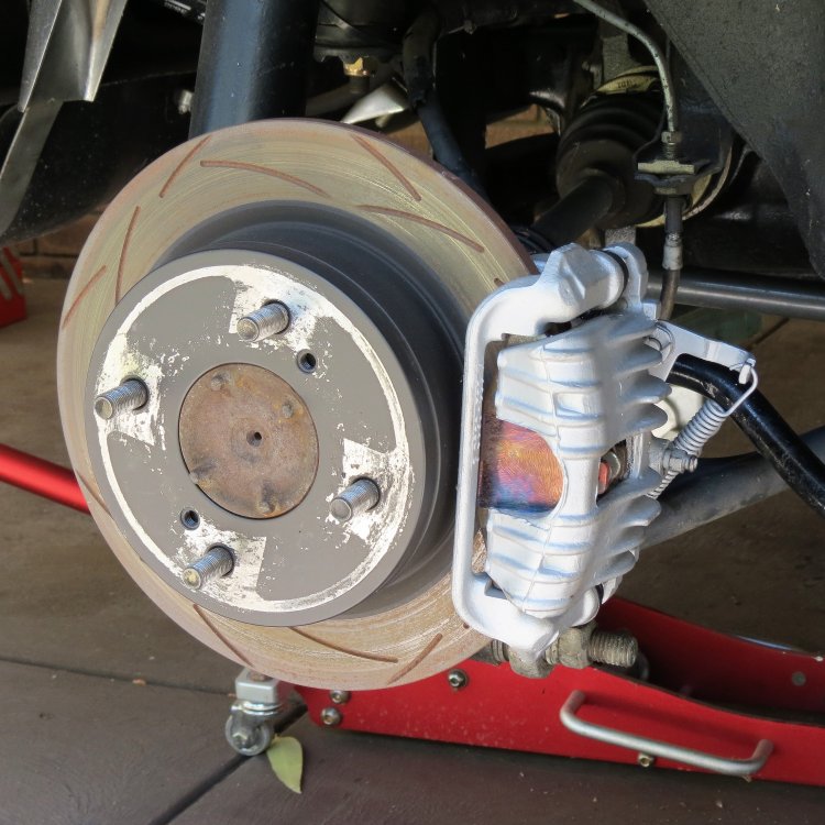

Grandad Posted October 5, 2017 Posted October 5, 2017 Welcome Grandad! Love it. Jeff Thanks Jeff, I'm loving it too, we're heading over there for Xmas so should be great, interestingly Whittie has requested I get an international drivers license and bring my CAMS one as well, he's not letting on but I get the feeling there's more than a family get together planned. Hi All The motor came out of the Zed last December for a bit of a tickle up and some head work I made the mistake of telling Tuss that with Whittie absent it wasn't urgent but that's now almost a year ago so there is a bit of pressure to get it going again so the motor should go back in tomorrow. A few weeks ago I noticed a pool of fluid by the drivers side rear wheel which looked like brake fluid and a quick check of the master cylinders confirmed it, my first thought was that it was a bit weird as I clearly recall reconditioning the rear calipers not all that long ago, turns out not long ago was actually ten years ago. This is the offending caliper Here's the proof This treatment wouldn't have helped Fixed The last time Whittie was here we did a couple of night events and had some trouble blowing fuses in the HID headlights with them ultimately dying at the night drags and Whittie driving home with parkers only, turns out the HID drivers died we suspect from over heating as they were mounted in the engine bay so we sourced a new set and I mounted them today on the opposite side of the inner guard so they are now under the guards just below the lights, hopefully that will fix them. The original mounting point in the engine bay. The new under guard mount. Cheers Grandad Quote

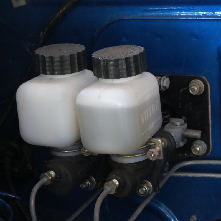

Whittie Posted October 19, 2017 Author Posted October 19, 2017 (edited) Time to fix that brake bias. It's been so long since I bought the brake pedal kit that Jon Coffey (Beta Motorsports) has not only gone out of business but sadly passed away. We've only used them in anger a handful of times too Edited October 19, 2017 by Whittie Quote

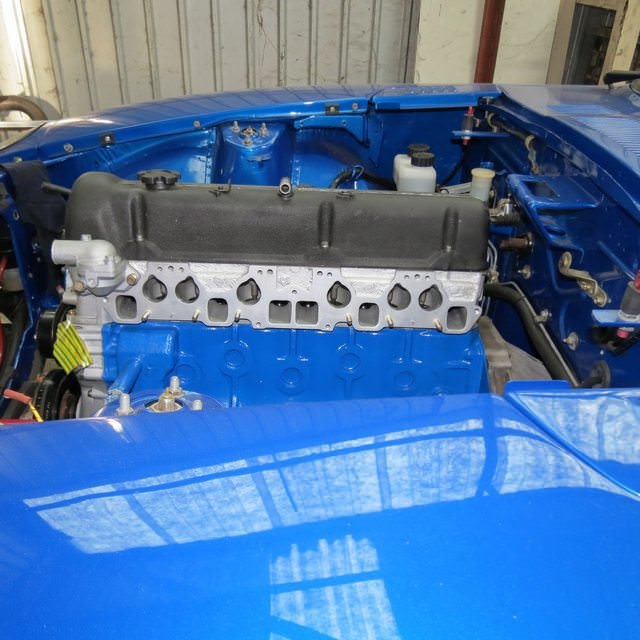

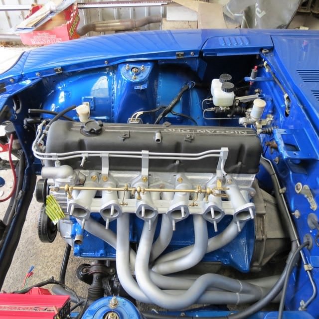

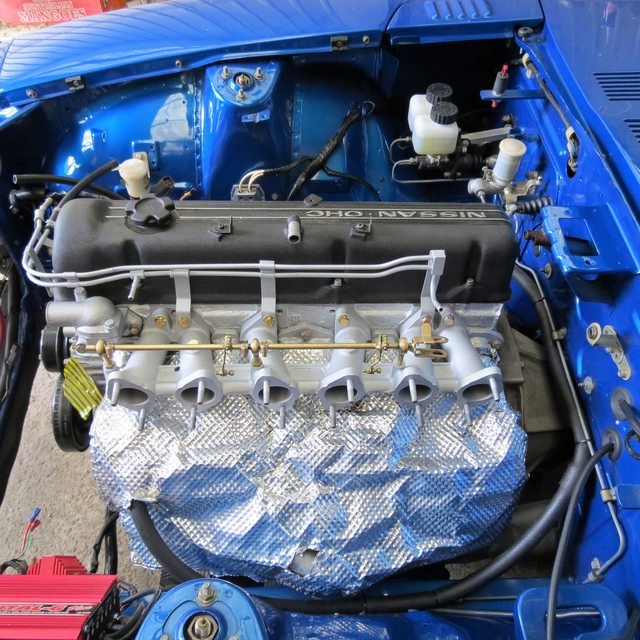

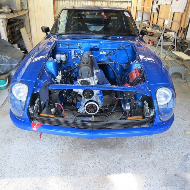

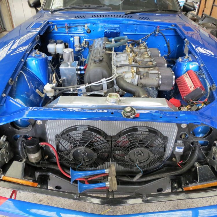

Grandad Posted October 25, 2017 Posted October 25, 2017 Hi All Well it's almost a year since the engine was removed for a tickle up and it's finally back in, that plywood box next to the car is a caravan build that has occupied my time for the last couple of years and is finally approaching completion, it has removed much of the urgency from the Zed. Not sure the colour matched block was intentional but it looks good. These things look so good it's a real pity to have to protect them from the leaky Webers. I'm on a roll the van can wait I need to hear this making it's crisp L28 noise again soon. Cheers Grandad Quote

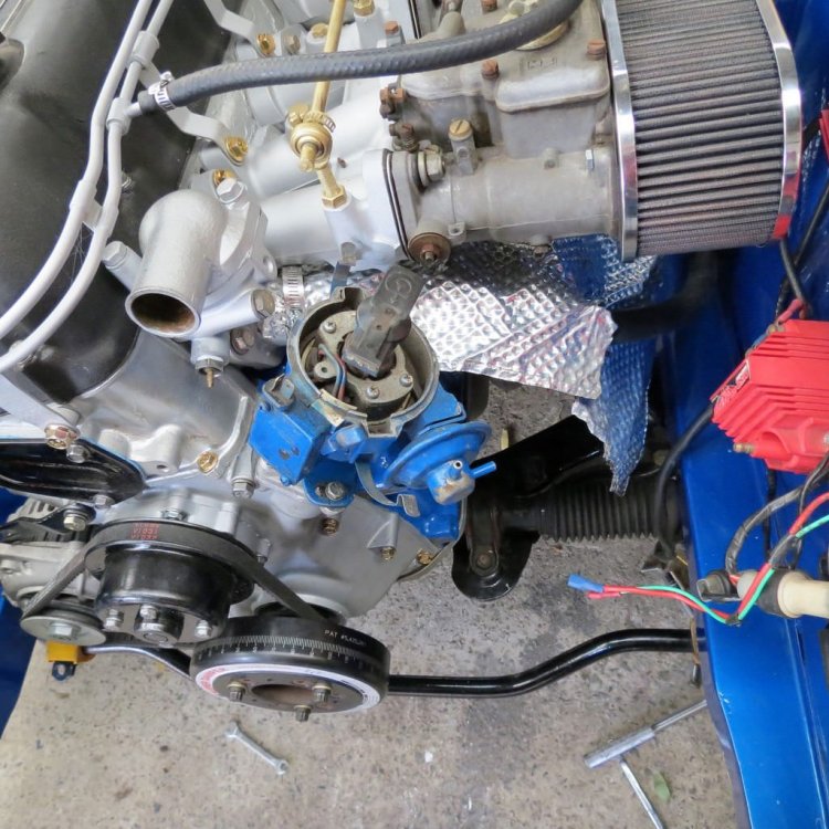

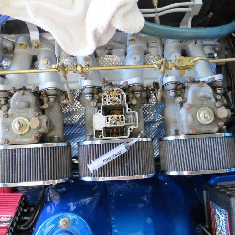

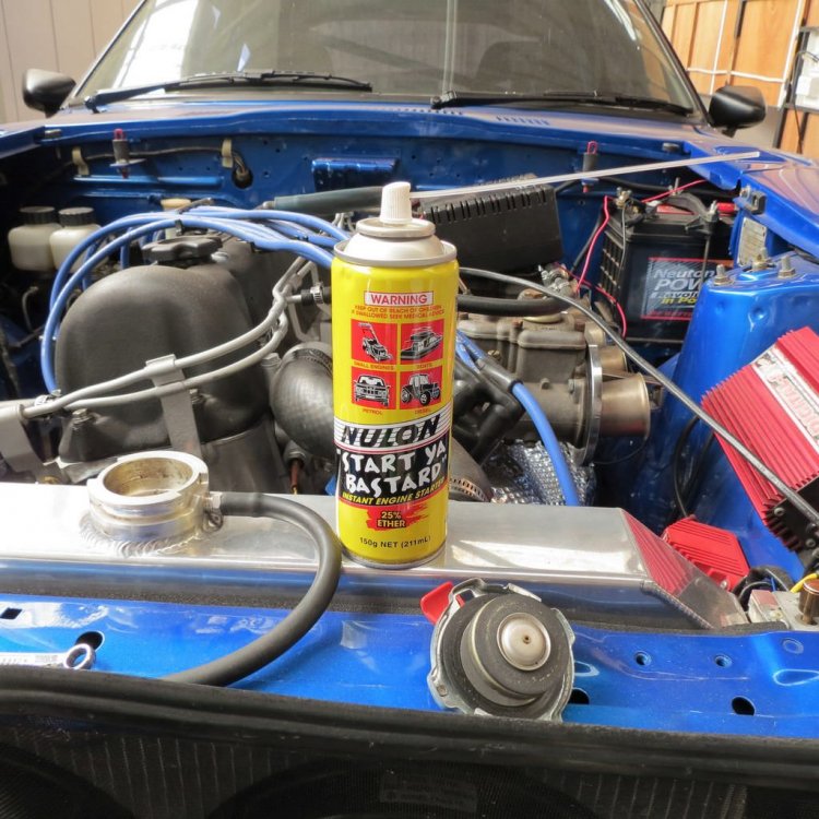

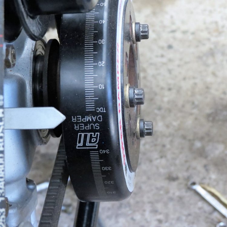

Grandad Posted October 27, 2017 Posted October 27, 2017 Hi All I'm being a bit self indulgent here but I'm really enjoying being a new first time Grandad and just received some pics of my new born grand daughter that clearly show some of the influences she will have in her life. Will I be an equestrian? Will I do motorsport? Hmm, horses and horsepower! Enough of my self indulgence, I had another break from the van today to focus on the Zed and fitted the carbies and ancillaries to get it going but from my experience last time of the oil pump/distributor drive being incorrectly installed I decided to check it before installing the radiator and sure enough with the crank on no1 tdc it was one tooth out so would have been delivering spark to no5 when it was required by no1 which is clearly not going to work. Fortunately with good access it was relatively simple to drop the front sway bar to remove the oil pump and correctly position the drive. All that's left for tomorrow is to fit the exhaust and battery and fire it up. When I removed the oil pump I noticed the oil galleys were filled with a white grease that looked and smelt like Vaseline Petroleum Jelly, I've never seen that before and considered to be odd so I removed what I could without taking the pump apart. A google search revealed that it's an old school way of priming oil pumps in new dry engines to prevent cavitation and is actually recommended by some engine manufacturers, personally I prefer to crank the motor without load to get oil pressure before firing, looks like this time there will be a bit of both. Cheers Grandad CBR Jeff 1 Quote

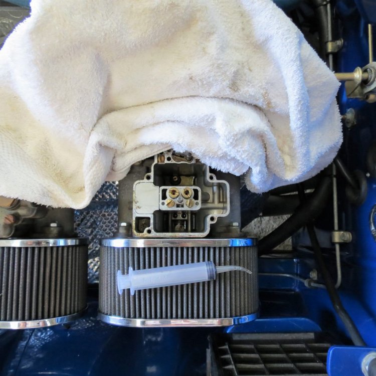

Grandad Posted November 9, 2017 Posted November 9, 2017 (edited) Hi Enzo We are clearly the same generation I remember STP only too well, in my youth when I was destroying FJ to FC Holdens at about the same rate as they were produced they all had STP added and as to prove STP's worth the engines all outlasted the cars. Let's not forget the STP acronyms. Still Thoroughly Pissed. There was a period in my life that applied. Stamp Out Teenage Pregnancy. A few of my friends tripped up on that one. I find it rather curious that STP still exists in our current hi tech world. Hi All Not being familiar with the Vaseline option I decided to crank the engine with spark plugs removed until I achieved oil pressure and as expected the engine spun noticeably faster once everything was fully lubricated. I was now ready to fire it up but unknowingly the damage was already done, I hadn't drained the year old fuel and the carbies were now full of it and the engine wouldn't fire even with half a can of Start Ya Bastard, that stuff is so appropriately named. I eventually decided to pump the tank dry and replace the fuel but not wanting to remove the carbies I removed the tops and sucked all the fuel out of the bowls, that possibly left some in the accelerator pump chambers but I decided that it would clear with a few stabs of the accelerator pedal. With basically a brand new engine I decided to back the timing of a touch so not to overly stress the engine on fire up, but because I haven't played with this thing for so long I had completely forgotten that to allow for hi comp engines the MSD Digital Ignition System automatically retards the spark on start up so it effectively had double retard and that's before you include me. After a few days of flattening and recharging the battery, walking away for sanity sake, calling out the name of the product that didn't want to work, I finally twigged and set the timing back to normal, next try was met with a huge backfire which I took as a sign of success with unburnt fuel being cleared from the exhaust, next try was successful and oh what a beautiful noise. I have always considered the 98ron fuel we use to have a green tinge to it so I was shocked to see the color of the syrup that came out of the tank, for comparison I later put some fresh fuel in the same container for comparison. Syringe to the rescue. Hopefully I won't get caught with old fuel again. Cheers Grandad Edited November 10, 2017 by Grandad Quote
