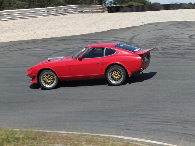

zed240au Posted October 19, 2013 Posted October 19, 2013 Thanks for that utube clip peter wish i could brake as late as that car is Thanks Freddie love your work full 3 seconds quicker at symmons plains today 1.03.55 very happy can hold car in 5th gear all the way to braking point extra 30km speed and car feels stable Now what can i do for more traction wheel spinning out of pit and coca cola corner Think i need to check lsd clutches need a shim up im thinking Mick Quote
Riceburner Posted October 19, 2013 Posted October 19, 2013 Nice result Mick, three seconds is massive! How does the splitter attach? Quote

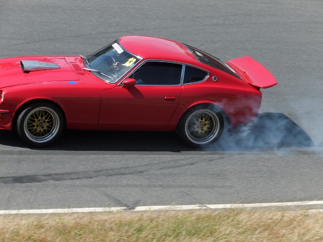

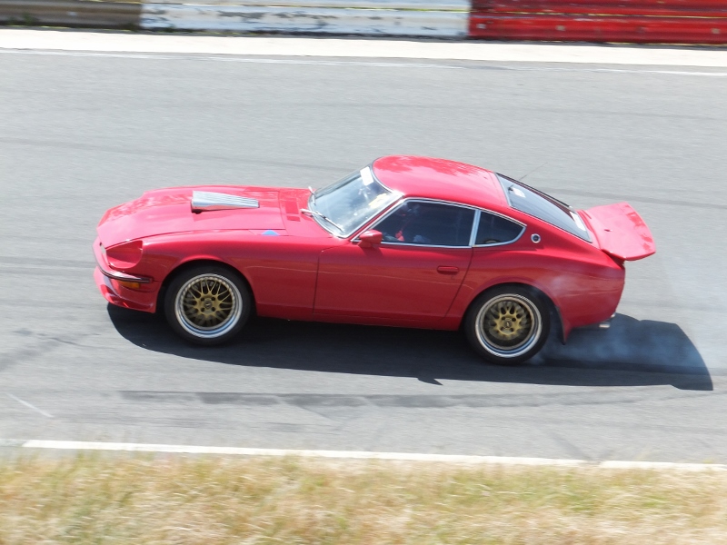

PZG302 Posted October 21, 2013 Posted October 21, 2013 Feck Mick, just because they're your wheels you can't abuse them like that!!!!!! ;D Quote
zed240au Posted October 23, 2013 Posted October 23, 2013 Garth the splitter simply slides into bottom of spoiler I put a bolt in each end and couple of screws in middle to stop it vibrating and lock it in place Did have to trim a little to clear my 18" wheels Come on Matt im babying those wheels compared to what u did with them lol Thanks for pics hodgo Mick Quote

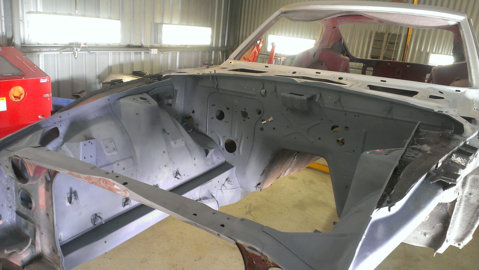

red76z Posted October 23, 2013 Posted October 23, 2013 Nice work Mick. Finally finished the under side of the Z. Time for paint and put back together. 2-1/2 years later. Quote

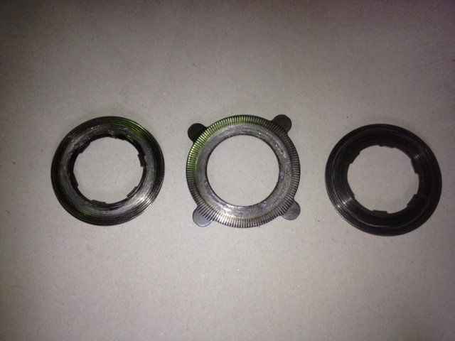

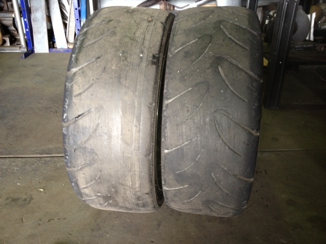

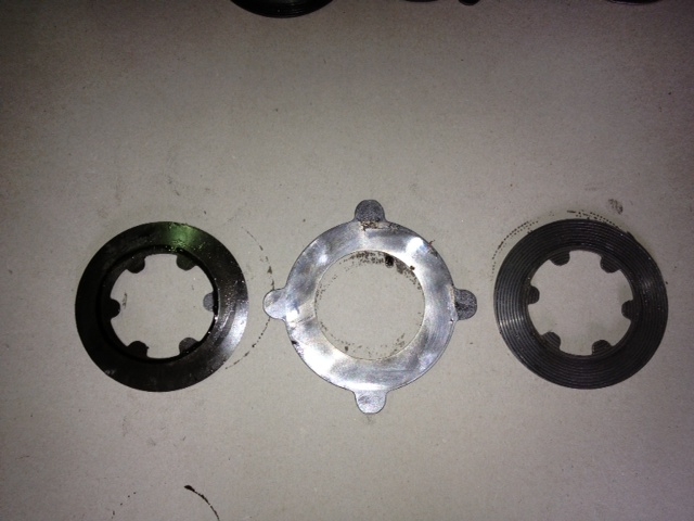

zed240au Posted November 11, 2013 Posted November 11, 2013 After last track day was pretty sure lsd was not working Left hand rear worn close to canvas was a good pointer Pulled diff out found my 4.3 diff was a poverty pack with only 2 clutches which now had no teeth and one was welded to spacer So guess ill be rebuilding it with 6 clutches and some good break away tension Next to pull gearbox out and check why it dont like staying in third gear Was hoping it was just the shifter i found was loose but tightening that up didnt fix it so guessing im up for a rebuild of the gearbox too Fun of going fast i guess Mick Quote

PeterAllen Posted November 11, 2013 Posted November 11, 2013 Mick - If you have fitted a GM motor why not fit a GM diff? I've got the drawings/templates. The axles are a bit of cost but if you can get the outer couplings made at 'mates rates' it is a once-off build. Quote

zed240au Posted November 11, 2013 Posted November 11, 2013 Have thought about changing to GM diff peter just worried about getting a 4.3 ratio which works so well with my set up But its in back of my mind for sure Should have checked this diff out earlier to see if it was a 2 clutch or 6 Will have to miss go kart track with zed and run the Wankel as planned Will have zed back together for hillclimb Hodgo im keen to see if I can improve first split too with both wheels driving might even stop Eric telling me to just ease the power on lol Come on down Gordo any reason for a road trip is a good one ill get a trailer on standby lol Mick Quote
