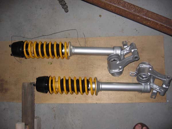

C.A.R. Posted August 25, 2009 Posted August 25, 2009 With 2+2's it makes it a bit tricky as there are no off the shelf coil-over kits available (to my knowledge). My suggestion is lowered King/Fulcrum springs & re-oiled wet legs (damper inserts) with ATF fluid. I did this to my old Bus & I regularly had people commenting on how stiff it was - but it wasn't harsh at all Quote

Moderators Zedman240® Posted August 25, 2009 Moderators Posted August 25, 2009 If you want a real firm ride, you may have to get springs made; Kings lowered heavy duty are only around 170-200 lb/in when you need approx 300lb/in and ready for the track with as Lurch mentioned heavier oil in the struts. A 22mm front roll bar and 16mm rear bar should be a good place to start. Then run around a track and have some fun! I had some springs made locally for around $300 for the four. With a another zed, I used a heavier hydraulic oil in the struts but with 350lb/in springs....let me say it re-adjusted some discs in my back while driving on the road.. You found bumps where you never thought they existed! Quote

260Coupe Posted August 26, 2009 Posted August 26, 2009 Another option is to order the standard replacement King springs (same rate as the lowered springs ) and then cut them down by approx 2.5 coils (adjust to suit ride hide and strutt tops) .........This will uprate them by around 30+%.......I measured mine at 220lb front and 200lb rear , with the KYB gas the ride is very firm yet not harsh, body roll is well controlled and with 1/2 deg neg camber, the zed will turn in well with little body roll............perfect for road and the occasional track day. This is a very inexpensive suspension mod with springs and shocks available for around $700...... and you can fit yourself if you are handy on the spanners ! Quote
PZG302 Posted August 26, 2009 Posted August 26, 2009 Another option is to order the standard replacement King springs (same rate as the lowered springs ) and then cut them down by approx 2.5 coils (adjust to suit ride hide and strutt tops) .........This will uprate them by around 30+%.......I measured mine at 220lb front and 200lb rear , with the KYB gas the ride is very firm yet not harsh, body roll is well controlled and with 1/2 deg neg camber, the zed will turn in well with little body roll............perfect for road and the occasional track day. This is a very inexpensive suspension mod with springs and shocks available for around $700...... and you can fit yourself if you are handy on the spanners ! Or get the springs made at the right height and rate. Unless you know what your doing cutting springs isn't a real good idea and in Qld anyway is illegal. I have run cut springs in a race car, but it was done by somebody who knew what they were doing and the rest of suspension was set up to suit. We only did it because we couldn't get a spring to suit low enough or stiff enough, ended up with a about a 4" drop from standard and a spring rate on the rear of around 900lb's on the rear and about 500lb on the front, not a nice thing to drive anywhere but the track, and even then crossing a white line gave me concussion the car was that stiff. Here's some reasons lifetd from a Pulsar forum... Cutting springs does a few bad things. 1. changes the spring rate of the spring (less coils effects how it works) 2. reduces the height of the spring which may cause it to not be captive at full droop of the suspension which could cause it to become dislodged and may result in a serious accident. 3. spring no longer properly locates in the spring seat as designed and can move, rub, and generally cause problems. Rubbing can lead to a spring seat failure. 4. springs are engineered to be a certain height with tapered coils at the ends to properly seat. 5. if it was safe it would be done by race teams rather than buying another set of $400 per pair springs that are 10mm shorter. Quote
260Coupe Posted August 26, 2009 Posted August 26, 2009 Yep all very good points for a race car and if you know the exact coil length you need and the ride height etc. order the springs straight from the supplier For a road car however , if done with some science and correctly there should be no issue with shortening a spring (with reason of course..IMHO and those of many a suspension "expert" anyways) However........I ensured that the springs were still captive at full suspension travel (ie when the car was jacked up) so no chance of becoming unseated. The springs were properly seated with the ends ground to suit the seats and the ends were steel "cable tied" to the seats to futher prevent unseating As far as safety is concerned I spoke with supplier and King springs themselves and whilst the said it was not ideal , they have not had any fail if the springs are seated correctly and it cannot become unseated during normal travel. The corner weight and setup of a Zed does not put huge loads on springs as the fulcrum points are close to the wheels ie the struts are outboard near the wheels.. The choice is yours and appropriate to your budget and application Quote
