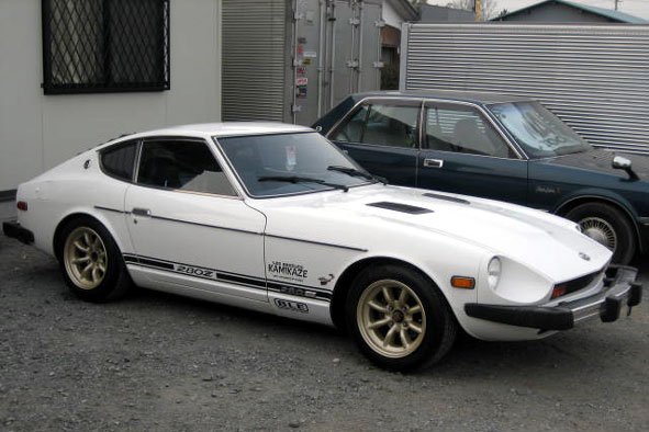

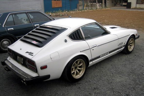

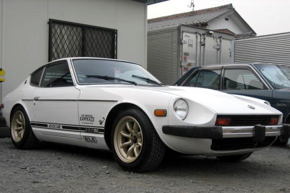

NZeder Posted August 8, 2009 Posted August 8, 2009 Boths the silver car and the orange above have the Type-R or R-Type rims. The other popular Watanabe rims sizing for the Zed is the F8 Type in 7.5 with the +8.5 offset sometime used with the 7 +15 on the fronts - here is a pic of zed with what looks like he F8 in 7 and 7.5 front/rear . .....hmm links did not work - so will attach Here is some more of the F8 this time 15 x 8 +3 on all 4 corners rapped in 195/60/15 You can see the different to the 8 Skope R-type (could not find a pic on a car without ZG overfenders so here is a pic of my rims which are R-type but also designed for flared guards. The orange car above has the R-Type) Quote
acf321 Posted August 8, 2009 Author Posted August 8, 2009 Thanks NZeder ... good photos there. Ok. I spoke to Alan last night and he suggested the wheels on the silver car (and I concur) are; Watanabe RS R-Type 15", with the front most likely being 8*15 (zero offset), and the rears being 9*15 (-13 offset). To me, the orange car might have 16's ... as the rear wheel arch is just all rim there, but it does look excellent. For what its worth, a smaller rims weighs much less, and tends to carry less weight in rubber also (especially on width). I personally think the 15" looks the best rim size, however requires the car to be lowered to just the right height so as to have the rim/tyre nicely fill out the arch. On this site, www.aerodyne.net, there are some very good pictures of Watanabe styles, and colours, as well as tables of all the available sizing. If you look at it, these 15" R-Types are only available in 2 offsets, so we are getting closer. Alan suggested its smarted to err on the side of conservatism also, so as not to have a problem of the tyres rubbing on the inside of the wheel arch lips or front valance. Also, the wheels that Aerodyne has listed for the 240Z include the following varieties; 1) R-Type, 2) F8, and 3) F8F, and 4) A/B Type. Also, the R-type and F8 are available in Aluminium, and magnesium (just in case you're feeling very rich). Another point, you can order your Wat's with 'machined' lip or with full colour across the whole rim. The colours (shown on Aerodyne) include; matt black, grey, silver, gold, blue, red, yellow, chrome, zinc, brown and one or two others. Gotta say, the Watanabes look SO damned good on a well sorted 240Z, its pretty hard to go past them. Now ... where is that A$2500 I left lying about ? Quote
