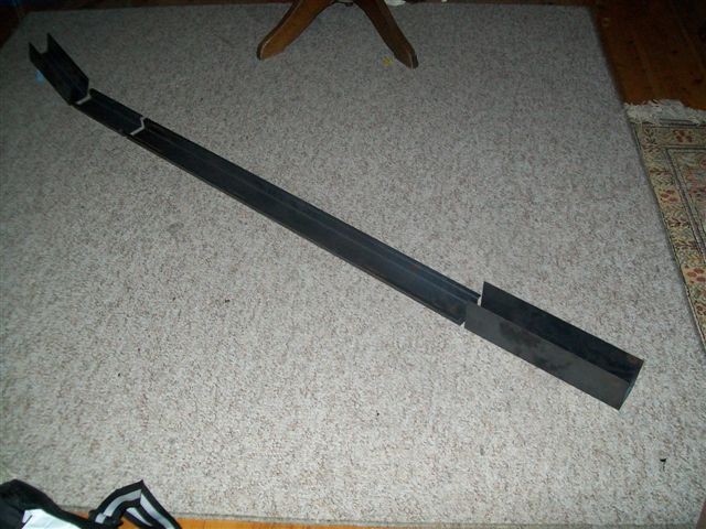

FLEXZED Posted September 23, 2011 Share Posted September 23, 2011 Hey Tim this is what i did, just to give you an example cost me $120 in steel Quote Link to comment Share on other sites More sharing options...

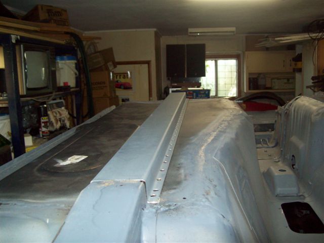

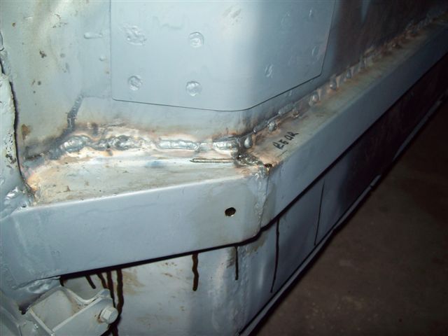

PeterAllen Posted September 23, 2011 Share Posted September 23, 2011 Tim - I had my full-length rails made up by a local sheet-metal place for $50. They are thicker gauge and deeper (30mm) than standard. I had them made in sections and welded them together insitu - it was much easier. As you may be aware with the LS1/t56 I included inserts in the rails to accommodate the t56 gearbox mount. In hindsight, at someone's suggestion, I'm now sorry I didn't also include this mod at the rear so that I could install another cross-brace (the gearbox mount being the other). I plan to do that next time it is on the rotisserie and knowing the tailshaft position. Quote Link to comment Share on other sites More sharing options...

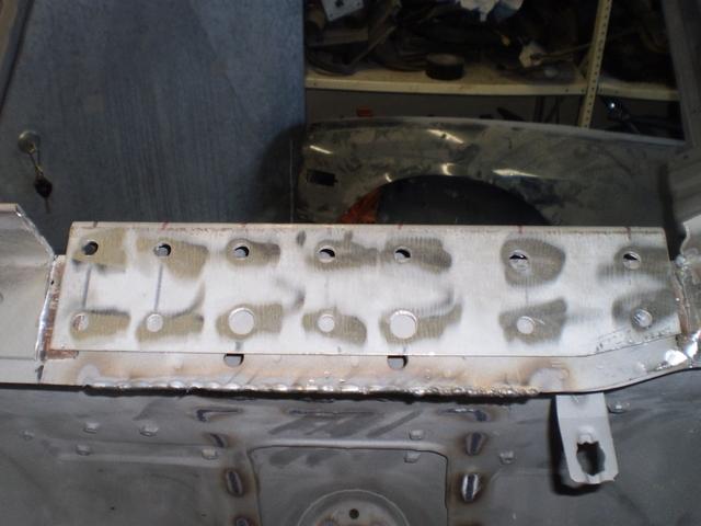

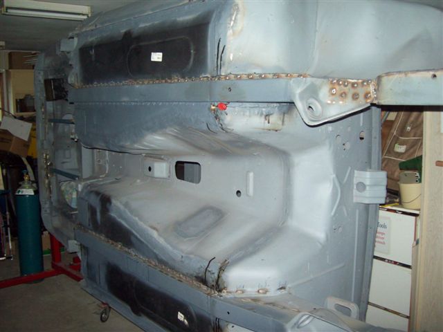

PeterAllen Posted September 23, 2011 Share Posted September 23, 2011 A few more photos Quote Link to comment Share on other sites More sharing options...
