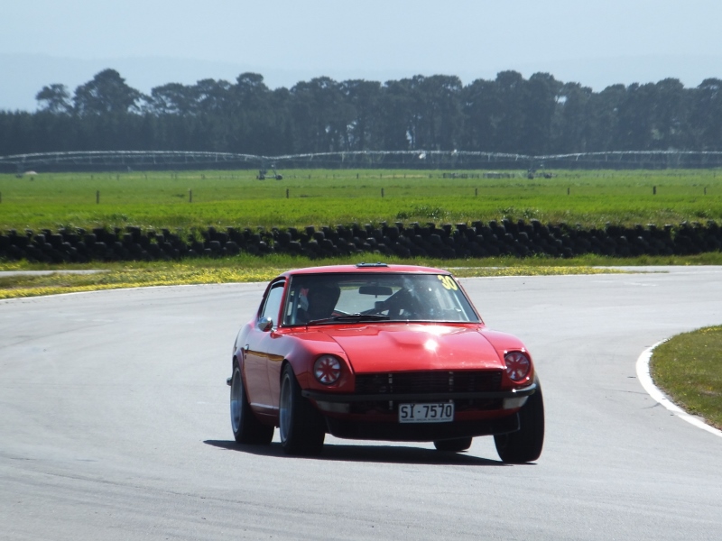

bluerat Posted October 27, 2013 Author Posted October 27, 2013 Hey everyone, 7 long months later and we have a goer! Quote
bluerat Posted October 27, 2013 Author Posted October 27, 2013 First event was the Baskerville Historics at the start of the month, then a lap Sprint at Symmons last weekend. Quote

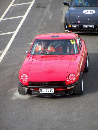

bluerat Posted November 1, 2013 Author Posted November 1, 2013 See pic below Mick, LOL Mad Matty has a Maloo he want's to run! Scando's is also coming along nicely, he should give you a run for your money as well!! Hey Gareth, The car came with some 'Drummond' built gravel spec Bilsteins, when I say Drummond built, I mean 1989, LOL. Unlike a lovely modern progressive, compliant, plush, tuneable DMS or Murray-flex shock, these bad boy's are stiff, but they will swallow a huge pot hole...if that's your thing? Hhmmmm video's yep, but they are pretty boring, mostly me being held up by various British car's at Baskerville and Mick disappearing into the distance at Symmons... Quote

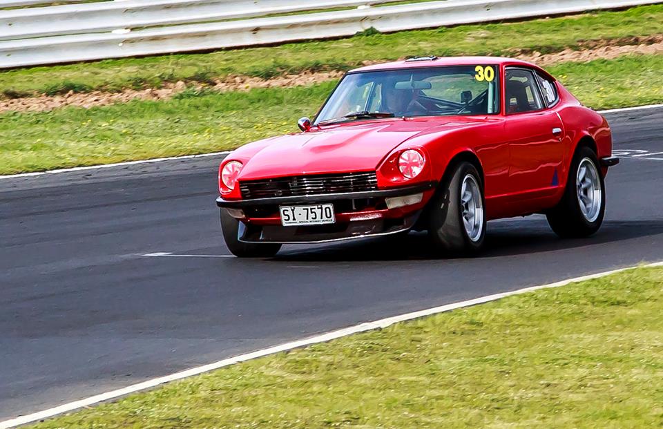

bluerat Posted November 16, 2013 Author Posted November 16, 2013 Some photos from yday's Kart track sprint. Quote
dat240z Posted November 17, 2013 Posted November 17, 2013 You should be proud mate, your car looks killer! I love that carbon front bar also!! Quote
bluerat Posted November 17, 2013 Author Posted November 17, 2013 Thanks Dat...sorry the bumpers are just grey FG! It was around 2 sec a run slower than the 1600, but on harder tyres and it understeers a bit, so a bit of sorting out there. Might try a rear sway bar first up. Brakes are big 4 spot Brembos with Project Mu pads and have been good, but not mind blowing, so next step is to try a smaller front master cyl on the peddle box. The fun begins..... First photo..What the first couple of drives felt like. Second photo..of course it's fake! Quote

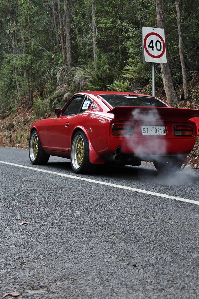

bluerat Posted March 6, 2014 Author Posted March 6, 2014 A few 'Pro shot's' from the Poatina mountain hillclimb a couple of weekends ago. Gotta say it is a magic road! 7.4 km, from wide open in 5th to 7 tight hairpins and everything in between. I'm still grinning like an idiot!!! The Bride sat in the silly seat and loved it...can't talk her into selling a horse yet. Quote
bluerat Posted March 6, 2014 Author Posted March 6, 2014 Oh and the smoke....tyre rubbing on the exhaust...boring I know! We still have some slow speed understeer to sort out, we are going to try some stiffer rear springs, plus another degree of camber on the front. The new Chinaman radiator is working well, we replaced the cap with a Triton jobbie and upped the catch bottle size to a litre and a half after it spitting water out at Highcleare. We ended up with a L series/SR20 gearbox hybrid and I was pretty happy with the ratio's..love the shifter after 20 odd years of L series box's!! Quote

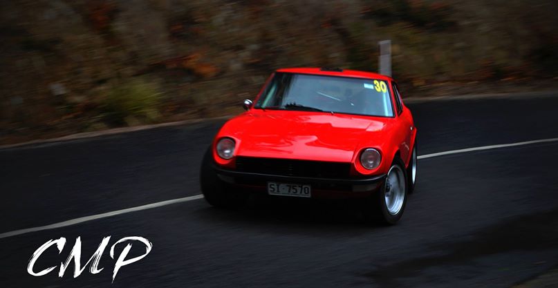

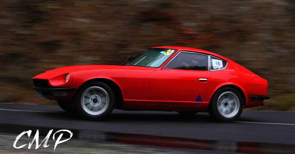

bluerat Posted March 30, 2014 Author Posted March 30, 2014 Barrington hillcimb Y'day, Mighty Mick cleaned up with a 1st in class E and 4th outright in VERY wet condition's! We snuck in with 7th o/r and 2nd in class by .05 of a second... It rained all afternoon so a bit of fun was had! Fitted Scando's rear bar which made a positive difference to the handling as well. So much for being a 'rare' car and hard to find....as many red Zed running yesterday as Common 'ol Commodore's!! Quote

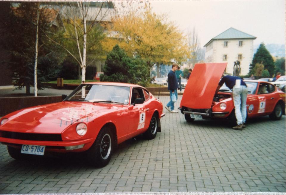

bluerat Posted March 31, 2014 Author Posted March 31, 2014 Cheer's Guy's, She's on like Donkey Kong down here Gordo!! Mick's has really stepped up to the plate this year and is having a real crack, driving the wheels off it. Hopefully he will post some in-car... Rear bar is 16mm Gareth, front is 20mm. I'll buy an adjustable rear bar when Shane want his back for the Hulk. I scored a set of rear arm's the same as yours from our friendly "Arms Dealer', they should be here this week. I'd like to try another degree of camber on the front as well. Kart track lap sprint is the next event, and will be a real test to see if it's handling better. The first photo is two of the above zeds circa 1990...mine is at the rear. Second photo...you can almost hear the LS! Quote
