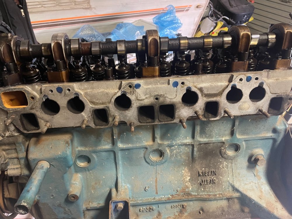

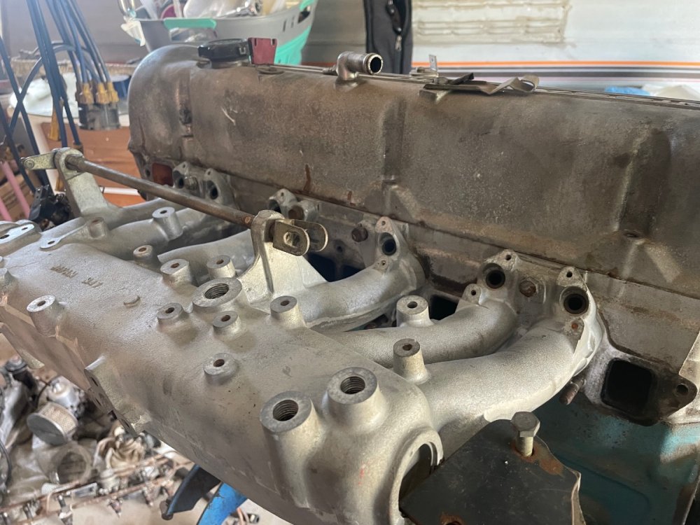

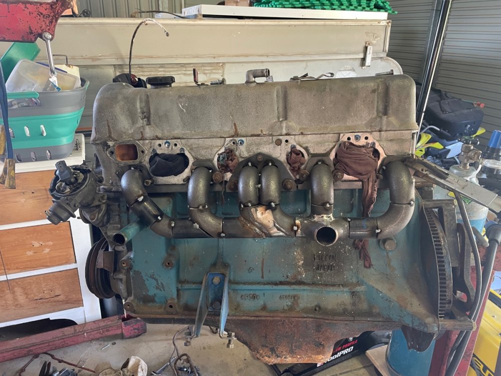

Stinkbug Posted March 26, 2023 Posted March 26, 2023 Thought I’d better start a proper thread about my engine build instead of carrying on in the general section. plan is to pull out the 4.4L and Supra box to fuel inject and turbocharge my L26. im slowly gathering the bits to do so. so far I have a l26, an e88 carby head and the efi intake. this weekend I redrilled the head to mount the efi manifold, and notched the ports for the injectors. Seemed a bit daunting but in reality it was pretty easy. I’ll be putting a micro squirt in to control the spark and the injectors, with ls2 coils and I have a turbo off a forester gt laying around. question, will the forester turbo be adequate? I plan on running around 10 psi. Also can I get some injector advice. will standard 280zx injectors be ample? Or will I be better off getting some higher flowing ones in anticipation of future upgrades should the need arise? If someone could chime in that would be great. Quote

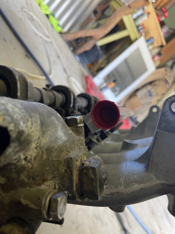

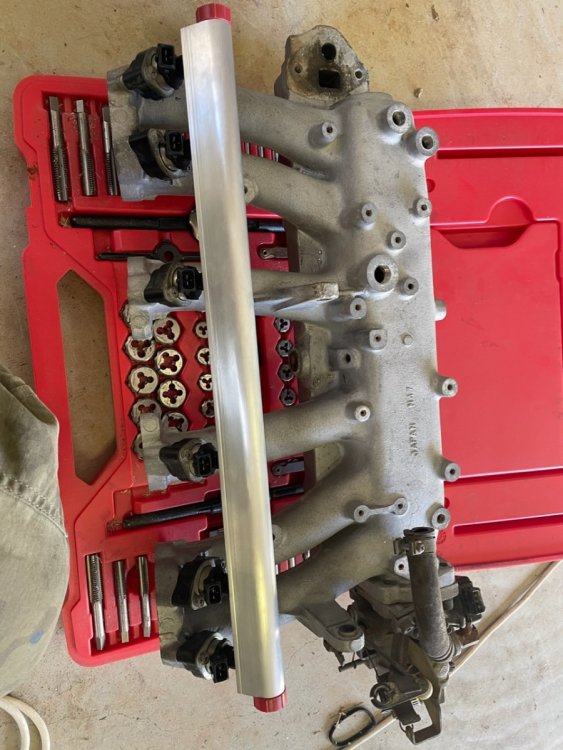

Stinkbug Posted April 25, 2023 Author Posted April 25, 2023 Got the fuel rail I bought from EfiHardware fitted up today along with the Ls1 injectors I bought a couple of weeks ago. Had to bore the injector holes to make em fit but it worked well. clears the thermostat housing too which I was a bit worried about. krizza 1 Quote

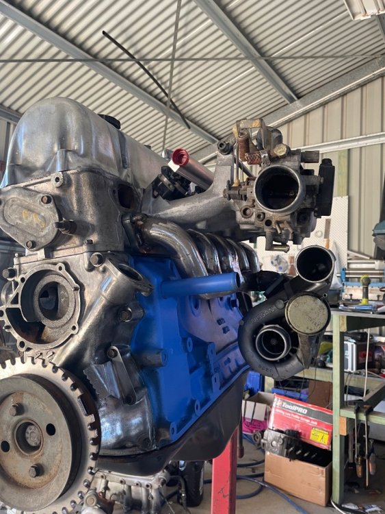

Stinkbug Posted May 3, 2023 Author Posted May 3, 2023 Got the turbo mounted up today. computer should be here next week then I need a bunch of hoses and pipes. v8 coming out next weekend so I can start fitting everything and wiring. OdinZ 1 Quote

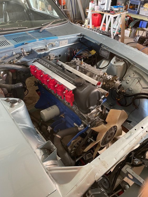

Stinkbug Posted May 21, 2023 Author Posted May 21, 2023 L series back where it belongs. not long now just have to sort clutch, fuel and Intercooler then wiring and hopefully it starts. pauly_adams, gav240z and C.A.R. 3 Quote
