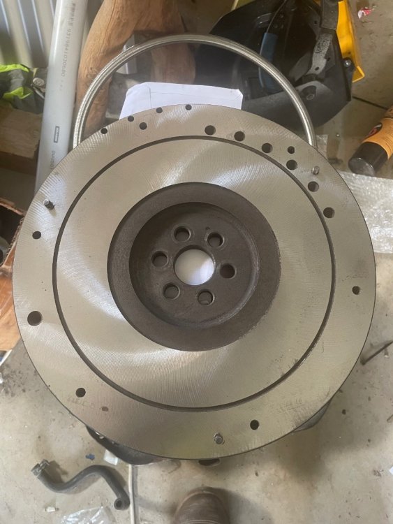

    It is a 240mm flywheel I just put in. Must be out of a l28et?

    Slowly chugging along. Started the wiring today. Only need to sort out a fuel return line and exhaust now. Got the clutch sorted out thanks to Mr. Wilkins. Ended up going with a 280zx flywheel and a VL clutch. Gotta say we are lucky we have guys like him around. Intercooler all in. Sure is a tight fit. need to sort out the pcv setup. If anyone can offer any pointers ittd be much appreciated

    Would a 280zx flywheel work? Or aren’t the 2+2 flywheels 240mm?

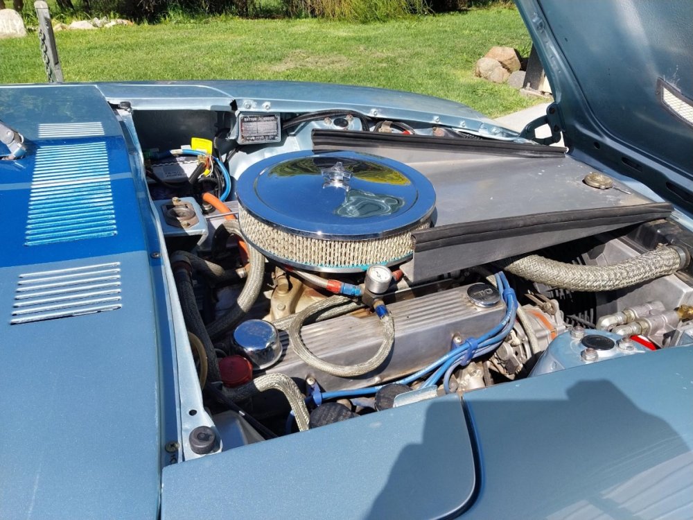

  21. I’m getting close to getting my new motor built so I thought I’d stick the sale up for my current engine while it’s still in the car. 4.4L alloy v8, Supra 5speed and tail shaft. complete conversion that will bolt up to standard z mounts. engine built by a professional workshop here in Tamworth. Extractors, cam, ported. Big Holley carby. looking for $5000 for the lot. The engine will be in car for a few more weeks so can take for test drive. pulls hard. Heaps of torque. Fun motor but I’m going to a l series turbo. pm if interested.
