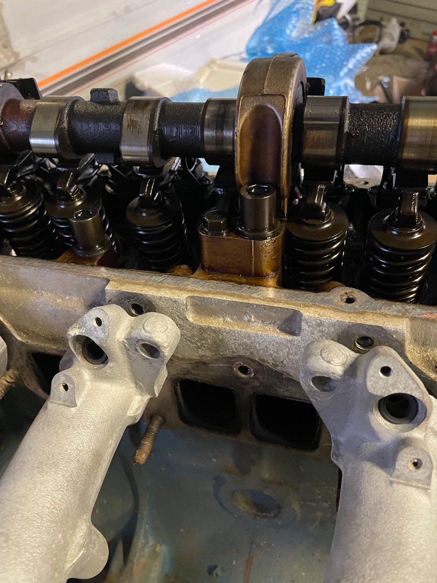

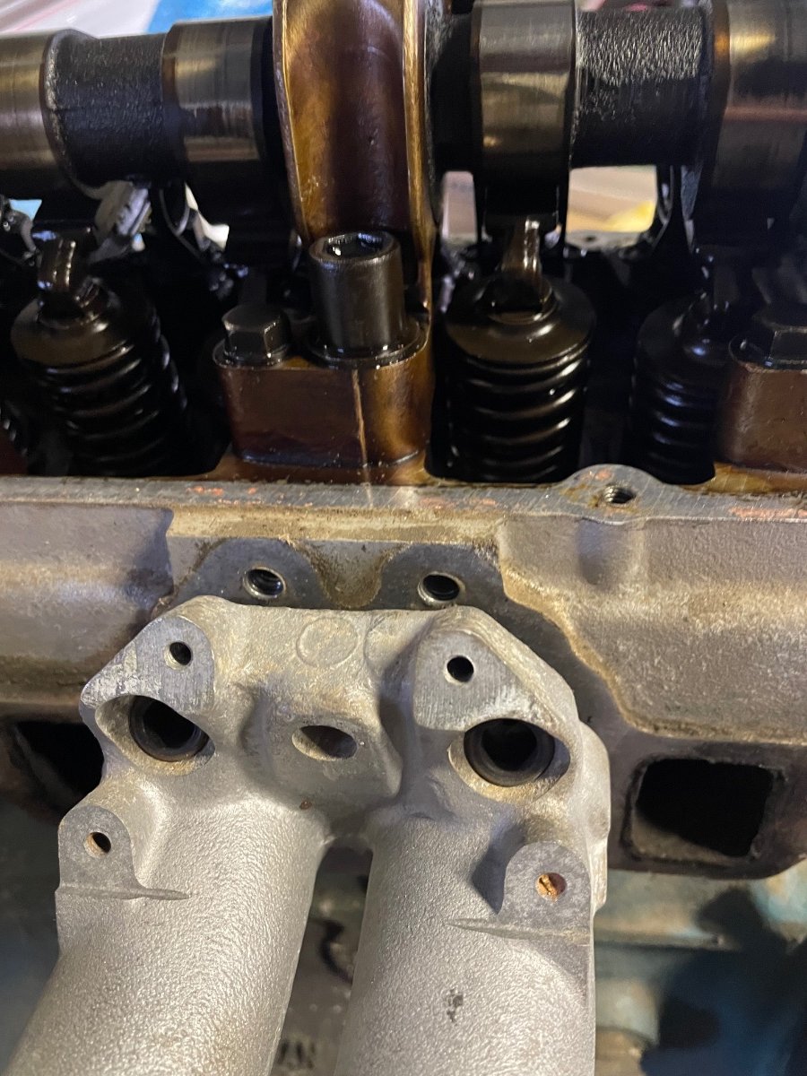

Thought I’d better start a proper thread about my engine build instead of carrying on in the general section. plan is to pull out the 4.4L and Supra box to fuel inject and turbocharge my L26. im slowly gathering the bits to do so. so far I have a l26, an e88 carby head and the efi intake. this weekend I redrilled the head to mount the efi manifold, and notched the ports for the injectors. Seemed a bit daunting but in reality it was pretty easy. I’ll be putting a micro squirt in to control the spark and the injectors, with ls2 coils and I have a turbo off a forester gt laying around. question, will the forester turbo be adequate? I plan on running around 10 psi. Also can I get some injector advice. will standard 280zx injectors be ample? Or will I be better off getting some higher flowing ones in anticipation of future upgrades should the need arise? If someone could chime in that would be great.

Hi guys. mom embarking on converting my l26 to efi. I’m going to pull the 4.4l v8 out and replace it with a fuel injected turbo l26. I have the efi manifold and before I spend money on a e88 head with the injector notches I thought I’d ask if it was possible to notch the head for the injectors? Another roadblock is that the current head has the wrong spacing on the top row of bolts to attach the manifold to the head. now, can I redrill and tap the head to suit the manifold bolt holes? I have 2 e88 heads and they are slightly different by the head on the motor seems to have more meat behind where the bolt holes are. pics attached

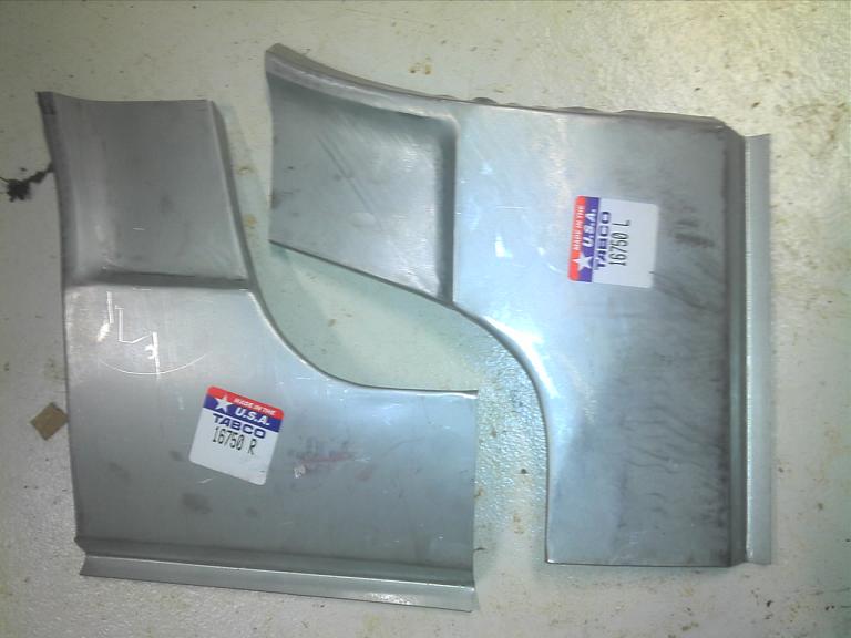

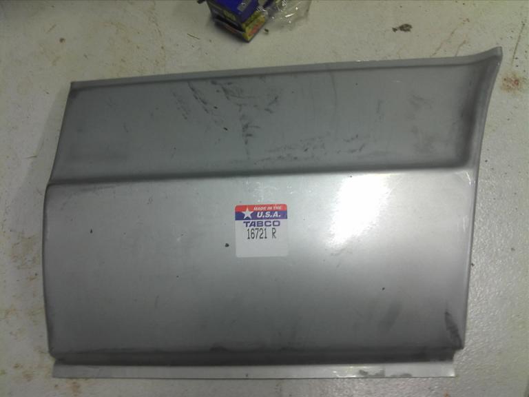

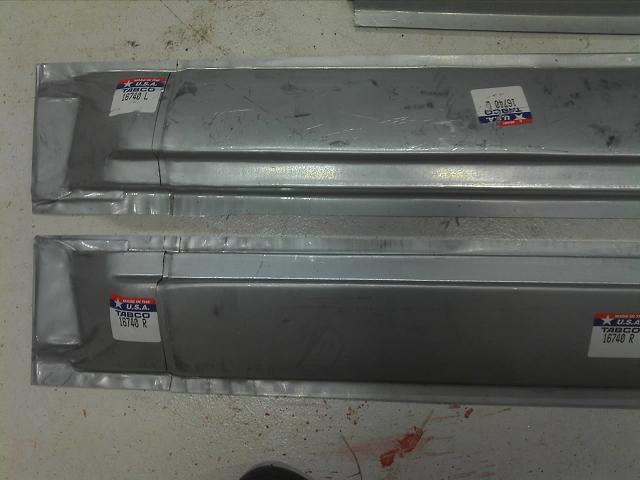

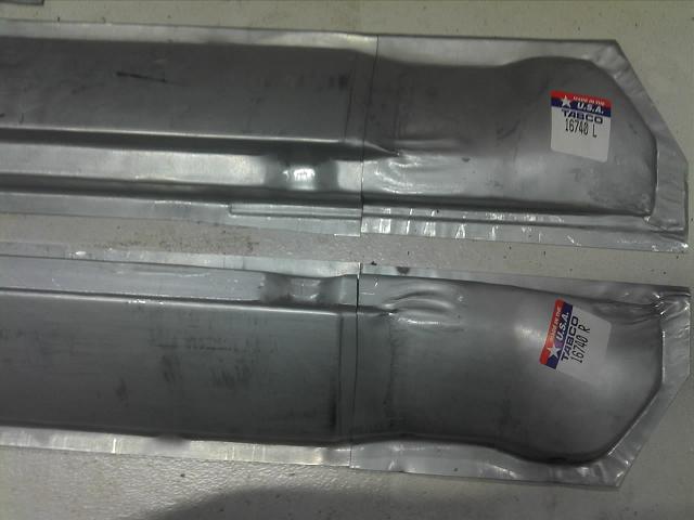

ok guys, so the sill panels and quarter panel patches rocked up today from Tabco. first impressions are quite good, look to fit up well with all the right bits in all the right spots. very happy so far to take this route. ill post up some pics tonight if anyone is interested.

Tabco price list if anyone is interested. 16721 L-R 54.5 Front Fender Lower Rear Section 14H 16730 L-R 44.95 Doorskin 8H 16740 L-R 89.75 Rocker Panel O.E. Type 51Lx6H 16750 L-R 47.95 Rear Quarter Lower Front Section 10Lx13H 16751 L-R 89.75 Rear Wheel Arch With Lower Front Quarter Section 44Lx24H 16752 L-R 49.75 Rear Quarter Lower Rear Section 21Lx10H 16753 L-R 129.95 Outer Rear Wheelhouse 33Lx23W 16761 U 124.75 Rear Panel, Upper Top 41Lx4W
i jst got a quote for around 500 for 2 full length sills, 2 bottom front quarter patches, and 2 lower front rear quarter patches. it was around 130 bucks for shipping. he said they can bandsaw the sills in half to make em shorter for cheaper postage.

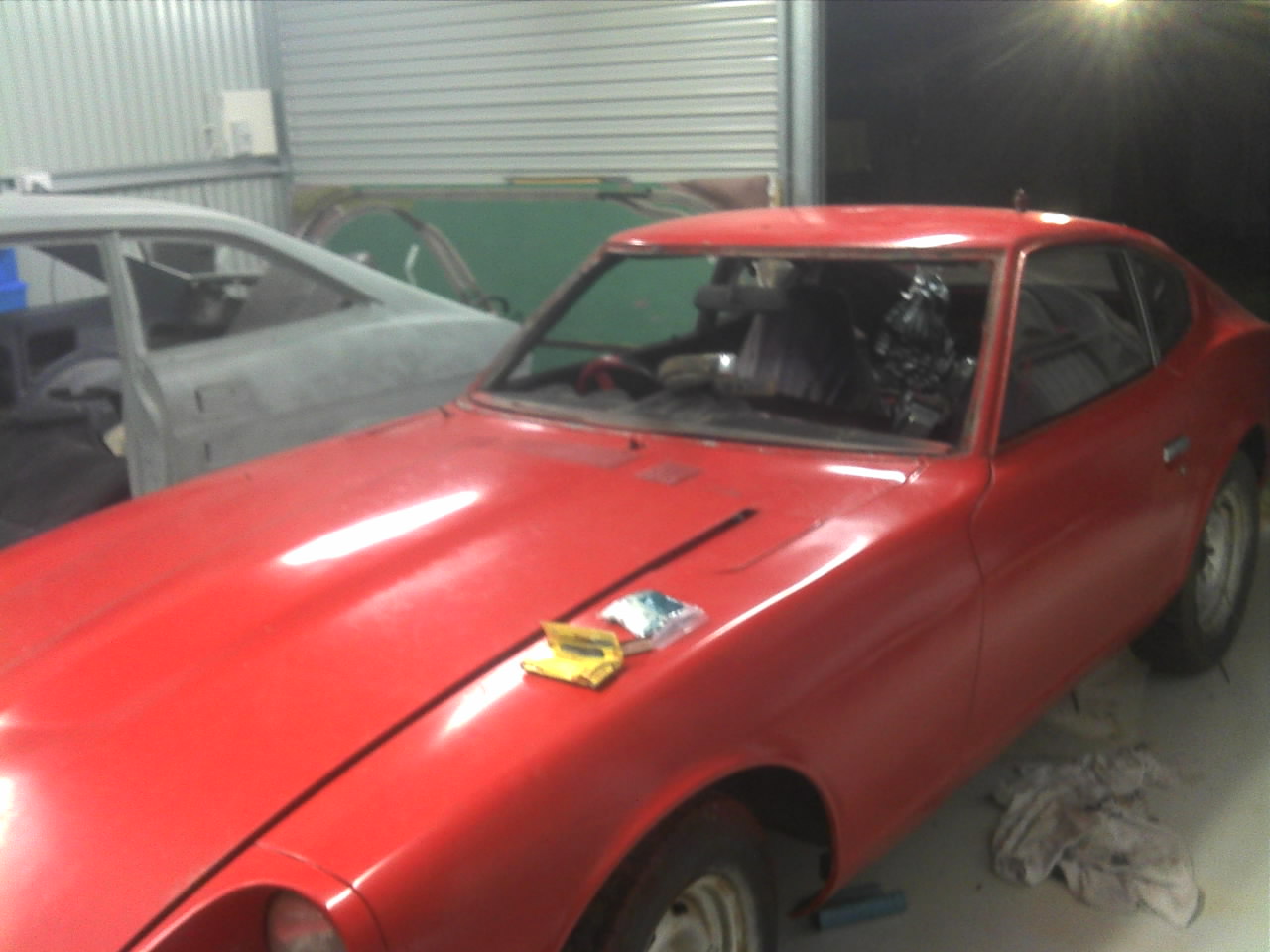

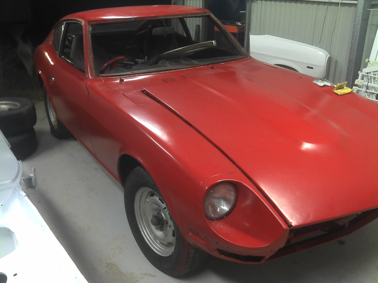

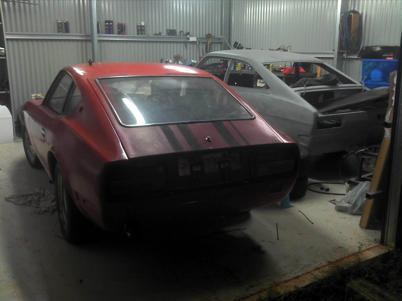

just rolled the zed into the garage!! havent felt this good in ages. bit cramped in there now with the 1200 but i can live with that. first things first, it will be stripped and taken back to bare metal to see what lurks beneath. looks pretty good though, with a tiny bit of rust bubbling through. im sure the rear panel above the taillights might be stuffed too. needless to say, im so stoked. everyone, meet my '71 240z #1404
