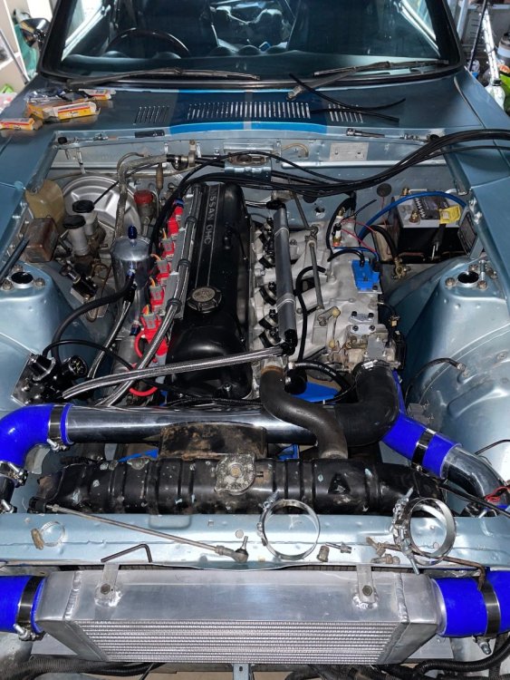

Stinkbug Posted June 13, 2023 Author Posted June 13, 2023 Slowly chugging along. Started the wiring today. Only need to sort out a fuel return line and exhaust now. Got the clutch sorted out thanks to Mr. Wilkins. Ended up going with a 280zx flywheel and a VL clutch. Gotta say we are lucky we have guys like him around. Intercooler all in. Sure is a tight fit. need to sort out the pcv setup. If anyone can offer any pointers ittd be much appreciated OdinZ, gav240z and C.A.R. 3 Quote
pauly_adams Posted June 16, 2023 Posted June 16, 2023 if the VL clutch doesn't hold, send me a Pm i do have a spare 240mm flywheel and either of those 2 clutches would have worked with a 240mm the HDB (Heavy duty button) would hold more torque but not as nice to drive daily. Quote
Stinkbug Posted June 17, 2023 Author Posted June 17, 2023 It is a 240mm flywheel I just put in. Must be out of a l28et? Quote

Stinkbug Posted July 2, 2023 Author Posted July 2, 2023 I’m about 95% of the way now. made an exhaust today and got my wideband fitted in while I was under there. tomorrow if I don’t have work I’ll wire it all in and get that bit tidied up. getting so close now to taking it for a test drive. C.A.R., gav240z and OdinZ 3 Quote
Stinkbug Posted August 3, 2023 Author Posted August 3, 2023 (edited) Happy to report after chasing a terrible knocking noise that turned out to be a worn rocker my zed is now ready to roll. been on a couple of drives around the block which is 4km and somewhat resembling mt panorama I can say it goes great. Heaps of power, pretty much the same go as the v8. thanks to all who offered advice along the way. Much appreciated. Also a big shout out to Stewart Wilkins who never failed to get me bits overnight and for the help he gave me. Top guy. Edited August 3, 2023 by Stinkbug OdinZ, AndBir and gav240z 3 Quote
