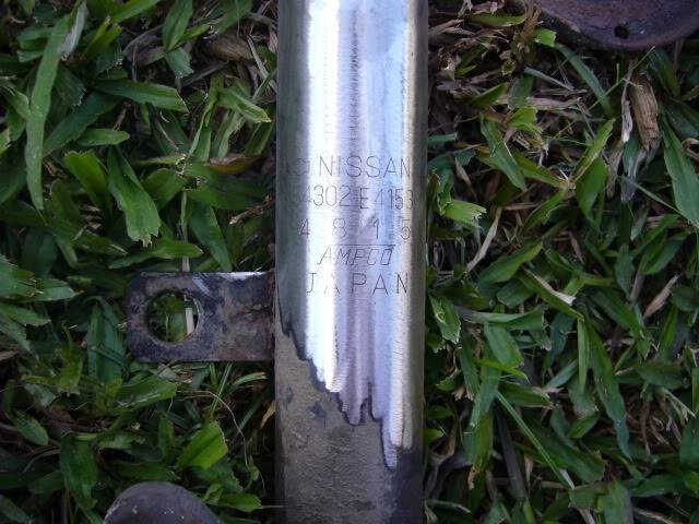

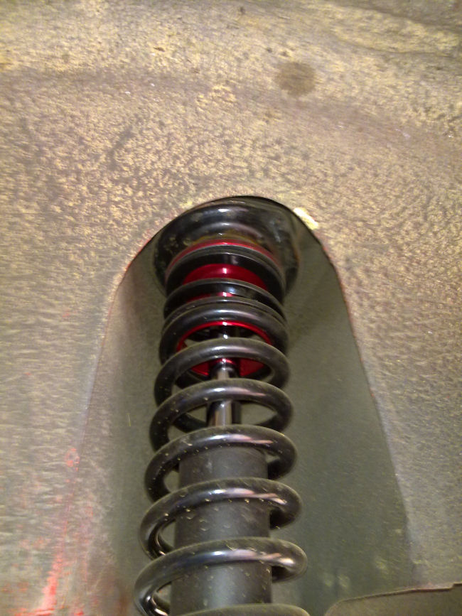

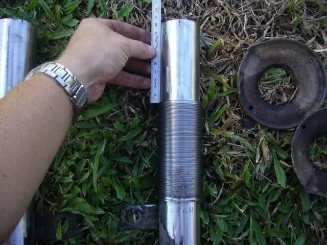

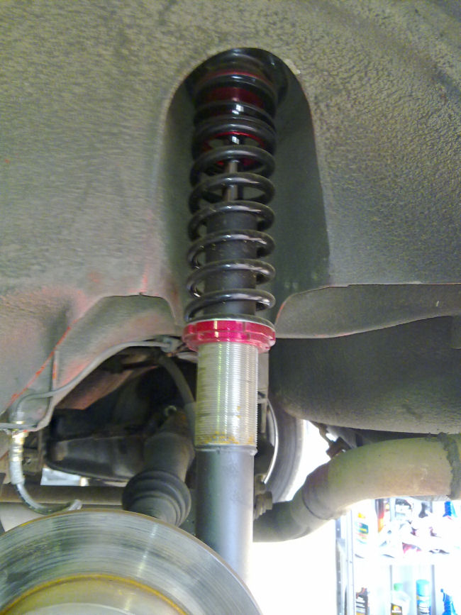

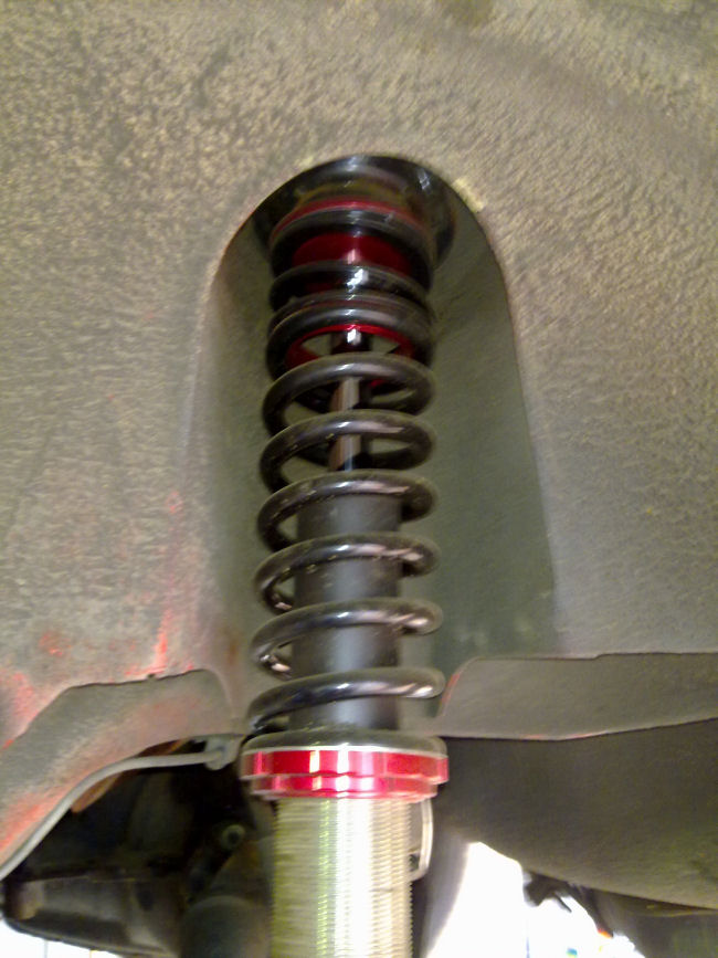

C.A.R. Posted October 17, 2009 Posted October 17, 2009 I've currently got an eye infarksion, so it's rather painfull to go outside into the sunshine... SO I hope you guys appreciate these. The things I do for this community... (I can Email higher res. pics to those interested). 51mm dia. strut tubes. CO spring top hat needs to be bored out to the dia. of the damper piston/shaft, so it it a neat sliding fit. Front: from the top of the strut TUBE to the top of the threaded sleeve is 100mm. Rear: from the top of the strut TUBE to the top of the threaded sleeve is 110mm. If you doing this in the car a 2" exhaust clamp can be used to support the bottom of the sleeve. The cars full weight can then be lowered onto the suspension & adjustment of the threaded sleeve & ride height can be made. NOTE!: I DID NOT section the strut tubes. Rear suspension pics: Quote

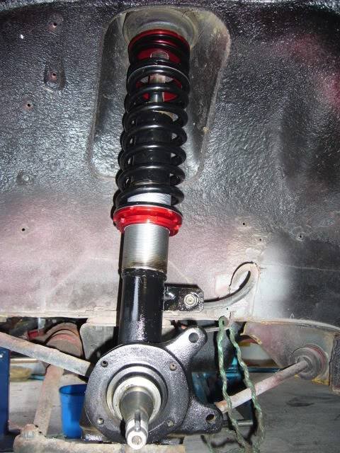

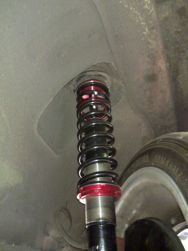

C.A.R. Posted October 17, 2009 Posted October 17, 2009 Front suspension & ride height. The rear of Sulio's Zed can be lowered another 120mm(!) The front another 60mm (approx). Quote

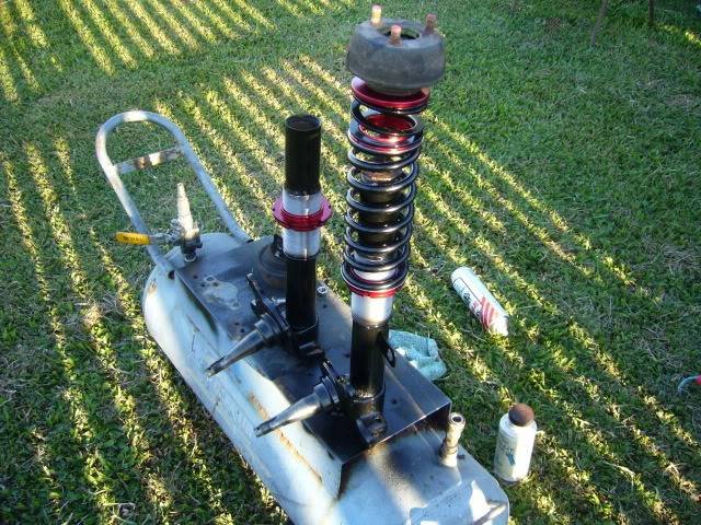

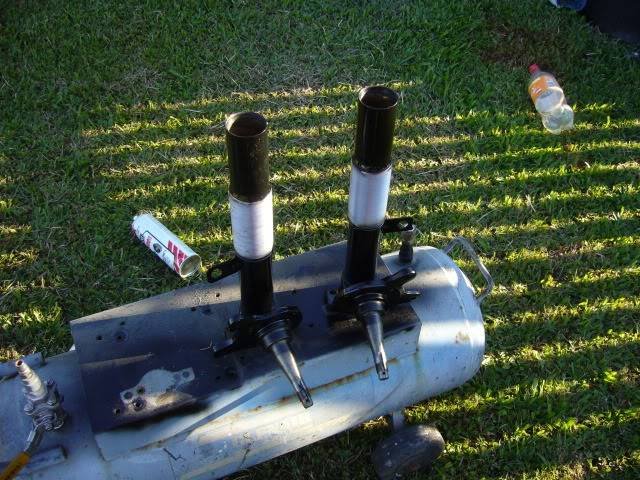

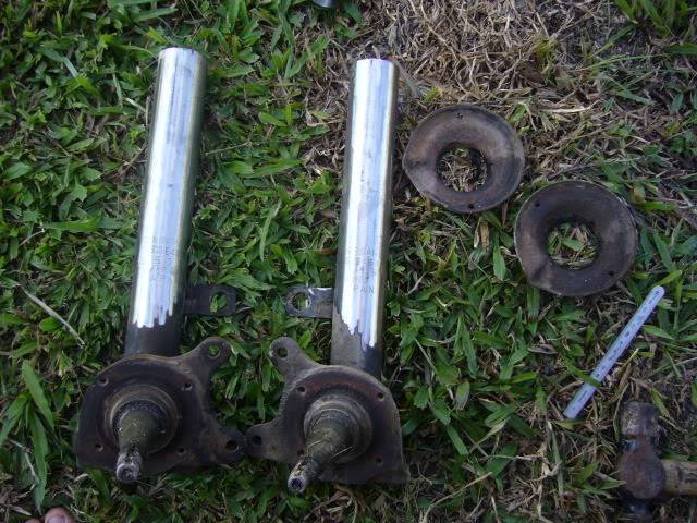

RB30X Posted April 13, 2010 Posted April 13, 2010 Guys this is so easy, you should all get some. You've seen the final results, but I have included some pics of the inbetween process in case you were wondering. Quote
BenZed Posted April 13, 2010 Author Posted April 13, 2010 Great pics, thanks a lot for posting them up (saves me a lot of explaining) Quote
