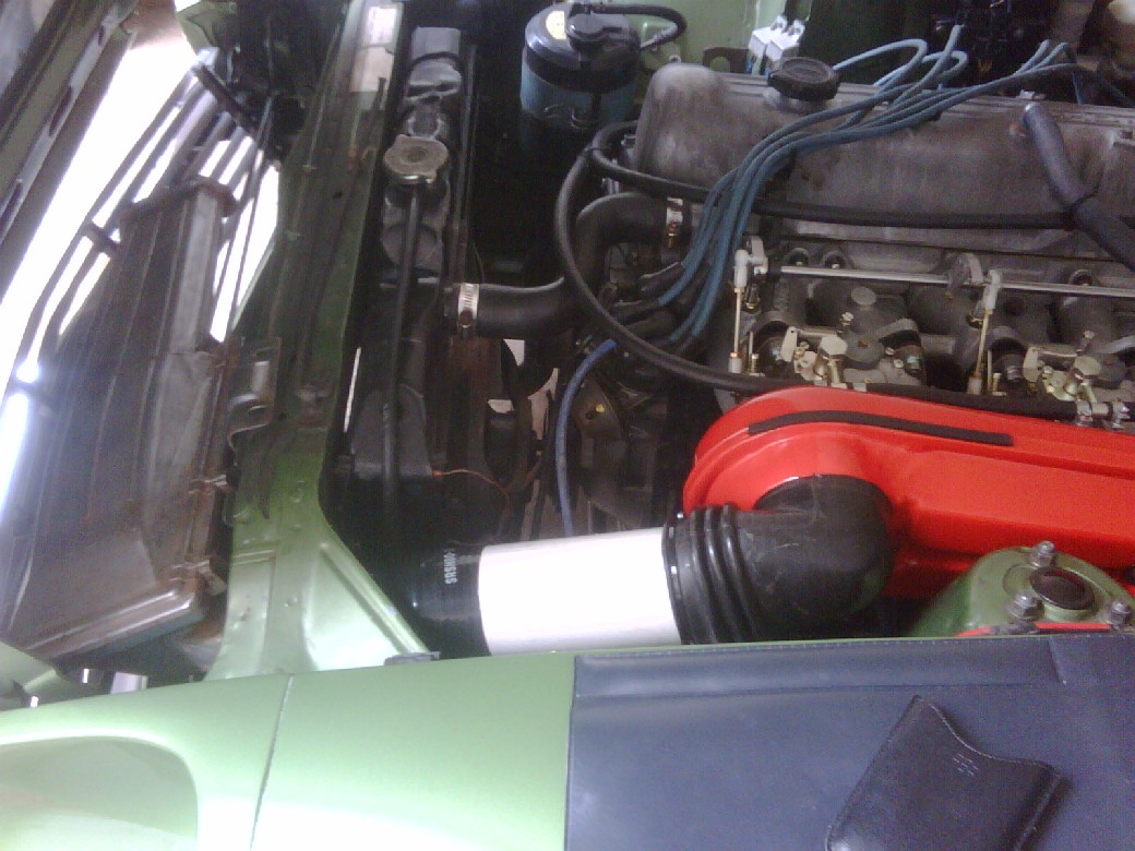

kalium Posted February 28, 2009 Posted February 28, 2009 My EFI L28 in my 260 is still lacking an air filter. I've got a pipe made up for a pod filter (yet to buy the pod filter...), but I'm worried about getting defected/fined here in QLD. Should I just source a standard 280zx airbox and is it easy enough to bolt onto a 260 ? Cheers Ray Quote
Moderators Zedman240® Posted February 28, 2009 Moderators Posted February 28, 2009 A good person to ask is Allan (260coupe). He's done what you're thinking of doing. Look through his photo album for a pic of the engine bay. Quote

kalium Posted June 17, 2009 Author Posted June 17, 2009 In case anyone was interested, I visited the wrecker and pulled out an old commodore airbox and then paid a trip to autobarn and got some of that overpriced flexible air duct hose. I pretty much cut the whole inlet half of the airbox off (so the whole filter element is exposed), and mounted it down the bottom in front of the radiator. Then used that flexi air duct hose to hook it up to the AFM. Not sure how efficent the whole system isor isn't, but it certainly does the job, and the whole setup cost me about $40 ! Quote
