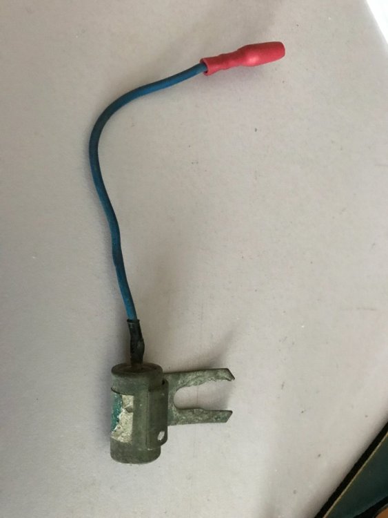

peter t Posted August 23, 2022 Posted August 23, 2022 On 8/12/2022 at 5:00 PM, JW240 said: Thank you for your response, exactly what i like to hear. I had a few issues with the Tacho but have resolved them. Was mainly due to a faulty resistor at the coil. Disconnected the resistor and problem solved. Also had my Tacho upgraded to modern times by Lionel Otto Instruments here in Brisbane. Quote

peter t Posted August 24, 2022 Posted August 24, 2022 4 hours ago, JW240 said: Great to hear, im a little worried about the tacho not working, especially on a freshly rebuilt engine. Was it the ballast resistor that got removed? It was a faulty noise resistor they fit so ignition noise doesn't go through your radio, I think the ballast is still used. will check tomorrow. The instrument Doc put a new heart in the tacho to bring it up to modern standards and is triggered by the - terminal on the coil. The other old tacho now works also after deleting the faulty noise resistor. Dont listen to the radio anyway. LOL. Quote

peter t Posted August 25, 2022 Posted August 25, 2022 11 hours ago, JW240 said: It would be great if you could, they only resistor i can picture is the condenser on the factory distributors? Ballast is not used anymore. Pic is the faulty bit plugged into neg side of coil that was causing the tacho to fault. JW240 1 Quote
AndBir Posted August 25, 2022 Posted August 25, 2022 5 hours ago, peter t said: the faulty bit plugged into neg side of coil that was causing the tacho to fault. a noise suppressor condenser (coil) to stop engine noise in your Radio and all Car Audio peter t 1 Quote
JW240 Posted August 25, 2022 Author Posted August 25, 2022 5 hours ago, peter t said: Ballast is not used anymore. Pic is the faulty bit plugged into neg side of coil that was causing the tacho to fault. Ah of course, totally forgot about this. Hopefully mine will work just fine as its been dispatched today. Quote
