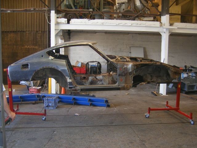

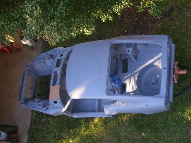

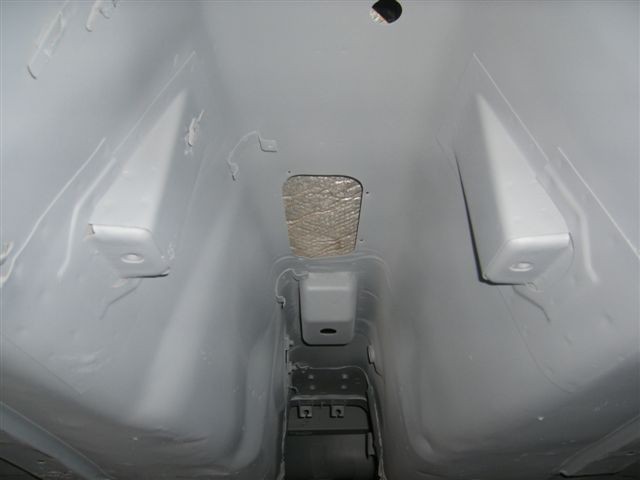

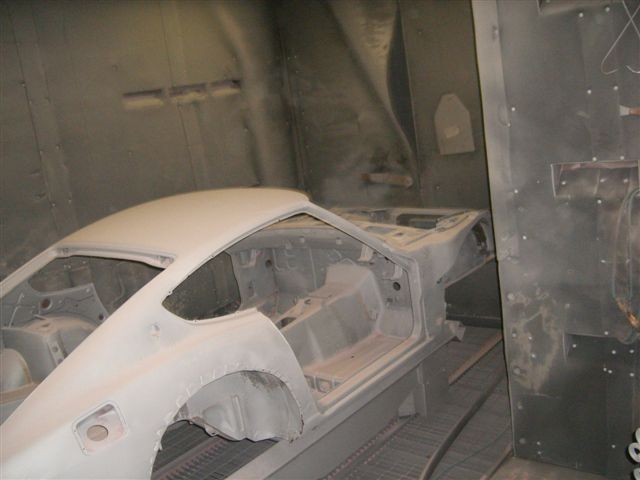

PeterAllen Posted January 18, 2009 Posted January 18, 2009 I had mine done 12 months ago. I had quotations from $1000 for sand blasting to $2500 for plastic bead blasting. The reported big concern with sand blasting is that an inexperienced operator can overheat the panel and cause it to stress relieve and warp. When you strip the shell you find there are not too many large panels anyway, i.e. no door skins or front mudguards (fenders). My decisions was to go to a place that was known and recommended by guys who had already restored cars. You also need to consider having an etch primer or the like applied straight away. I was going to have mine soda blasted but they could not apply a primer. The hassle of taking it to another place for priming with the risk of rain, or acidic hands being rubbed over it, made me choose a one-stop place. I went for the $1000 sand blast and prime, and I couldn't be happier. Rust damage in the usual places - poorly repaired previously. Must have removed 10kg of bog! (edit - Ignore the title of the second photo - it is a photo after blasting but before I removed the gearbox mounts) Quote
XRQTR Posted January 18, 2009 Author Posted January 18, 2009 Yep well that's what I'm talking about is blasting as well as priming, you really don't want to take a chance once you have stripped the tin of all it's protection, it's a recipe for disaster as quite often from the time you strip to the time you finish can be many months so it makes sense to protect the tin as much as possible. I know of some places that are charging over $1000 just to blast then etching is extra, this is for car bodies of course not chassis sections, at this point we are looking at setting an hourly rate as some jobs are easier than others. When you have things like filler and multiple layers of paint a job might take longer than anticipated so an hourly rate would be the fairest way for both the customers as well as ourselves, the last thing we want is to rip off people but we need to make sure it remains profitable enough to stay in business. We will as I said in my first post also offer a full panel resto, rust repair and paint service so the car is in the one place from start to finish thereby decresing further any chance of contamination of the shell should someone choose to go down that path. I know alot of guys want to do some of the work themselves and we are looking into potentially allowing this to hapen at the shop, it really is just a matter of working out how to charge for something like this for it to be feasible. Quote
