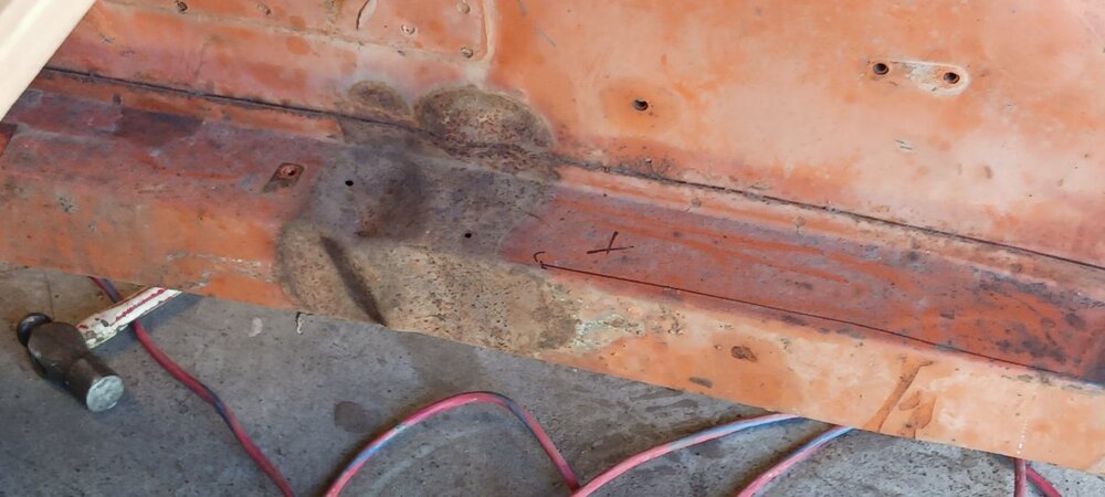

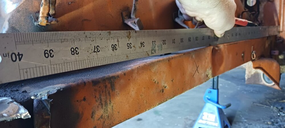

  2. A few photos of bent rails
  3. Hi, yes, it's taken a hit to the front. Bent chassis rails in the engine bay. They will be removed and replaced. Panel gaps were fine. What has me confused is that the towers, top to top, are LONGER, than the dimensions in the diagram. If anything it should be shorter. The car is properly bent/twisted, hence the chassis frame I'm making. Plan is to bolt the car up to it, then bold the frame to the floor with jack screws. Then all said and done torqe it down with jack screws to get the twist out of it. My question is, I guess, am I looking at the right diagram? Am ai missing something? If the diagrams are right, then I'll build the mounts to those numbers and then bend/force/twist it on.
