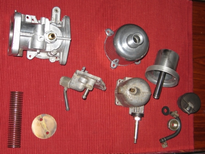

2+2er Posted April 29, 2009 Posted April 29, 2009 I just got hold of a repair kit for $50 from: http://cgi.ebay.com/ebaymotors/Datsun-240Z-Carburetor-Repair-Kit-1969-8-71-39-5063_W0QQcmdZViewItemQQcategoryZ6763QQihZ009QQitemZ190300207064 The needles are N47 and M49, it suite the 71 240z round top carbs. I have never pulled an SU apart but started to on sunday and found they where very easy to dismantle, clean, change out parts and reassemble. I completed one on sunday and am part way through the second. i found in one of the float chambers that someone had replaced the float locking pin with a nail Your flooding problem will almost certainly be due to an incorrect float level. The video idea is great. I will try and get some footage while I have the second one apart. Quote

stevo_gj Posted June 5, 2009 Author Posted June 5, 2009 Well I'm just about good to go. The only question I have is whether to use the 240 or 260 inlet manifold. The Z therapy video Shaun bought states that the 260 has markedly improved airflow, but it looks uglier with all the emissions crap sticking out of it. Hmmm... The work I did on the carbs tonight included: Setting both the mixture and idle screws to their correct settings before adjusting after fitment. Shortened one needle to be the same length as the other. Adjusted both floats to be the 5mm distance from top. (they were really far out) Adjusted both choke linkage to open both butterfly valves the same tiny amount. (the butterfly valves weren't opening at all) Two days ago I would have read the above list and had no idea what any of it meant. These Ztherapy videos are pretty bloody good. I'm tempted to make a couple of my own during the fitment and tuning process. Oh and no I don't have extractors Lynton I'll let you guys know how everything goes tomorrow Quote
Administrators gav240z Posted June 5, 2009 Administrators Posted June 5, 2009 Well I'm just about good to go. The only question I have is whether to use the 240 or 260 inlet manifold. The Z therapy video Shaun bought states that the 260 has markedly improved airflow, but it looks uglier with all the emissions crap sticking out of it. Hmmm... The work I did on the carbs tonight included: Setting both the mixture and idle screws to their correct settings before adjusting after fitment. Shortened one needle to be the same length as the other. Adjusted both floats to be the 5mm distance from top. (they were really far out) Adjusted both choke linkage to open both butterfly valves the same tiny amount. (the butterfly valves weren't opening at all) Two days ago I would have read the above list and had no idea what any of it meant. These Ztherapy videos are pretty bloody good. I'm tempted to make a couple of my own during the fitment and tuning process. Oh and no I don't have extractors Lynton I'll let you guys know how everything goes tomorrow I'd stick with the 240z intake manifold. What's important is port matching more than the manifold. I can't see any major difference between the 240z / 260z intake manifolds other than the number N63 / E88 from memory. They might have slightly wider diammeter. Measure the openings on both ends and see how big they are? If the 260z manifold is larger it 'should' flow better, but the only way to know for certain (Dyno!). Quote
