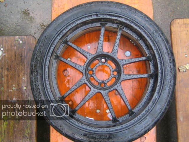

Hammer Posted December 30, 2008 Posted December 30, 2008 Hi guys I was very interested on the Rota RBs as they just looked good and good value. But after doing a bit more research on the net, I'm not so sure now. They don't seem to have a very good reputation among the car enthusiast community. The general concensus suggest to stay away from them. And looking at other forums, there seems to be a lot of hard luck stories of Rota wheels breaking apart etc. to back their suggestion. Has anyone had any bad experience with the Rota RBs? I'm keen to know, as I really like them. Below are just some of the pix that shows Rota wheels exploding... Before: The original wheel has straight spokes After: Now they are bent by the engine power into the driving direction The wheel hit the brake callipers at the marked points: Quote
datsfreak Posted December 30, 2008 Posted December 30, 2008 After: Now they are bent by the engine power into the driving direction Engine power or braking force? Looks nasty either way. I had a set of "racing fear" wheels made by speedy that, when i went over a moderate pothole it shattered all the spokes on BOTH wheels on that side of the car. Looked like the top pic here but it was both on the passager side. I wasnt even going very fast. Alloy wheels can be very brittle - esp when using very low profile tyres that have little cushion. Quote
NZeder Posted December 30, 2008 Posted December 30, 2008 I don't think the RB or the RB-R will have these issues. I say this as the design of the RB/RB-R is one that has more alloy in them, two they have more spokes, three are a lot heavier than rims shown in the pics. Remember the superlite look/style was designed in the 60's and these for years (and still today) are the choice of rim for rallies of all kinds. I have seen a few rims centre ripped out here at our tracks in NZ most are these skinny type spoke design which the RB/RB-R are not. Quote
BenZed Posted January 15, 2009 Author Posted January 15, 2009 We have had no issues with any of the Rota wheels we have sold in the last three years. I think these 'exploded' wheels are the result of damage to the back of the spokes, rather than weakness in the wheel itself. There is usually more to the story than the owner cares to admit in these cases. On a lighter note, we have all of the RB sizes in stock again Quote

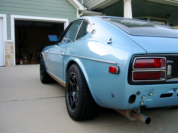

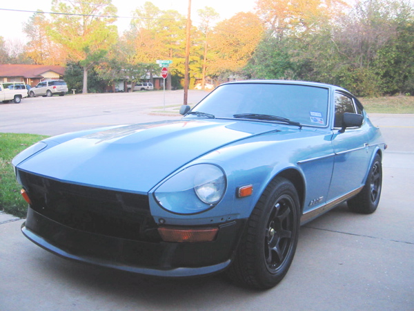

stevo_gj Posted January 15, 2009 Posted January 15, 2009 My mining paycheck must be burning a hole in my pocket but... Will the 16x8s fit under stock (unrolled) guards? Quote
Mr240z Posted January 15, 2009 Posted January 15, 2009 Stevo, I asked ben that question a while back 16x7 on the fronts 195/55 or 205/55 16x8 on the rears 225/50 Theres some pictures on here or HybirdZ with some zeds with them on Hope that helps Pauly Found some on HybirdZ Quote
